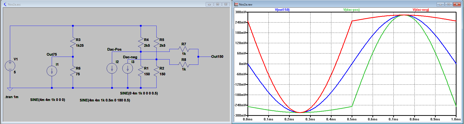

This is a -6 dB signal. It clips at 0dB.
With 0dB, the signals on both Dac outputs should look like in the image below.
There you can very well see how precise the tuning has to be done.
Hans

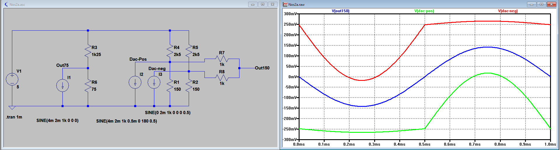

In my Sim with no signal applied, one side is 250mv and the other side -250mV.I am still quite puzzled by the way this circuit works. To make it easier to adjust the bias resistors . I first tried to adjust each dac, with the data in disconnected, to 0 V dc, with no connection to the other dac, but that was way off.
If I now measure the DC at the outputs, after the adjustments, and with the two 1 KOhms between the two dac's, the positive dac is @ - 157 mV and the negative is @ +161 mV.
I would , initially , have thought, that both should be @ 0 VDC....
What does the simulation say about this?
So I guess your resistors have a lower value.
since you tested at -6dB, this is how the signals from both Dac's and at the summed output should look at -6dB and just for completeness.

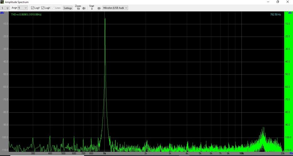

I tried what I suggested earlier:
100 Ohm I/V resistor from each dac to ground. A 20 Ohm multiturn trimmer between the two dac output where the wiper is connected to a bias trimmer pot to +6,3V. And the output from the same wiper.
The pic shows a spectrum from a 98% FS signal after trimming bias and the 20 Ohm trimmer. If I raise the input to 99 or 100 % some strange sidebands comes up. Only about -80 dB but it dosent look as clean as this pic. These sidebands are not related harmonic to the main signal

I’m completely surprised, because in my sim there was no level difference between both sides. I only tried a few changes in gain, but with no effect.
But you have proven that the distortion effect of the time shift can be cancelled by trimming the gain.

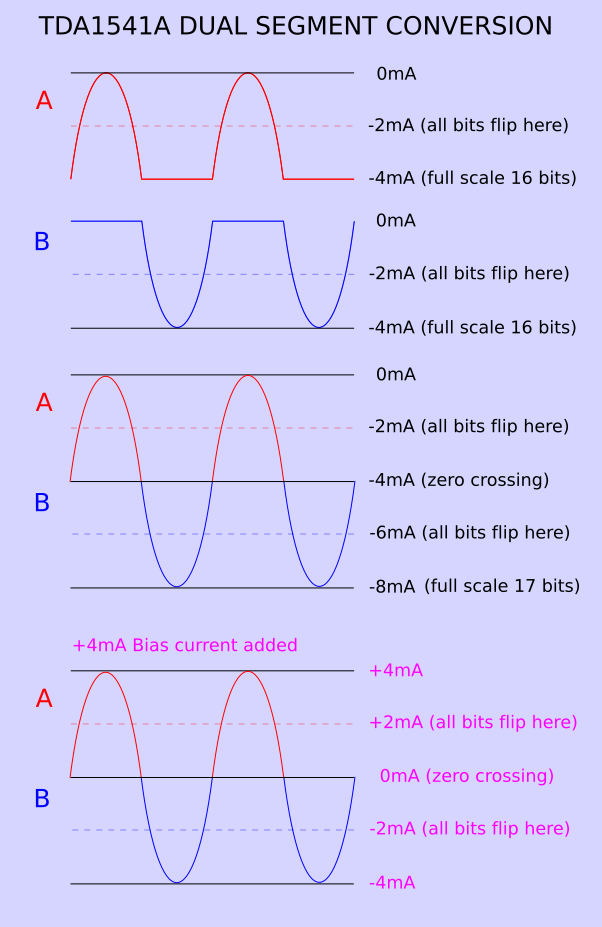

This means changing the polarity of one of the segments by changing the polarity on one of the primary windings.
Remember that the segmented TDA1541A decoder relies on correct polarity of each segment (attached sketch).
By changing the polarity of one of the segments (swapping the connections of one of the primary windings) we would get a signal similar to a full wave rectified signal on the transformer output.
This can be fixed by modifying the decoder circuit so it outputs two in phase signals that are routed to each segment output depending on MSB polarity.
However, you would still have -200mV DC on each 100R I/V resistor that would limit usable output signal swing (TDA1541A output compliance).
So the two +2mA bias sources are still required.
Fine trimming works best by using a suitable shunt resistor and a I/V resistor with a slightly higher value. Use highly stable resistors to minimise temperature related drift.
You could use 120R 0.1% thin film I/V resistors and put a 1K cermet multi-turn trimmer with 330R 0.1% thin film series resistor, in parallel with the 120R 0.1% thin film I/V resistor.
This will give you a fine trimming range between appox. 88 OHms and 110 OHms.

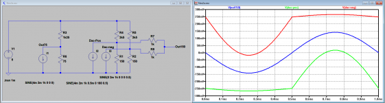

Just to complete thing, I tried even harder with the sim to reduce the harmonics caused by 0.2usec time delay with all kind of amplitude steps, but with no succes at all.Just changed the circuit so I now use two dac's from the same TDA1541A and I can adjust it to the same excellent performance. Apparently it is not the time difference, but the level difference that result in elevated even order harmonics. This is good news, as it makes it easier to make a good PCB and I think the circuit will maintain the good performance without readjusting all the time because of temperature drift.
The only conclusion can be that the 0.2usec that has been specified as a max value, is much smaller in real life and you really only had to adjust a gain difference.
