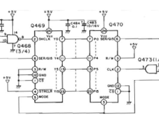

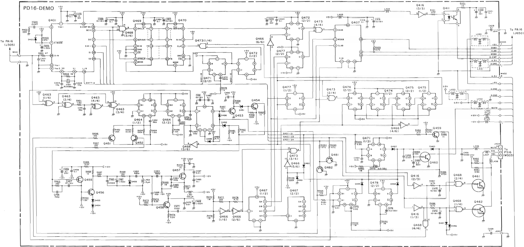

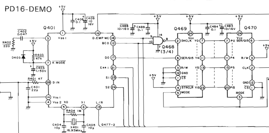

Ok, I was avoiding to post the whole thing for clarity... It seems we must.
Here the explanatory notes:
Here Q469 (74HC673) and Q470 (74HC674) form a 16 Bit Memory buffer 1 Bit wide. Another set of words to describe this circuit is "FIFO".
Serial Data from the Yamaha SPDIF Decoder enters Q469 - which performs serial to parallel conversion. It is functionally the same as 2 X 74HC595 cascaded for 16 bit.
The clock to load bits is the bitclock from the Receiver (Q401).
The "Mode" line controls the output storage register which holds 16 Bit worth of data and is controlled by a one shot pulse generator on each WCK edge. On the rising edge of this pulse the 16 Bit in the serial to parallel register are loaded into the output register.
All 16 Bit are connected to Q470 which is a 16 Bit parallel in, serial out shift register. After Mode is high (valid data is present at the outputs of Q469) the first falling clock edge performs the parallel load. With Mode low the falling clock edge clocks out the bits on pin 6 as serial data, delayed by 16 BCK periods and with the ability to use a clock asynchronous with the receiver BCK to clock out the bits from Q470 and into the SAA7220 Filter, together with a bit clock derived from the secondary PLL Clock around Q457 (J-Fet & LC Colpits oscillator).
The clock pin is driven by an AND gate that performs AND on the Receiver BCK and on the secondary PLL Clock. With either clock low after both clocks were high generates an edge. I think this uses the Receiver BCK to open a "time window" for the secondary PLL clock to create the actual edge. There are many extra dividers, flipflops, one shot pulse generators etc...
A lot of this could be simplified without any functional penalty.
For starters Q469 & Q470 could be replaced with a 74HC40105 FIFO which could be used to handle both WCK and DATA storage. Then Receiver BCK and DAC BCK can be fully decoupled. As WCK is sampled with DATA we get everything in sync at the output, so a lot of extra logic to align stuff no longer is needed.

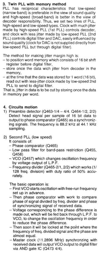

The Preamble detector on the other hand is genius. Easy to replicate we could use VCXO at the relevant clocks.
Or we can take a WM8804/8805 which in effect has all this build in with a DPLL with usually sub 50pS P-P (not RMS) jitter replacing the VCXO or looking back to DA-12 the VCLCO.
Now, do you still want to argue with me that Q469 & Q470 do not constitute a 1bit wide, 16 bit deep FIFO (e.g. 1/4 or 74HC40105)? If so what do they do in your considered opinion?

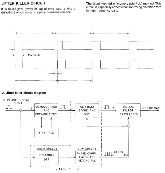

PS, I have somewhere a service manual with addendums for a modified version of this that uses optoisolation on the 16 Bit parallel bus and pulse transformers for clocks. I looked but cannot locate it. I actually encountered this unit in reality. It was a pro-audio version of something related to Philips LHH-1000. The manual may actually have been a xerox and I never scanned it.

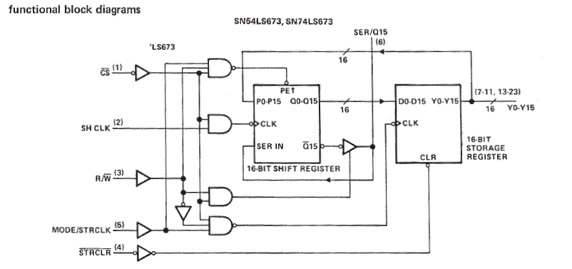

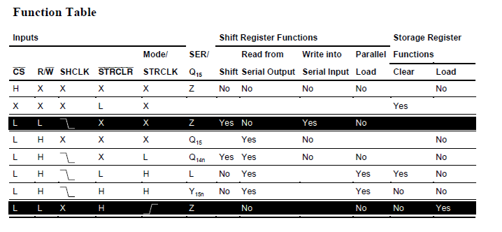

It all revolves around the '673 and how it operates. Below is what we are given.
Q469 /CS and R/W are tied to ground and /STRCLR is tied to +5V. The only control pin with a changeable state is MODE or to give it it's alternate name /STRCLK.
According to the table above there are only two possible states of operation given that /CS and R/W are always low and /STRCLR is always high.
At the start of a L/R frame, when it is high, WC is low forcing SHCLK to remain high so nothing is clocked in. When WC goes high, coincident with the start of data, the left channel 16 bit data is clocked into the shift register and when WC goes low again after the sixteenth bit is loaded the clock stops. As well as stopping the clock WC also triggers Q471/2 delivering a pulse to /STRCLK loading the 16 bit left channel data, in parallel, from the shift register into the 16 bit wide and 16 bit deep storage register. The same process in then repeated for the right channel. In short, at the falling edge of WC the parallel word moves across by one.
The 16 bit serial in parallel out (from the perspective external to the chip) shift register and the 16 x 16 storage register are two distinct but connected entities. You cannot load the storage register without first loading the shift register. You cannot treat it as a 16 x 1 because there is no serial output in the operating modes chosen and in the modes where there is a serial output you read back over the same pin you wrote in with.

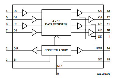

Not necessarily. Here the 74HC40105 FIFO IC:
DIR = Data In Ready (Flag)
SI = Shift In (Clock Rising Edge)
DOR = Data Out Ready (Flag)
/SO = Shift Out (Clock Falling Edge)
In principle we can link SI & /SO together and clock out one bit as we clock in another.
But this is no requirement.
The requirement is to ensure the FIFO has data in it when we attempt to clock it out.
So we can use the FIFO as elastic buffer.
For example to go from a BCK/WCK/BBCK IIS Input with BCK = 64 X WCK to the TDA1541(A) simultaneous format with LE, DATAL & DATAR.
We connect two 74HC40105 is cascade, for 32 Bit. After the first FIFO is filled we start the output clock. We constantly clock out 16 Bit per WCK. On the input side, we clock in 16 Bit's out 64 using the 64 X WCK Clock with stopped clock to mask off unwanted bits. The "elastic buffer" soaks up the speed difference.

In order to replace the '673 in that particular circuit you would need 4 '40105 and, assuming 4 bit versions, 4 serial in parallel out shift registers. However they arrived at it they arrived at an elegant solution.
Not at all. 1 x 40105 will be overkill actually.

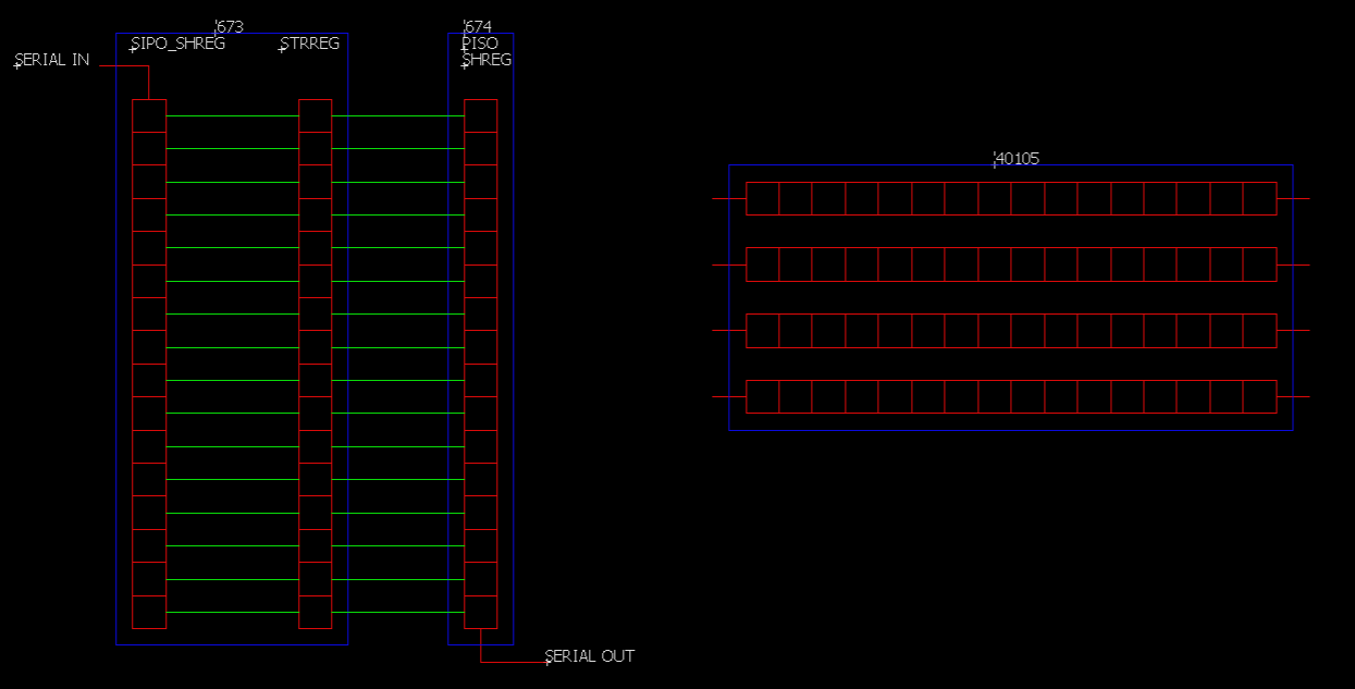

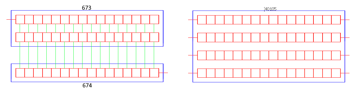

You're a funny guy Mr T. I have to congratulate you in the way you have neatly segued past the actual bone of contention.
Ok, let's use your own drawing as basis:
1) Do you agree that the left side is redrawn from your diagram and accurately represents the combination of 673 & 674?
2) Do you agree, that functionally, having only serial in, serial out plus clocks and flow control which are not shown (and yes, flow control will be different) the structure on the left performs as far as the serial data stream on in and out is concerned ABSOLUTELY IDENTICAL to 1/4 (one chain) of the structure on the right.
That is:
1) if we put the left and right structures into a box, each with it's own flow control
2) if we apply the same input data and input clock to both boxes
3) if we apply the same output clock to both boxes and observe the output data
4) we do observe on both boxes data output the exactly same data, syncronised with the output clock?
My contention is that if 1) - 3) are true then 4) is also true. And 4 can either be true or not.
And that is the bone of contention.
If you content that 4) is not true, please elaborate why.
I content it is true, because:
a) after the full 16 Bit are loaded into the 673 shift register MSB first, they are immediately transferred to the output register and then to the 674 shift register and the next high to low transition of the output clock will present the MSB on the output and then the subsequent Bits on each transition.
b) after the full 16 Bit are loaded into one if 4 strands of the 40105 FIFO the next high to low transition of the output clock will present the MSB on the output and then the subsequent Bits on each transition.
Thus, I further content that:
c) the output data is identical from either circuit, disregarding the specifics of each circuits internal function
d) the two circuits are functionally equivalent and may be substituted (with the necessary adaptations of flow control) for each other.
QUOD ERAT DEMONSTRANDVM
