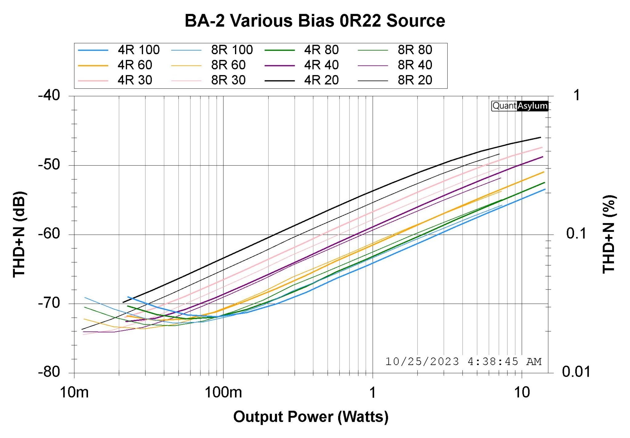

Here is a quick and dirty run-through I did with the BA-2 output stage sans input stage confirming what we know. Still fun though.
This was with 24V rails (ish).
The notations for each plot are load and mV across 0R22 source resistors. So, if my math is correct (always suspect)...
20mV => ~1A1 Iq
100mV => ~5A4 Iq
The signal generator I was using only puts out 7V8rms max, so I didn't push it too hard.
Edited to add - What I also 'like' is that at the higher Iq, the distortion at 4R becomes closer to and then becomes lower than at 8R. For me, this is a good thing with my speakers.

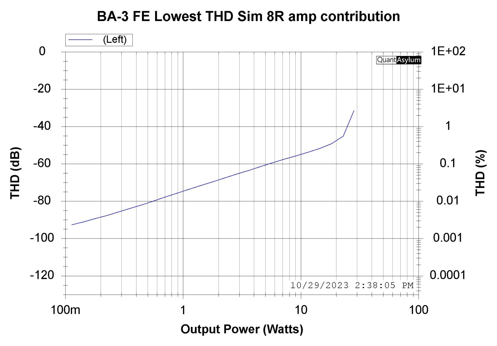

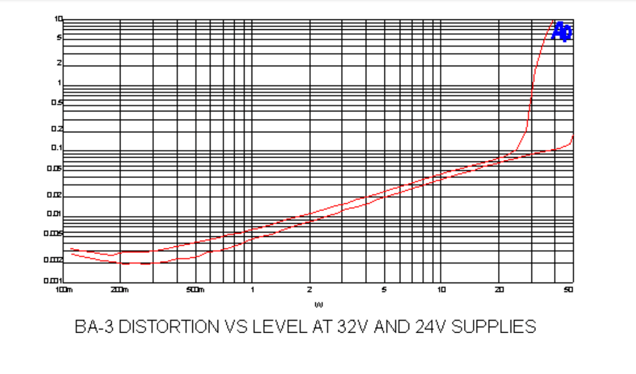

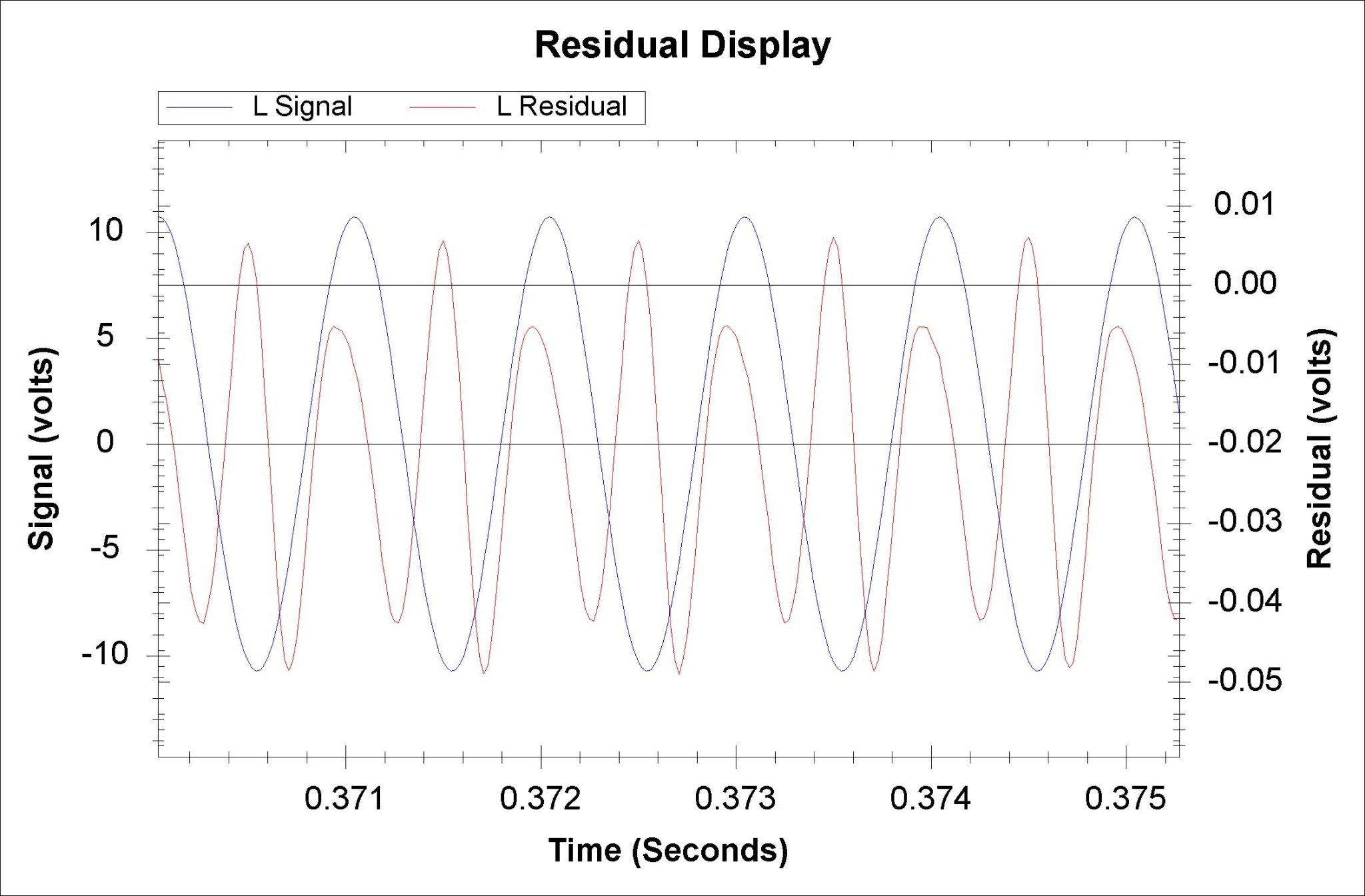

Well, I never said reading comprehension was my strong suit... it must rank near my short term memory, but I forgot.
What's exciting, is that although I thought I was achieving "odd" results with my BA-2 output stage when I first started screwing around with it along with the BA-3 FE, I think I'm actually getting nicely similar results to Papa.
Originally, I was reading the BA-3 distortion plots as if they were the distortion plots for the "BA-3 amplifier" i.e. the BA-3 FE + the BA-2 output stage.
After noodling a bit more with the BA-2 OS and wondering WTF was going so wrong and why my distortion was so high for the OS alone... I was wondering what the FE brought to the party in terms of distortion as it runs through the voltage range needed to achieve a certain power output. So, I ran it and reran it "like an amplifier" and told the software I was running an amp with an 8R load. Then, I reread the article AGAIN, and noticed that Nelson said...
"The data following are for a circuit with the parts and bias as shown and with P3 set for minimum distortion. Here's the distortion curve of the BA-3 front end vs output watts (as if it is driving a perfect follower output stage)"
Emphasis added is mine.
What's hilarious and perhaps kinda cool, is that I thought to do a similar graph before actually understanding what Nelson was putting in the article. Yes, I'm a dodo. It's well known by now.
Here's Nelson's version and mine below.
My guess re: the major difference in 'simulated' output power is that I set my 'bench' PSU to 24V0, and I was running Fairchild MOSFETs. In this case, the bench PSU was a standard linear PSU of common components seen around the threads. I was clipping right around 20Vp on the negative going waves. My guess is that Nelson was running Toshiba MOSFETs with lower Vgsth. My guess is that's also why his distortion was a bit better than mine. I don't remember whether I used LS JFETs or Toshiba for this FE, but I'll check. I'm going to compare the Fairchild MOSFETs to the Toshiba once I switch out the FEs and re-bias etc. etc. Nelson's plot also show a little lower distortion with 32V rails, so since that's where my 'real' PSU is currently sitting, that's encouraging.
And here's mine...

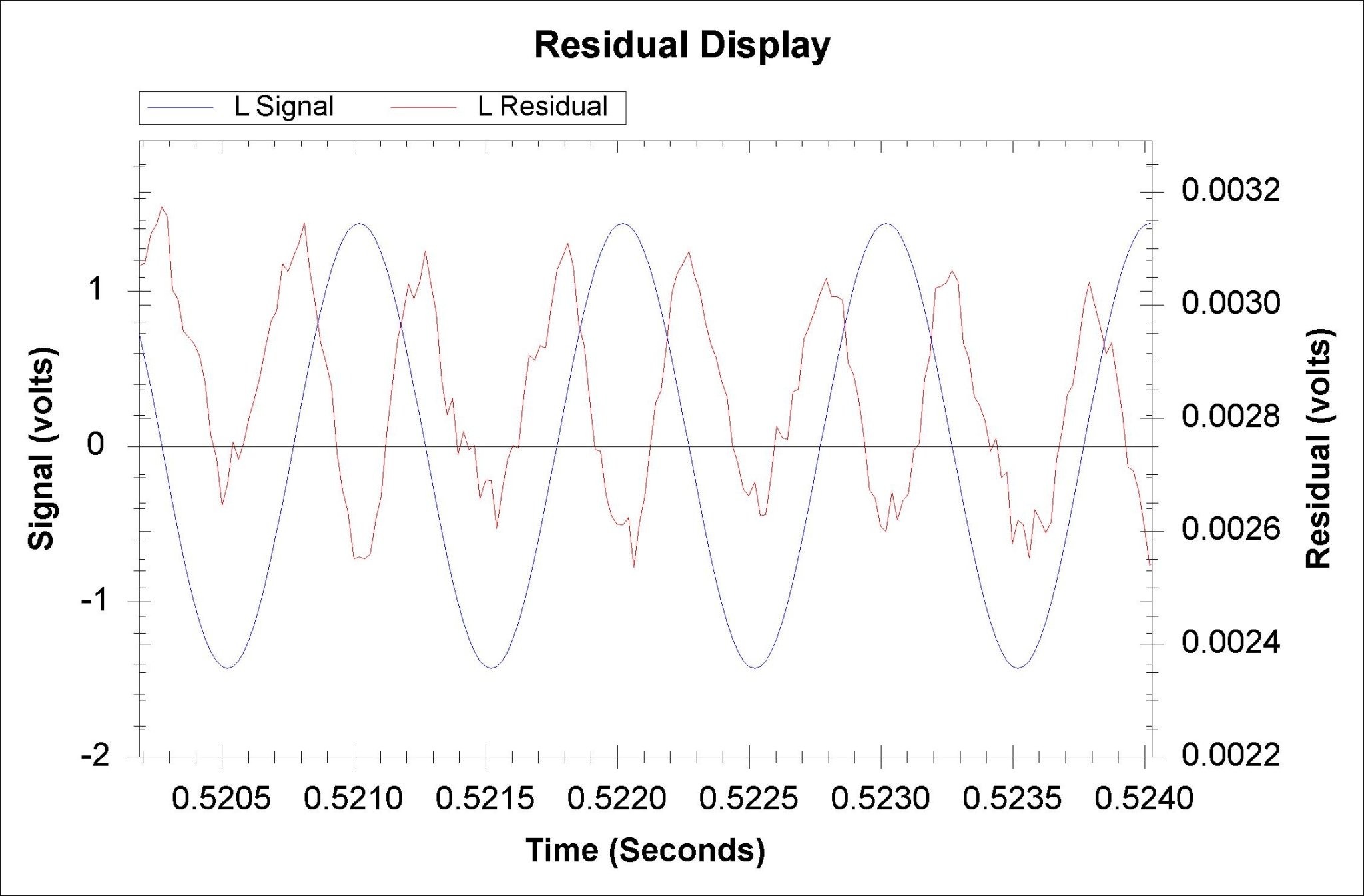

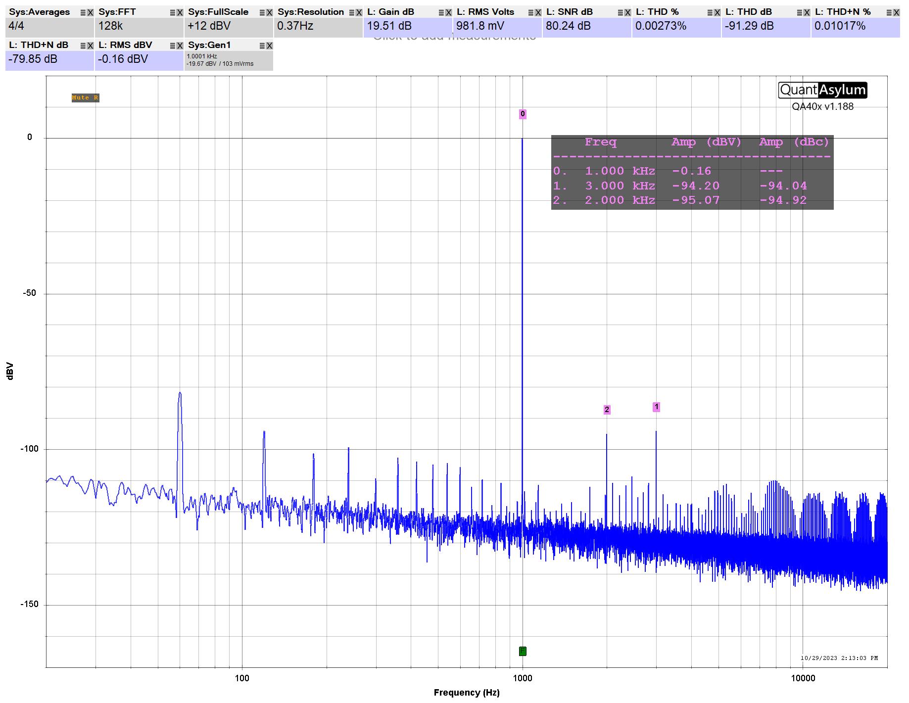

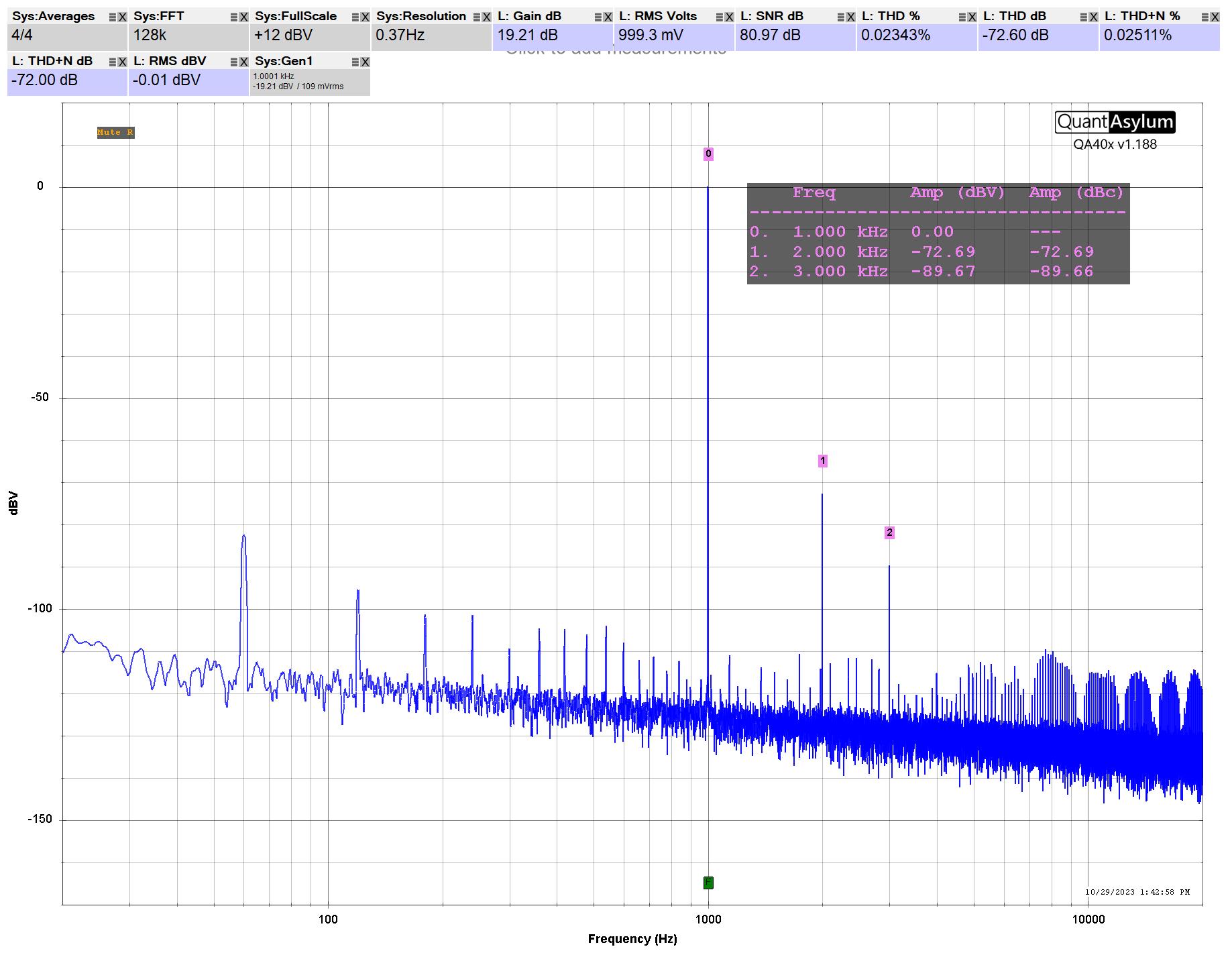

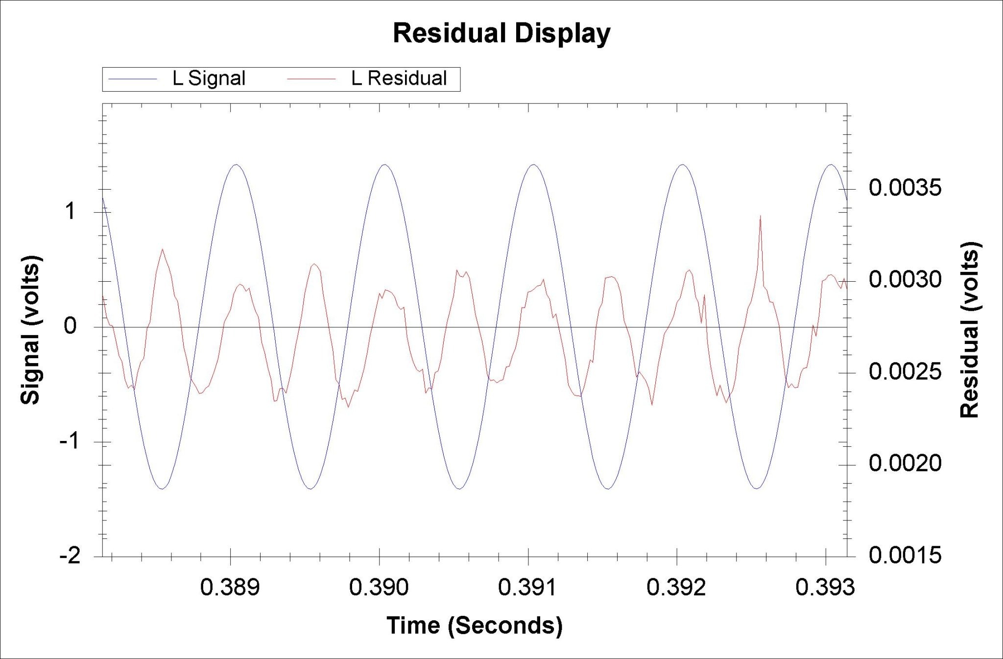

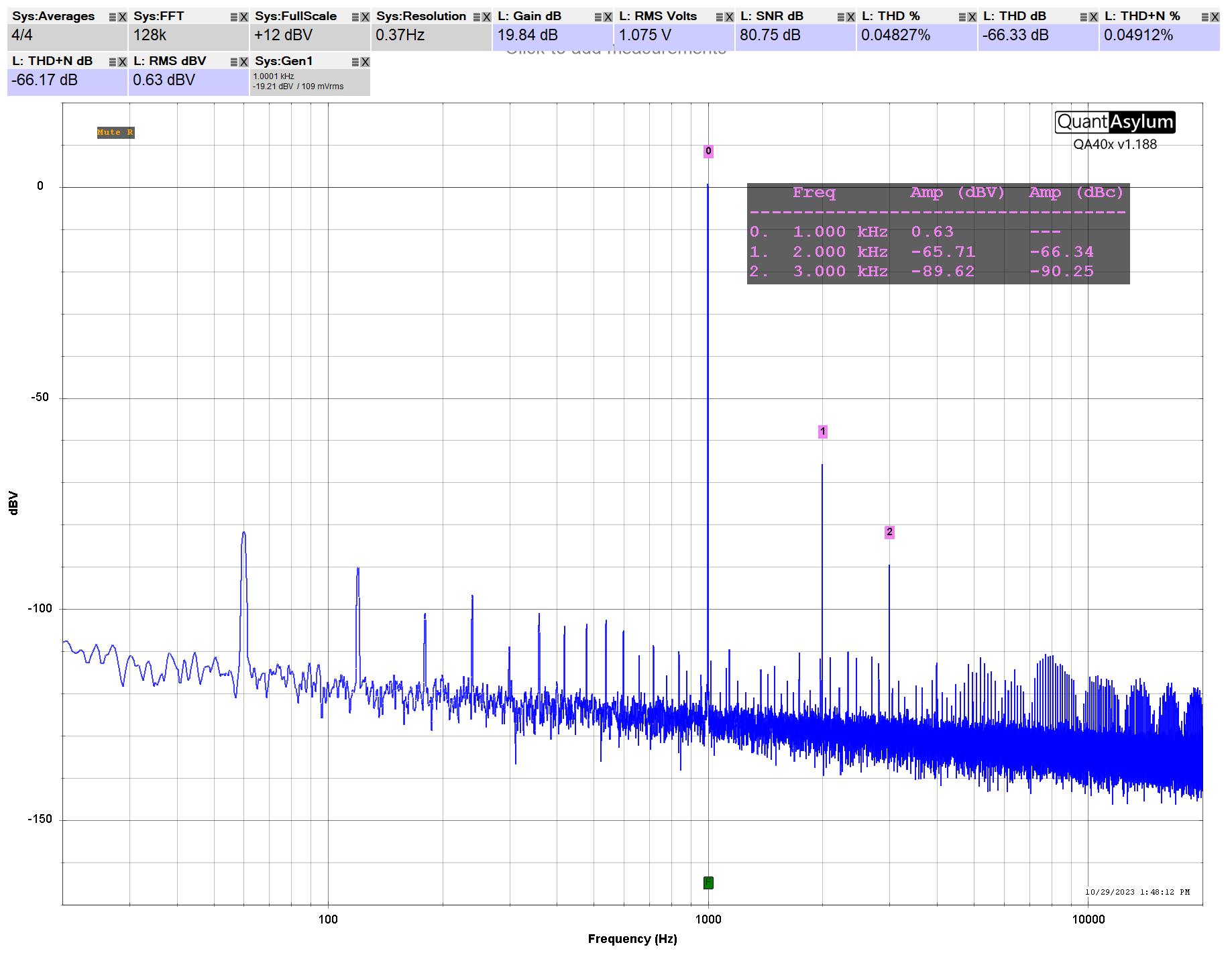

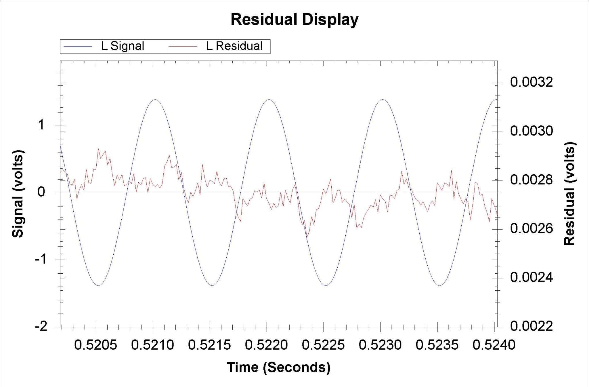

Also for fun, I examined the residual at various P3 positions to see what's happening.
I was correct that on one end of the pot travel the distortion is negative 2nd, and on the opposite end of the pot travel, the distortion is positive 2nd. That will be more interesting to play with mated back to the 'positive 2nd' BA-2 OPS.
Here are a few FFTs and their associated distortion residuals at 1Vrms (ish) output. Note, no matter what I did, the distortion started to become 3rd dominant at higher outputs ... I didn't study exactly where it happened or run a bunch of different settings and plots, but when checking out what things looked like at higher (call it > 4Vrms or so) output everything was 3rd dominant. Further piddling is needed to check that out. Apologies that the graphs aren't labeled. File names should be indicative. Note, I did not tweak bias when P3 was adjusted.
If THD numbers are your thing, you can notice distortion can be altered by orders of magnitude with the turn of a knob.
With the pot fully one way...
Roughly middle
Fully the other direction
Lowest distortion I could find in a few mins

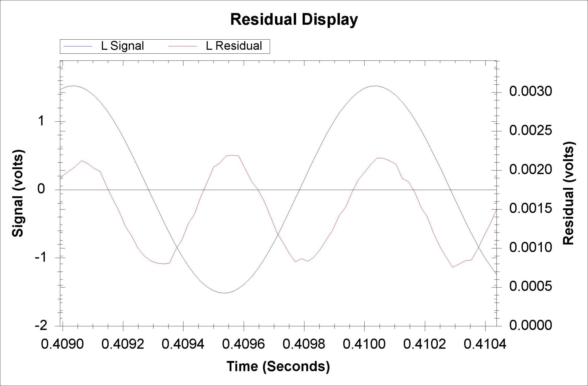

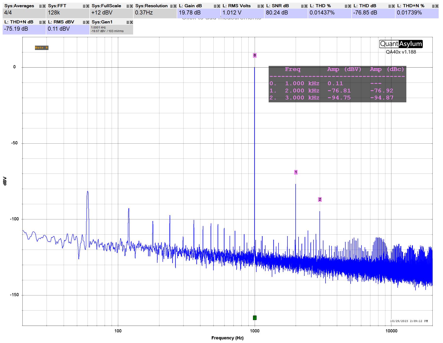

![Fully CCW FFT Fully CCW FFT](https://www.diyaudio.com/community/data/attachments/1136/1136721-ccbbdcfe901f6540ea7d96244b467cb9.jpg)
![Fully CCW FFT Fully CCW FFT](https://www.diyaudio.com/community/data/attachments/1136/1136725-ad501fd9da128980f3e2642d431b9ce5.jpg)
Roughly middle
![Middle FFT Middle FFT](https://www.diyaudio.com/community/data/attachments/1136/1136723-c7d9187bd1f3e6fabf01ac17d10a4de5.jpg)
![Middle Residual Middle Residual](https://www.diyaudio.com/community/data/attachments/1136/1136728-f3a7a1b33b4073fc8320603884ecb2db.jpg)
![Full CW FFT Full CW FFT](https://www.diyaudio.com/community/data/attachments/1136/1136722-93ea97f271ab48a44f9e88eab094e4dc.jpg)
![Full CW Residual Full CW Residual](https://www.diyaudio.com/community/data/attachments/1136/1136726-eebc16891e528ebe9cfd0e3d5e2e9f1b.jpg)
![Low Distortion FFT Low Distortion FFT](https://www.diyaudio.com/community/data/attachments/1136/1136724-a8f5fb125f44b15dce812dcd9ba785a1.jpg)
![Low Distortion Residual Low Distortion Residual](https://www.diyaudio.com/community/data/attachments/1136/1136727-fef7f7de18fbd5b0d0febdd6906d2e2c.jpg)
It's also important to note that all of this testing took place with a really poor grounding setup, everything strewn across the floor, and clip leads everywhere. Also, the residual DEFINITELY followed the mains ripple similar to what I had inquired about in a thread I started asking about "wandering" distortion. So, everything is likely directional, but things could have been set up a little better. I'll be curious to see how it performs from a measurement standpoint once I get it 'properly wired'.
