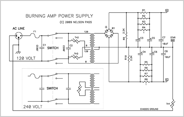

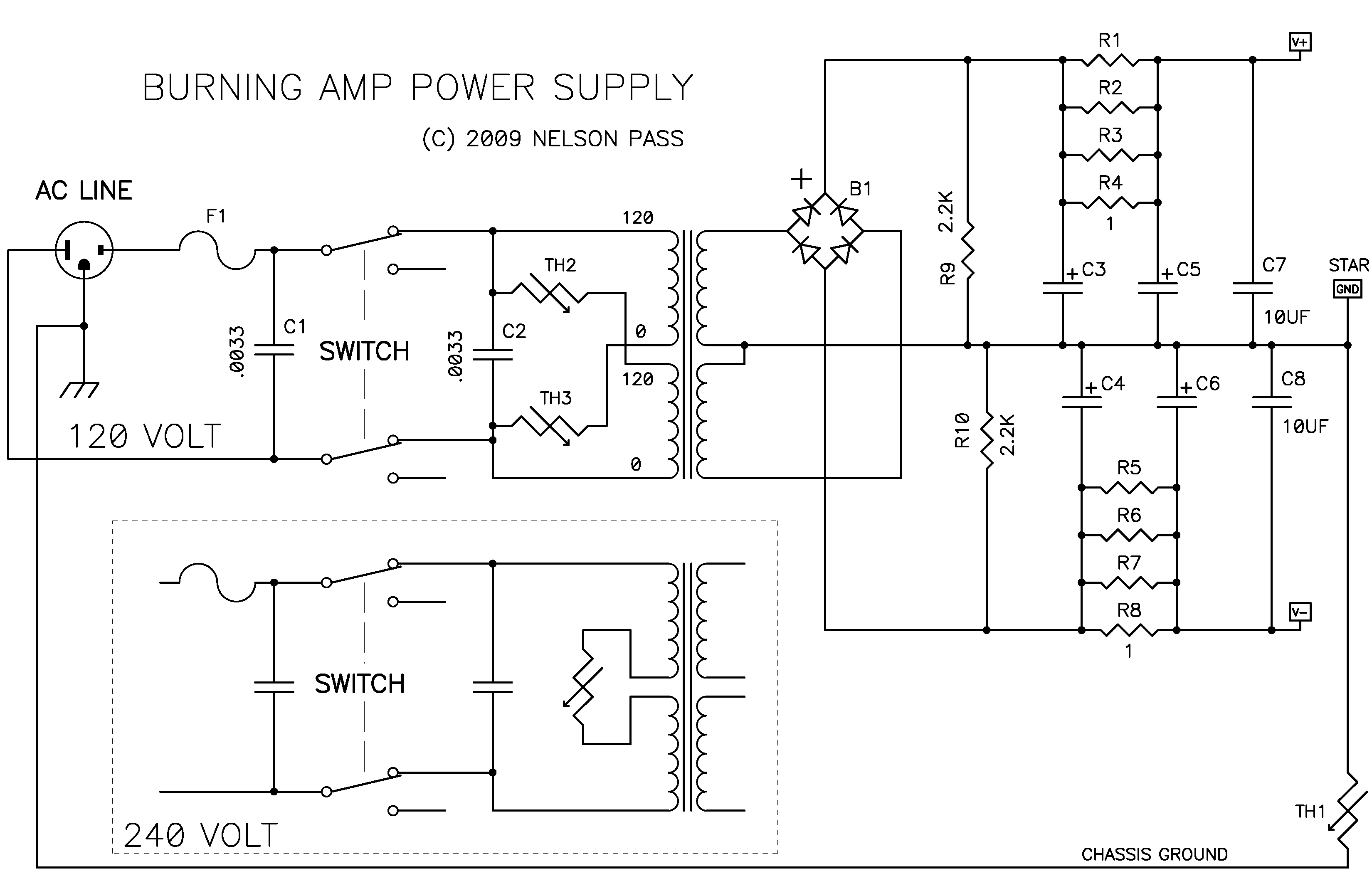

Here is the basic schematic of the power supply. This is essentially identical to many of the power supplies found in earlier articles such as the Zen series and the First Watt amplifiers. The components are fairly ordinary. As the typical Burning Amp will dissipate more than 300 watts, the transformer wants to be rated at least twice that. The diode bridge is 25 amp at 200+ volts, and you can use ordinary or fancy high-speed bridges as you please. There were a variety of transformers given away with these chassis, and our goal is to have approximately +/- 25 volts on the supply rails. Voltages from 18 to 30 volts are acceptable, and for transformers with secondaries much higher than 20 volts AC, operation using the primary taps in series as shown may reduce the secondary voltages to the desired levels.
Capacitors C1 and C2 are line-rated types only, as they will be filtering AC line voltages. Thermistors TH1 through TH3 are high power thermistors such as Keystone CL60. TH1 and TH2 are used to suppress inrush surges on turn-on, and also are useful at reducing mechanical noise in the transformers in conditions of high line noise. You will see that the chassis of the amp is to be directly attached to the AC Earth, and TH3 is used to attach analog ground to the chassis through the resistance of TH3, reducing issues with ground loops.”
C3 through C6 are your standard high capacity power supply capacitors. The “long” Burning Amp chassis with parallel output devices “6 deep” accommodates four such capacitors, the “shorter” chassis holds two. I recommend that the owners of the “short” chassis to find a way to mount two more capacitors at the front of the amp for C3 and C4. You will also note 10 uF film capacitors across the supply lines. You can delete these, but remember that the prototype used them.
All the resistors in the supply are 3 watt or higher types, and R1 through R8 are used to form an RC filter to reduce the supply ripple on the second set of capacitors.
From a layout standpoint, you can wire the supply just as you see on the schematic. The two crucial things to remember is that the ground point labeled STAR is the one you want to bring the signal grounds back to. The other issue is to keep the signal wiring at some physical distance from the transformer, AC lines, and the rectifier bridge and the wires attached to it.

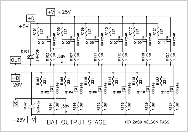

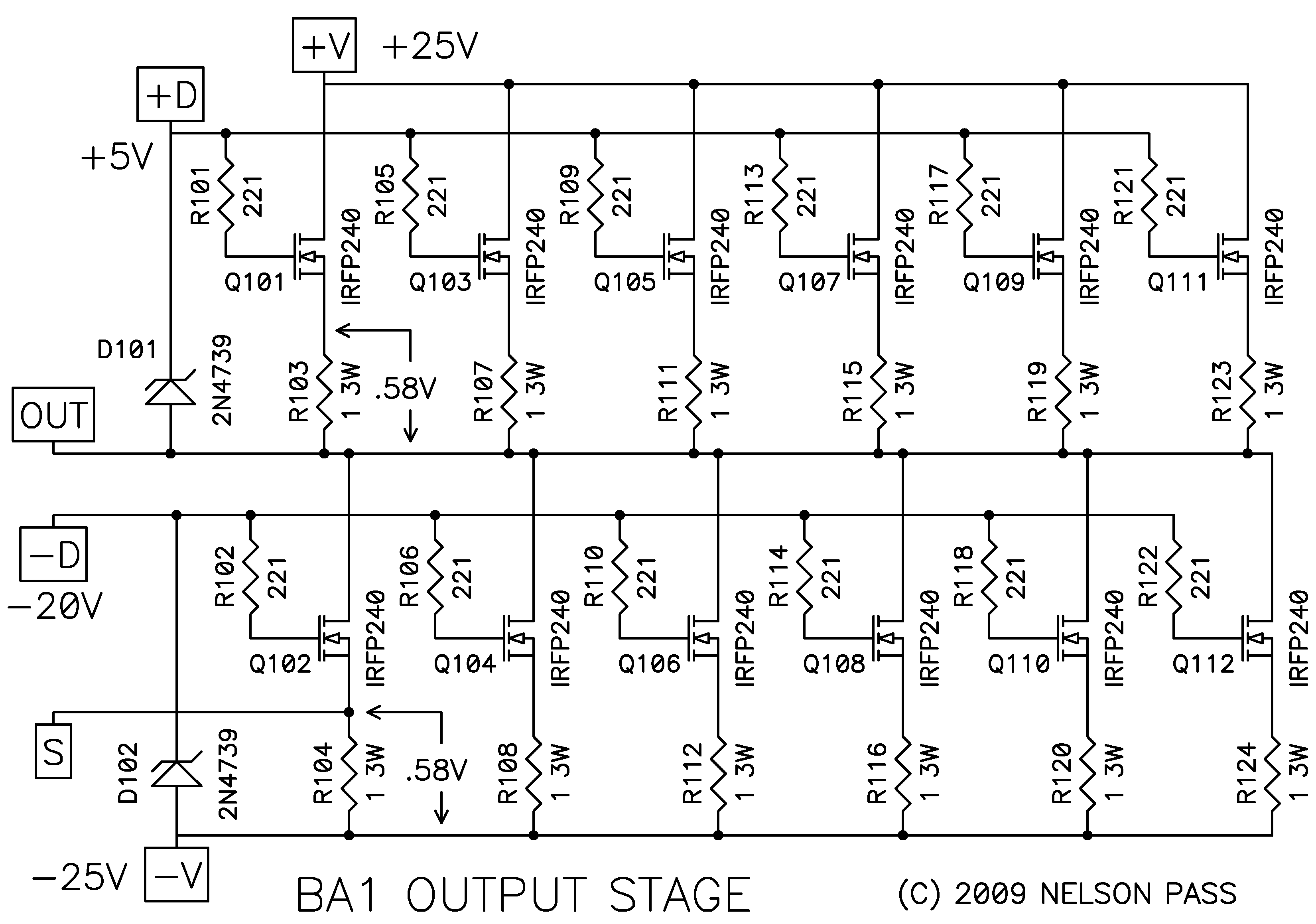

Because this output stage is intended for more than one project, a modular approach is being taken, and we will consider the output stage by itself. Figure 2 shows the schematic of the “6 deep” output stage. The “4 deep” output stage is achieved by deleting two pairs of output devices and the associated resistors. All the parts are numbered between 101 and 199.
This output stage circuit, along with a few parts to set up the bias for both halves is perfectly functional as a “power buffer” along the lines of the First Watt F4 amplifier, except that this one operates as single-ended Class A with a bias current of about 3.5 amps. The 1 ohm resistors are all 3 watt types, and the output devices are best matched for the Vgs within about
0.1 volts or so at 500 mA or so.

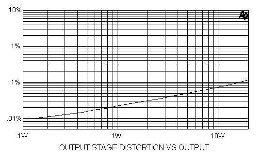

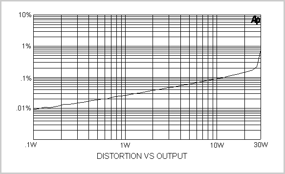

By itself the output stage has fairly impressive performance: The noise is 30 uV, the input impedance is 49 Kohms, and the damping factor is 33.
Here is the distortion vs output for this stage at 1 Khz into 8 ohms.

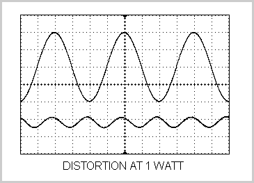

Here is the distortion waveform, a nice second harmonic, at 1 watt, 1 Khz into 8 ohms.

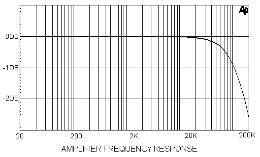

Here is the frequency response at 1 watt into 8 ohms.

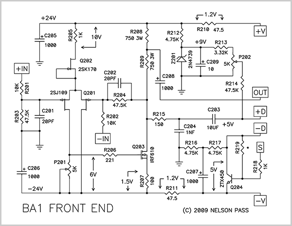

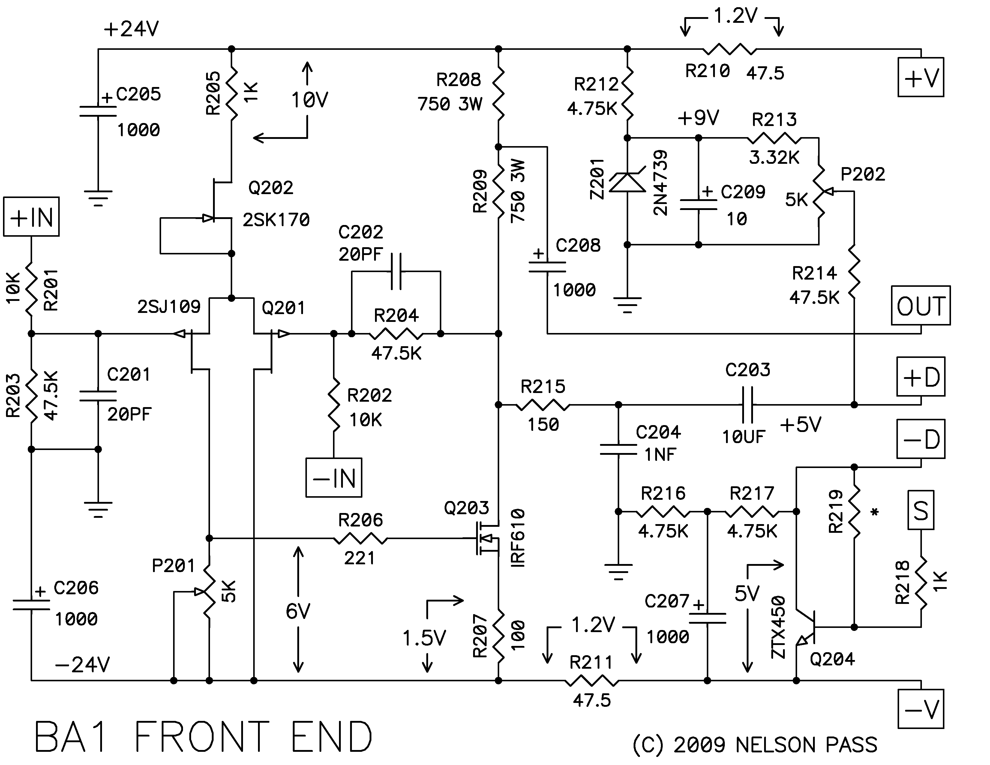

As with the output stage, the front end needs good stand-alone qualities. Besides accommodating single-ended and balanced inputs, we want a range of potential voltage gain figures, the ability to swing the output stage rail-to-rail, and performance that will not significantly degrade the stand-alone performance of our output stage.
This front end circuit also includes parts that provide bias voltages to both the positive and negative halves of the output stage. All the parts are numbered from 201 to 299.
Q201 is a dual matched pair of P channel Jfets, part 2SJ109. These are in scarce supply (although the recipients of Burning Amps will each get a pair). They can be substituted with matched 2SJ74 types, and a number of other parts will function with lesser performance.
Q201 is biased by a constant current source formed by Q202 and R205. Q202, an N channel JFET 2SK170 with Idss of about 10 mA, is operated as a constant current source by simply attaching the Gate pin to the Source pin. If you don’t have a 2SK170 with the 10 mA Idss, you can parallel two lesser value parts. The 10 mA figure is not critical, and potentiometer P201 provides flexibility on the value. R205 takes up some of the dissipation that would otherwise be found in Q202, keeping it within dissipation spec. As shown on the schematic, typically you will see about 10 volts across this part, reflecting the 10 mA current.
R201 through 204 form the balanced inputs networks. R201 = R203 and R202 = R204, and the gain is R203/R201. Compensation capacitors C201 and C202 form the high frequency roll-off for the gain, and while C201 is not strictly essential, it helps to retain the balanced input common mode rejection figure at high frequencies. If you are interested in higher gain figures, adjusting the values of R201 and R202 is a good place, as it minimally disturbs the frequency compensation.
When operating the amplifier with a single-ended (RCA) input, the negative input is shorted to ground. You can use dual input connectors, RCA and XLR with the hot RCA connected to pin 2 (+) of the XLR and RCA ground to pin 1. Pin 3 is the (-) input, and can be connected to pin 1 on the XLR for single-ended input.
The output signal from the input JFET appears across P201 and drives the Gate of Mosfet Q203 which provides the bulk of voltage gain for the front end. P201 provides adjustment against the expected variations of components in the front end and is used to set the output DC figure of the front end. You will note that no “lag” frequency compensation is employed.
The Drain of the Mosfet Q203 is biased with about 15 mA of current provided by the series 3 watt resistor values of R208 and R209. On the Source of Q203 the gain is degenerated by R207 at 100 ohms, limiting the gain and improving the linearity and bandwidth.
The point between R208 and R209 is “bootstrapped” from the output of the amplifier through C208. In many designs a constant current source would be employed here, but this approach is not only simpler but provides voltage drive greater than the positive supply voltage so that the maximum output of the amplifier gets as close to the supply rail voltages as possible.
In this case the power output difference is not small, and the Class A nature of the output stage makes us dissipate about 7 watts for every volt. The performance of the bootstrapped system with a good linear output stage is so close to the performance offered by constant current sourcing at lower
levels that it becomes the clear choice.
You will note that a RC networks appear between the output node of the front end and the input of the output stage. C203 rolls off the low frequency response at about 0.3 Hz and I chose to use a 10 uF polypropylene type here, as the only capacitor in the signal path. Strictly speaking you do not have to use this capacitor, but it does make adjustment and long term DC stability very easy to achieve. Without it, you will be using P201 to adjust the output offset, and there will be considerably more drift.
C204 and R215 form a high frequency pole at the output of the front end and this cleans up the square wave response at very high frequencies by simultaneously loading the front end and filtering the output above 200 Khz.
Assuming you use C203 as recommended, you will also want the positive bias network consisting of R212, R213, R214, Z201, C209, and P202. C203 and all these parts are absolutely essential if you decide to use the output stage as a stand-along power buffer. The purpose of this circuitry is to provide a positive constant bias voltage to the input of the bank of power Mosfets which sets their output to 0 volts DC. P202 is used to adjust this value.
There is also a bias system for the negative half of the output stage formed by R216, R217, R218, R219, C207 and Q204. Q204 is a generic NPN transistor which sees the voltage appearing across the 1 ohm Source resistors of the negative half of the output stage and sets their value at about 0.6 volts, locking them in at a constant current value of 0.6A each. R219 is not ordinarily used here, but can be added if you need to reduce the current in an amplifier which is running too hot. If you need to use it, you can try values starting with 47 Kohm or so, decreasing the resistance for less bias current.
R210, R211, C205 and C206 form a supply decoupling filter which helps keep the noise low by filtering the ripple from the raw power supply rails.

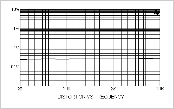

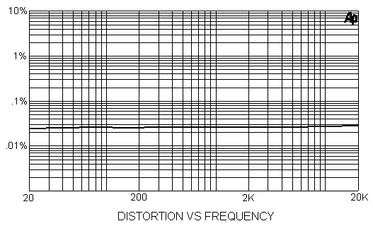

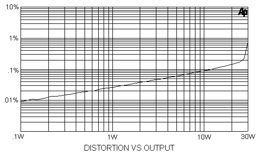

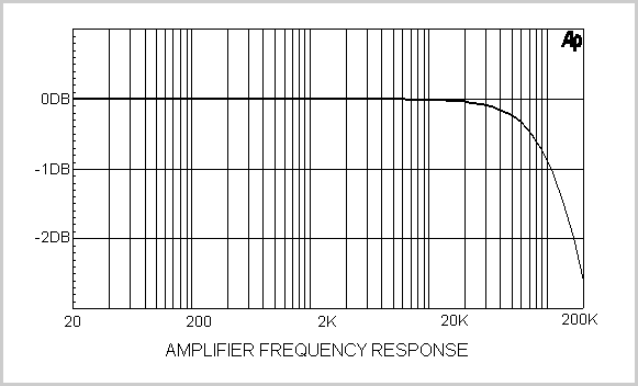

The measured performance of both stages together is comparable to that of just the follower output stage. Of course it now has voltage gain, and with that we see an increase in noise to about 70 uV. The bandwidth is slightly reduced to -3 dB at about 200 Khz.

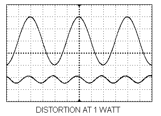

Here is the distortion vs power at 1 Khz into 8 ohms:
Here is the distortion vs frequency at 1 watt into 8 ohms:
Here is the amplifier frequency response curve at 1 watt:

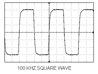

This extended bandwidth will make you expect a good looking square wave.
At 100 Khz, the BA 1 does not disappoint:

Schematic typo on BA1 Output Stage
It appears an extra dot was added to the BA1 Output Stage schematic posted as the web page creating a junction between -D and R104 . The connection effectively shorts out the gate-to-source of Q102 keeping in cutoff. The connection does not exist in the PDF version.
EDITOR'S NOTE:
Yes this seems to be the case. Somehow the dot slipped back in!
The pdf version is the correct one and we will correct this version as soon as possible..
EDITOR'S NOTE:
