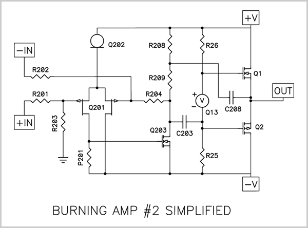

Concept
As with BA-1, this amplifier has a voltage gain stage which uses matched P channel Jfets to differentially accept a balanced or single-ended input signal. Following the Jfets, an N channel Mosfet provides single-ended voltage amplification controlled by a local loop. The output stage is a push-pull Class A power follower, biased by a TL431 monolithic shunt voltage regulator.
The component numbers here will correspond to those in later, more detailed schematics. We see the JFET input differential pair Q201 biased by current source Q202, the voltage gain transistor Q203, the output bias voltage source Q13 and the output power followers Q1 and Q2. Local feedback for the front end comes through R204. R201 equals R202, R203 equals R204 and the gain of the balanced front end is set by the ratio of R204 / R202. P201 is a variable resistor which adjusts the DC offset of the front end, and Q203 drives a bootstrapped source formed by R208, R209, and C208.

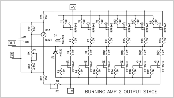

Output Stage
Because this output stage is intended for more than one project, a modular approach is being taken, and we will consider the output stage by itself. Here is the schematic of the “6 deep” output stage. The “4 deep” output stage is achieved by deleting two pairs of output devices and the associated resistors. All the parts are also numbered between 101 and 199.
The 1 ohm resistors are all 3 watt types, and the output devices are best matched for (the) Vgs within about 0.1 volts or so at 500 mA or so. It is not necessary or practical to match the N channel parts to the P channel parts. P101 is used to set the bias current of the output stage, and P102 is used to adjust the output DC offset.

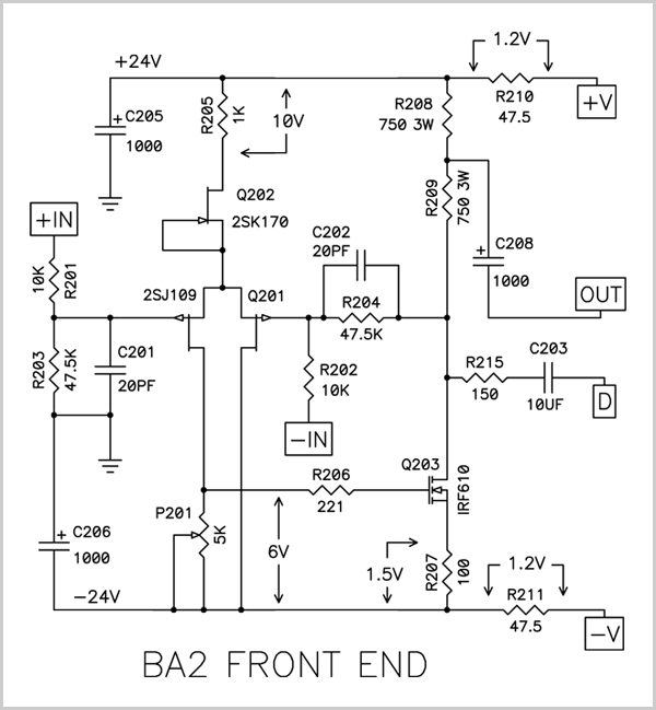

Meet the New Front End. (Same as the Old Front End)
As with the output stage, the front end needs good stand-alone qualities. Besides accommodating single-ended and balanced inputs, we want a range of potential voltage gain figures, the ability to swing the output stage close to the rails, and performance that will not significantly degrade the stand-alone performance of the output stage. Most amplifiers enclose the output stage in the feedback loop with the front end, but that will not be the case here. This is largely the same as BA-1 with the removal of all the output stage biasing elements:
All the parts are numbered in the range of 201 to 299. This front end circuit is different from BA-1 in that it does not include the parts to bias the output stage – those have been shifted to the output stage schematic to make these projects more modular in the future. It also deletes C204, the capacitor from the output of the front end to ground, as it happens that the output stage of BA-2 has more input capacitance than that of BA-1, providing a more optimal amount for a clean square wave response. I have also lowered the gain, although you can put it back in if you like.
Q201 is a dual matched pair of P channel Jfets, part 2SJ109. These are in scarce supply (although the recipients of Burning Amps will each get a pair). They can be substituted with matched 2SJ74 types, and a number of other parts will function with lesser performance.
Q201 is biased by a constant current source formed by Q202 and R205. Q202, an N channel JFET 2SK170 with Idss of about 10 mA, is operated as a constant current source by simply attaching the Gate pin to the Source pin. If you don't have a 2SK170 with the 10 mA Idss, you can parallel two lesser Idss parts. The 10 mA figure is not critical, and potentiometer P201 provides flexibility on the value. R205 takes up some of the dissipation that would otherwise be found in Q202, keeping it within dissipation spec. As shown on the schematic, you will typically see about 10 volts across this part, reflecting the 10 mA current.
R201 through 204 form the balanced inputs networks. R201 = R202 and R203 = R204, and the gain is R204/R202. Compensation capacitors C201 and C202 form the high frequency roll-off for the gain, and while C201 is not strictly essential, it helps to retain the balanced input common mode rejection figure at high frequencies.
When operating the amplifier with a single-ended (RCA) input, the negative input is shorted to ground. You can use dual input connectors, RCA and XLR with the hot RCA connected to pin 2 (+) of the XLR and RCA ground to pin 1. Pin 3 is the (-) input, and can be shorted to pin 1 on the XLR for single-ended input.
The output signal from the input JFET appears across P201 and drives the Gate of Mosfet Q203 which provides the remainder of the voltage gain for the front end. P201 provides adjustment against the expected variations of components in the front end and is used to set the output DC figure of the front end only. No “lag” frequency compensation is employed.
The Drain of the Mosfet Q203 is biased with about 15 mA of current provided by the series 3 watt resistor values of R208 and R209. On the Source of Q203 the gain is degenerated by R207 at 100 ohms, limiting the gain and improving the linearity and bandwidth of this stage.
The point between R208 and R209 is “bootstrapped” from the output of the amplifier through C208. In many designs a constant current source would be employed here, but this approach is simpler.
You will note that RC networks appear between the output node of the front end and the input of the output stage. C203 rolls off the low frequency response at about 2 Hz and I chose to use a 10 uF polypropylene type here, as the only capacitor in the signal path. You could consider using an Elna 10 F silk electrolytic here, in which case you want to orient the + polarity pointed to the left, toward the R215.
R210, R211, C205 and C206 form a supply decoupling filter which helps keep the noise low by filtering the ripple from the raw power supply rails.

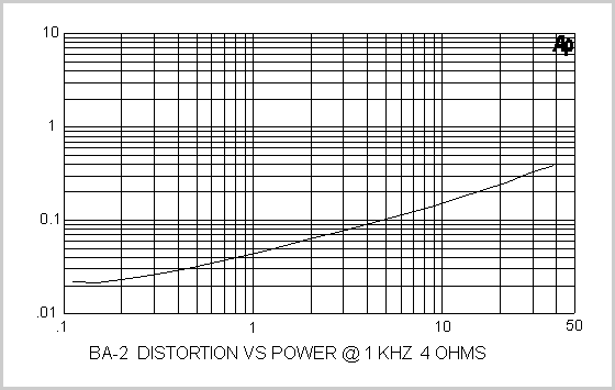

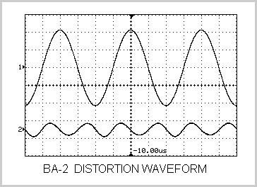

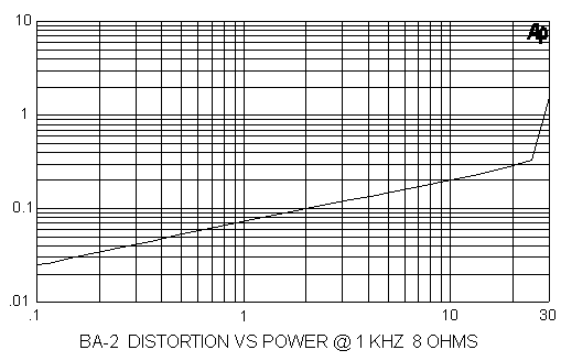

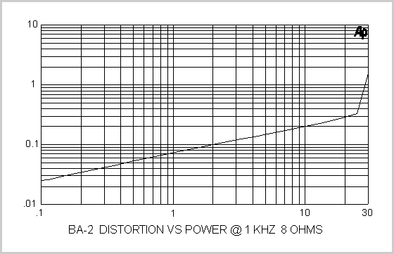

Like the BA-1, the measured performance of both stages together is comparable to that of just the follower output stage. Here is the distortion vs power at 1 Khz into 8 ohms:

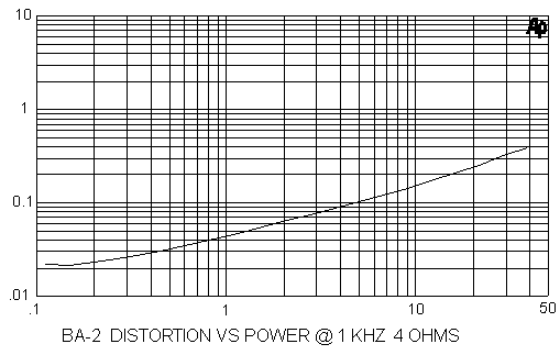

Here is the distortion vs. power at 1 Khz into 4 ohms:

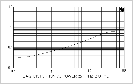

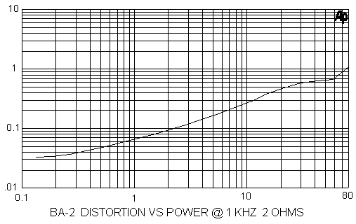

Here is the distortion vs. power at 1 Khz into 2 ohms:
Clearly the BA-2 has far more capacity into low impedance loads than BA-1.

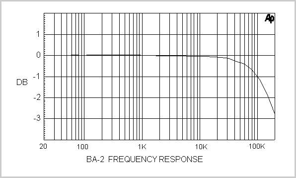

Here is the amplifier frequency response curve at 1 watt:

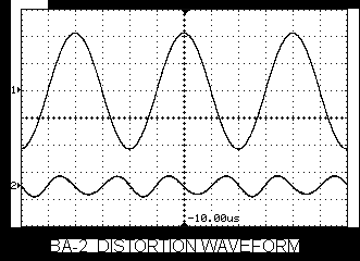

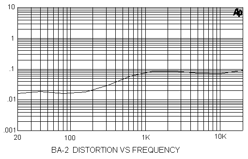

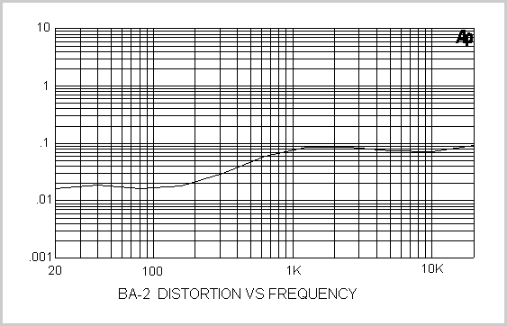

And here is the distortion vs. frequency:
This figure deserves some discussion, as it illustrates the notorious “IR P channel problem” in which the transconductance of the International Rectifier P channel Mosfets exhibit a shelving in the midband. For complementary followers, this shows up as increased second harmonic about about 200 Hz, leveling off around 1 Khz. Is this really a problem? Perhaps it is if you judge by specs, but I have not heard actual complaints from listeners, probably because second harmonic is relatively inoffensive. Here is what the distortion waveform looks like:
There are three common cures to this:
- Use different P channel Mosfets – this problem is specific to IR P channel parts.
- Place the output stage in a feedback loop to correct it.
- Use these circuits in balanced output stages, where the second harmonic will cancel.
Correcting this issue with one or more of the above will reduce the mid to high frequency distortion by about half or more, depending on which cures you pick.
Or you can say, “My, that lovely second harmonic certainly warms up the midrange on cold winter nights.”

It looks like the output stage diagram is not correct. The output signal from the input stage that goes to the 'D' connection of the output stage will not be fed tot he Gate of the MOSFET's, but it will go to the V+ (through C1 and R26), V- through R25 and P2.
Please verify.
