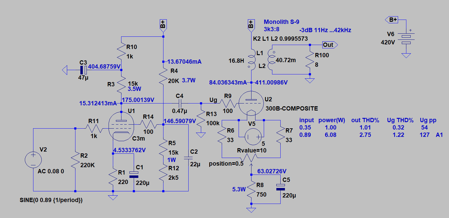

So on some further investigation 100k seems a more acceptable value and should have little impact sonically. Do you agree?
You can look it up in the data. WE states maximum grid leak is 250K in self bias. You should be OK with 220K in self bias. Helps the driver a little.

Yes.So on some further investigation 100k seems a more acceptable value and should have little impact sonically. Do you agree?
But C3m driver in this schematic remains the most limiting factor:
- high impedance;
- limited driving capacity,
- too much gain, so sensitive to disturbances;
- too high distortion (compared to good triodes/trioded pentodes);
- too much power requiring for biasing.
I would rather use trioded C3g, which have enough low output impedance, good driving capacity, enough low distortion even at high swing.
Agree with the C3g vs C3m issue, but cannot you lower the gain with the appropriate anode resistor?
Actually I guess that driving capacity of C3m should be good enough (current).
Why not use a plate choke instead of an anode resistor if your driver is in triode? As you increase the current going through the stage, the HT voltage required for a decent value of resistor climbs to unrealistic levels. With a plate choke you can use a current of 15mA or more.
In addition, with a higher current you stand some chance of using an unbypassed cathode resistor of 100-200R if your plate choke has plenty of inductance. A humble Hammond 126C has 15mA gap and 106H inductance. Even an even more humble 157G - used in the Hagerman headphone amp - has 30H inductance and 40mA gap.
Internal resistance in tetrode mode 250k. :-(
If you decrease load, the distortion will be increasing (even at 220k->100k -300B- grid leak change).
