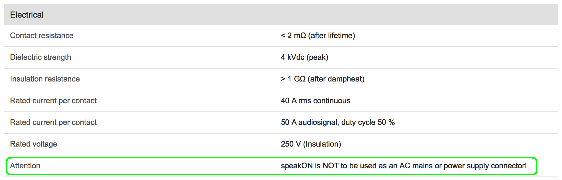

If you do decide to change the cable, it is very simple as the neutrik connector is very easy to take apart and there are simple screw terminals. These connectors are designed to carry line voltage at low frequency and as such are not very fussy. They are used as highly reliable power connectors on a lot of professional gear.
The speakON connectors are used for speaker connections. The powerCON is for power. Neutrik says specifically to not use the speakON for power connections. Attached is from the NL4FX 4-pole speakON technical specs.
