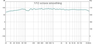

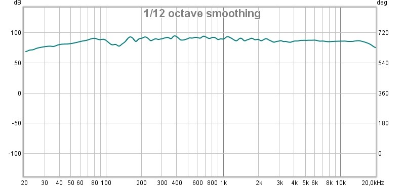

Mini DSP is very good for test purposes when developing loudspeakers and designing a crossover point, but is very bad for listening to music. The DAC built into the Mini DSP is far from an audiophile DAC, let alone if you have a Turntable player as a source, which is converted from analog to digital and back to analog. Creating a crossover is not possible without measurement and knowledge. By the way, I own a mini DSP but only for testing until I have developed a crossover.
Reactions: WBS

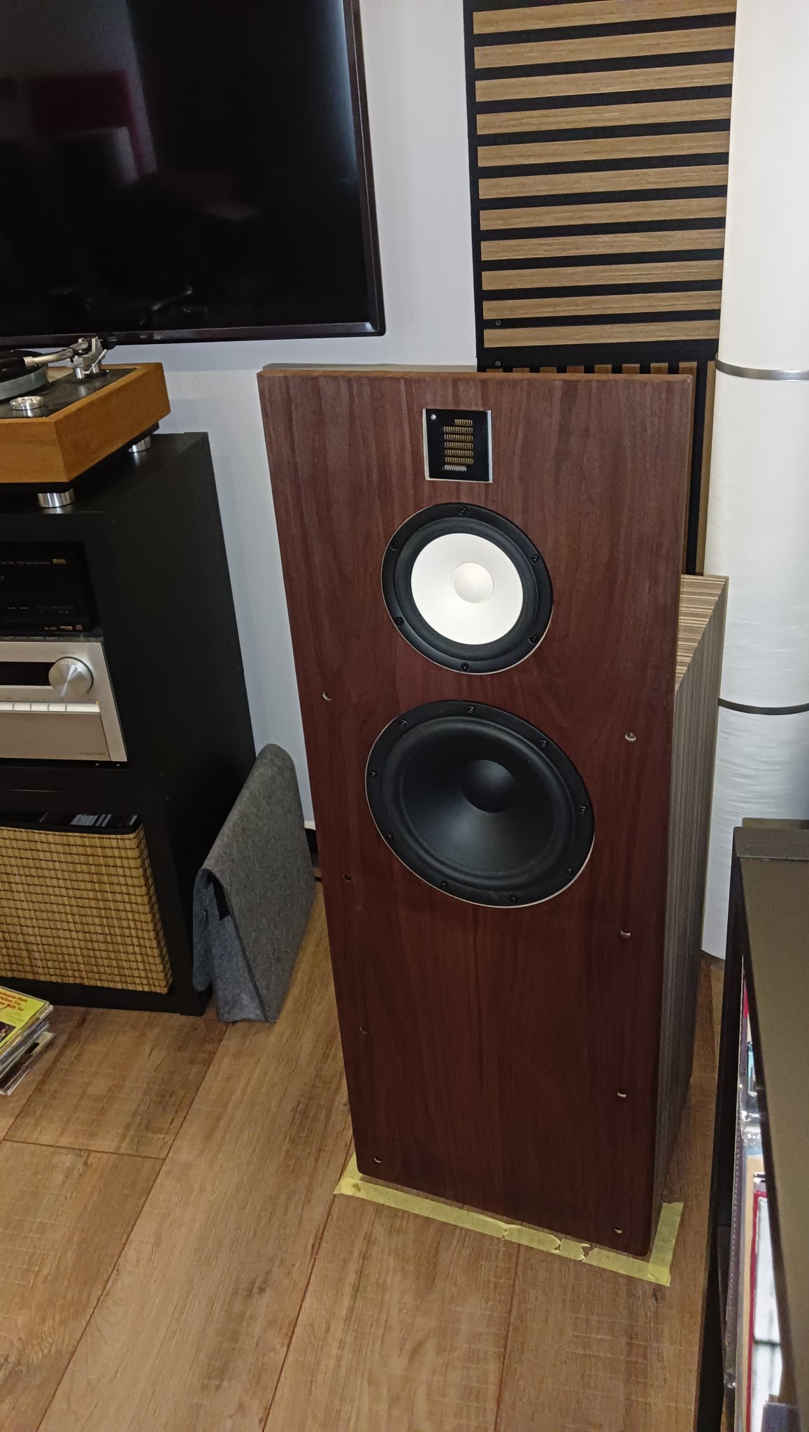

For all those who want to rebuild a Caladan, it is essential to mount the woofers from the rear and not from the front. The sound pressure of the woofers increases by about 2 dB, which makes the tweeter appear quiet. To compensate for this, Clayton has already done the right thing and mounted the drivers from the rear.
Reactions: tigeranand
@Chemarcelo

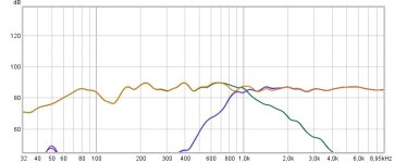

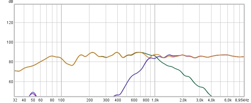

You did exactly as I envisioned. Very glad you got such great results. Look at other designs such as member Juhazi where he uses that mid in that fashion with a tweeter above. There might be more goodness awaiting you!
I agree with babus that MiniDSP 4x10HD is not that good as a digital xo (I have one), but I totally agree with you that active is great! I run active 4 ways with digital crossover. You need a 4-way DAC. I use Lynx Hilo. And I use Acourate software for developing the xo filters.
BTW punchier bass might have to do with midbass harmonics that reach the midrange that have been improved with the new driver.
Reactions: Chemarcelo
There is nothing wrong with using the original drivers as in the Caladan and keeping the Dayton Audio tweeter, as long as you don't listen super loud otherwise you will make the tweeter sweat due to low crossover. My drivers have now arrived and are running at 10Hz on the tone generator to burn them in. I will try to get it ready in the next few days
