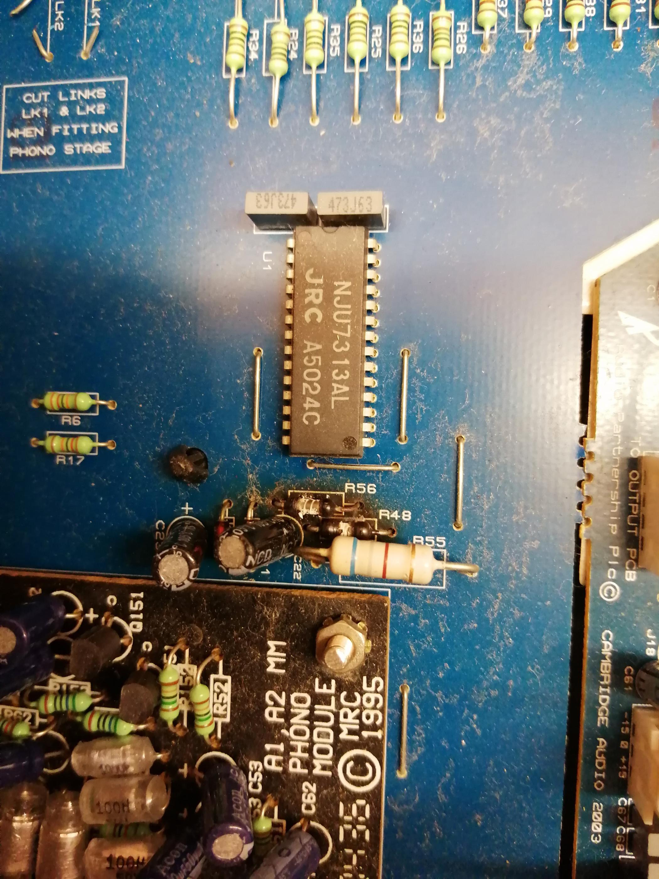

R48 is part of a zener dropper regulator circuit, as is its counterpart R56. They are known to overheat. Simply use a higher wattage resistor there.
Likewise R42 on the amplifier PCB is a 1/8th watt part, replace it with a 0.6W metal film type.

My 640A v2 is up and running again after 2 years collecting dust. The R42 was obviously the culprit - I dropped a 1/4W one in (cost, less than 10 pence), though as I'd ordered 8 new Panny caps, and as I'd removed the existing ones as part of my ham-fisted fault-finding, I decided to go with the new caps (cost, a little more...). I can't believe just how many screws I had to re-fit just for what was effectively a single resistor! Anyway, sounding good so far (this does make the need/desire to upgrade to a PureSound valve amp less pressing/justifiable!). Thanks to all your guidance.
R48 and R56 scorched

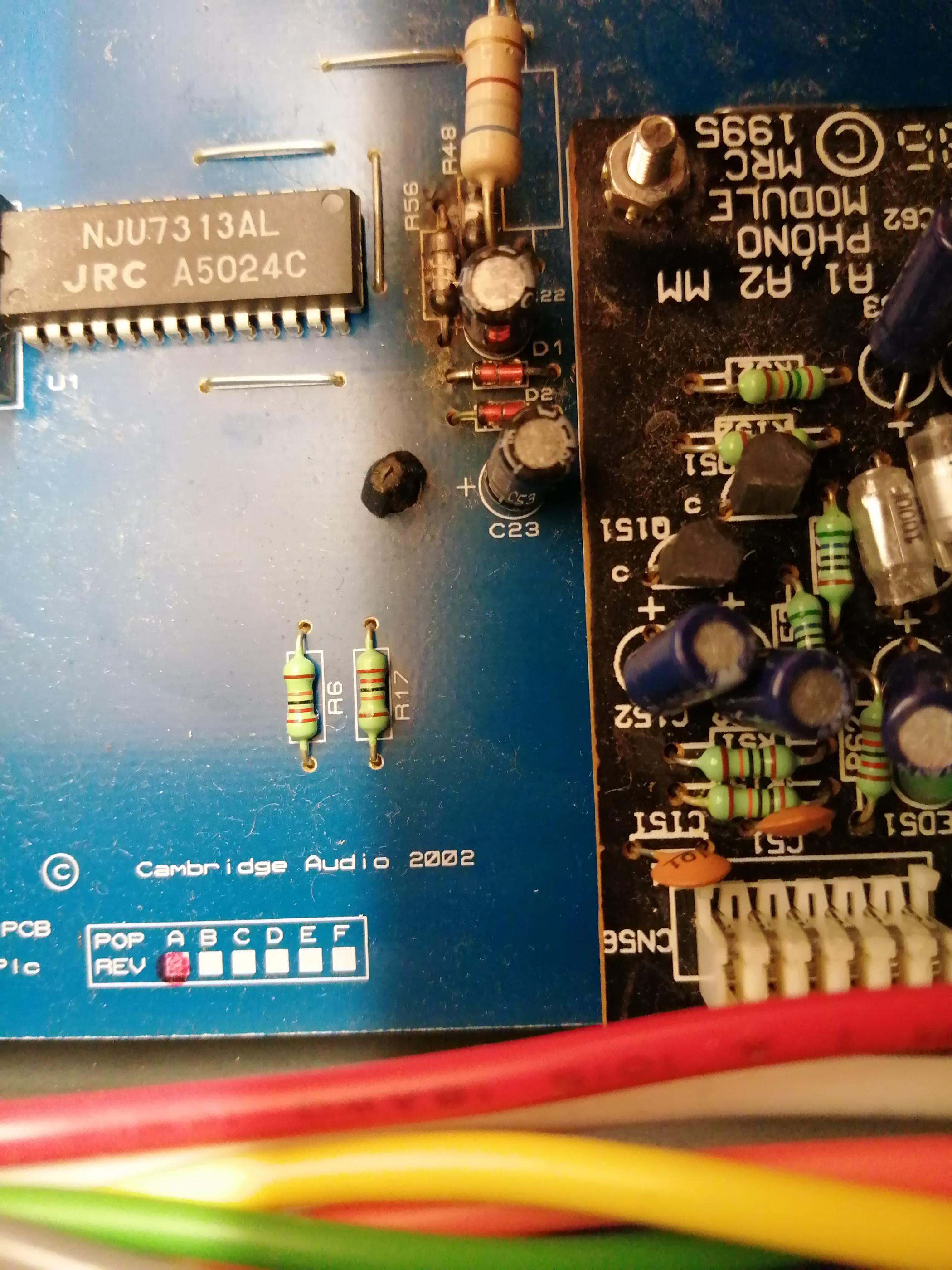

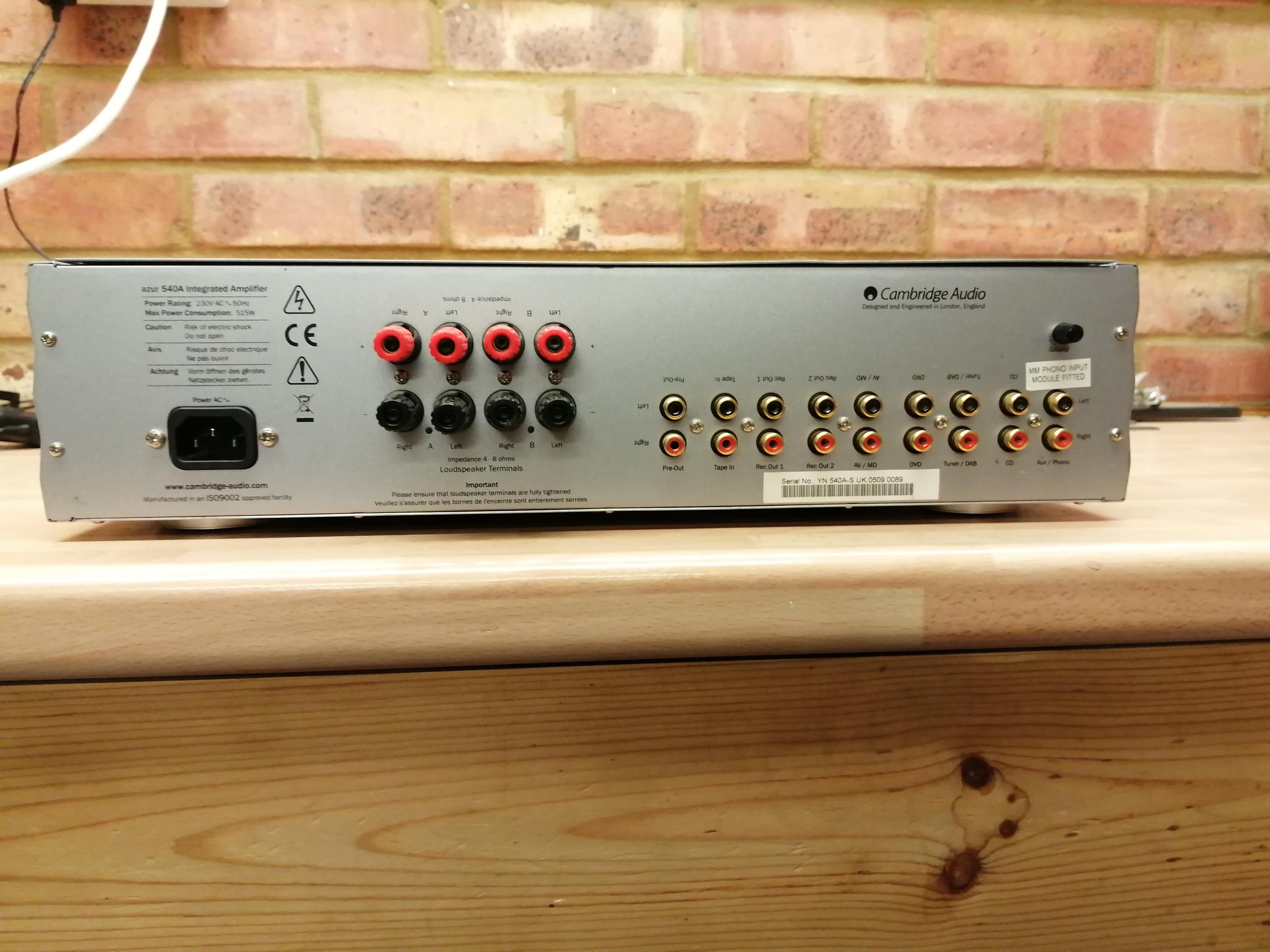

I have a Cambridge Audio Azur 540A Amplifier (recently bought), I'm not sure what version it is, but it has a fault. Where is the version written?
From what I can recall there's hardly any output through the speakers, whichever input is being used. More importantly R48 and R56 get "very hot", and are cooked - I think they may even smoke a bit. See attached picture.
I can't see what value they are, so if anyone knows I'd be grateful. I see further up this post it's recommended to get a higher wattage metal film replacements, so I'll make sure they are. Is it worth replacing anything else at the same time? I see other contributors have said it's a lot of work to get the board out, so would be good to do it in one hit 🙂

I've downloaded the manual on the link on this post and have the Cambridge Audio 540A V2 (31st March 2006) Service Manual.
If this manual is correct for the version of 540A that I have, then I think R56 should be 4.7K, and R56 560. Can anyone confirm this for me, before I order some and fit them. I've attached some pictures, to see if that helps identify that those values should be correct.

The burnt out resistors are both 100 ohm 1/4 watt metal film.
The version of Amplifier you have is V1.
You will also need to replace the input selection IC NJU7313.
Before installing the new IC and after replacing the resistors check you have the plus and minus 12 volt supply rails for the IC.
Connect the negative probe of your multimeter to any of the black speaker terminals and then measure the voltage on each end of the R56 and R48, the other end of the resistors you should read plus and minus 15 volts.

No there is no need to up rate the wattage of the resistors, they burnt out because the input selection IC has gone short circuit.
This typically happens when input leads are switched around when the Amplifier is still powered up.

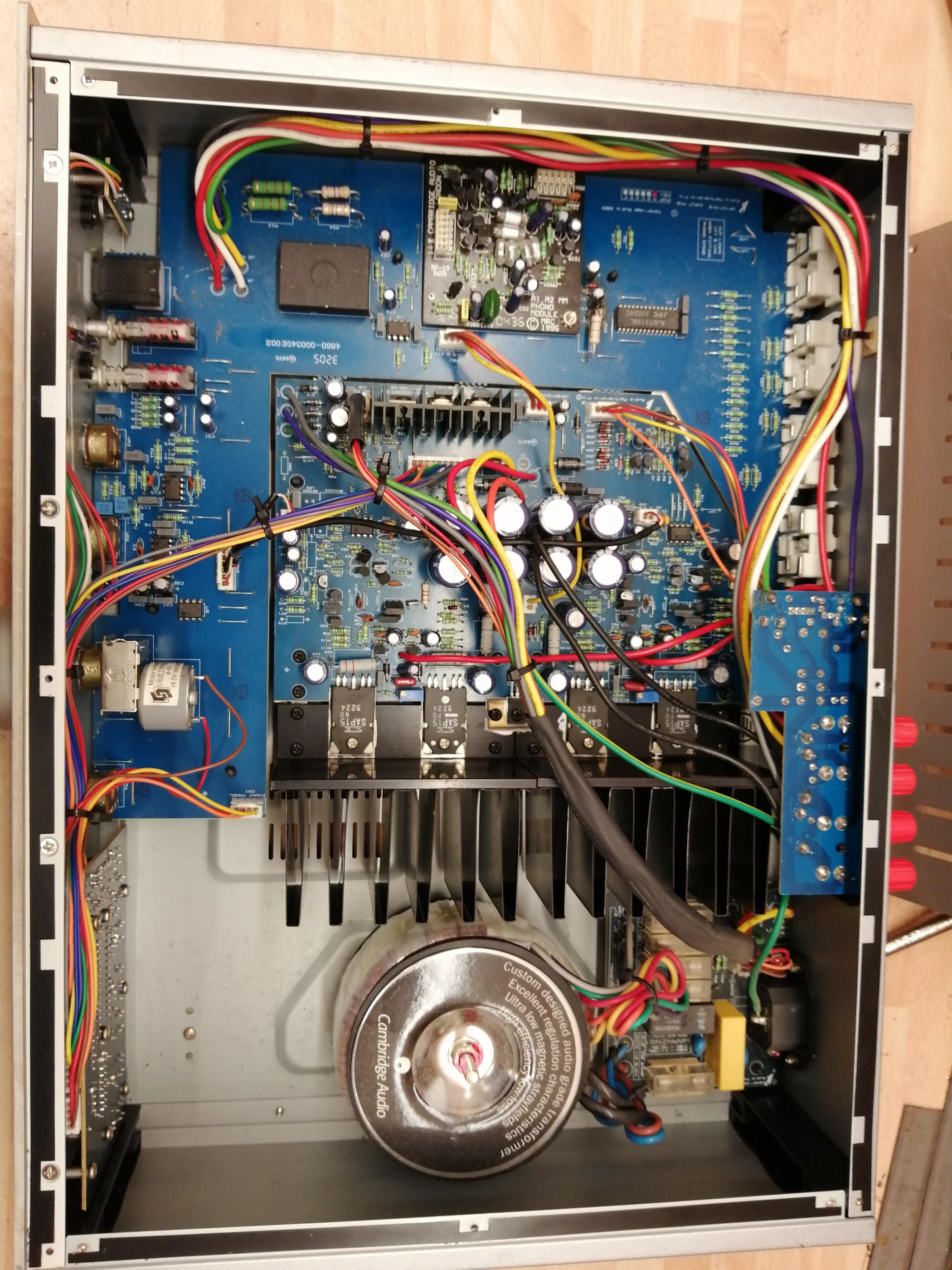

With power and top cover removed first make a visual inspection of the Amplifier main board the one with the heat sink.
Look for brown glue which may be covering multiple components, the glue will be near to the power supply smoothing capacitors.
There are also links near to the capacitors all the brown glue covering any components or links needs to be removed.
The glue becomes corrosive and conductive and can result in spurious operation of the protection system.

Did as above (on my Version 1, 540A), and happy days, all is well again. Just love this forum. Also when you've fixed something, firstly it feels like you've done magic, and then it gives you a real buzz - or is that just me?
Anyway, many thanks. Rob
