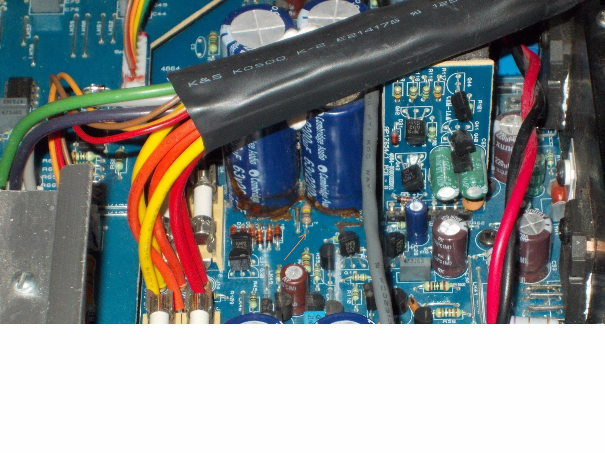

The curse of the brown glue.while listening music with my azur 640a v2 the protection light went on suddenly (short flash once, so dc-fault).
long story shortly told: the culprit was a small resistor (100k) close to the psu-elcaps
in brown glue............
foto with new res.

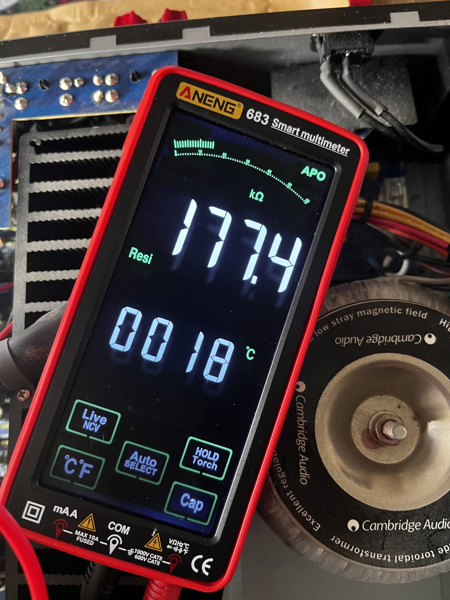

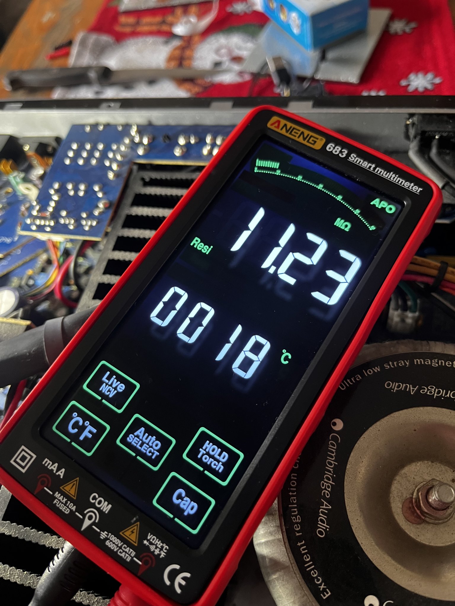

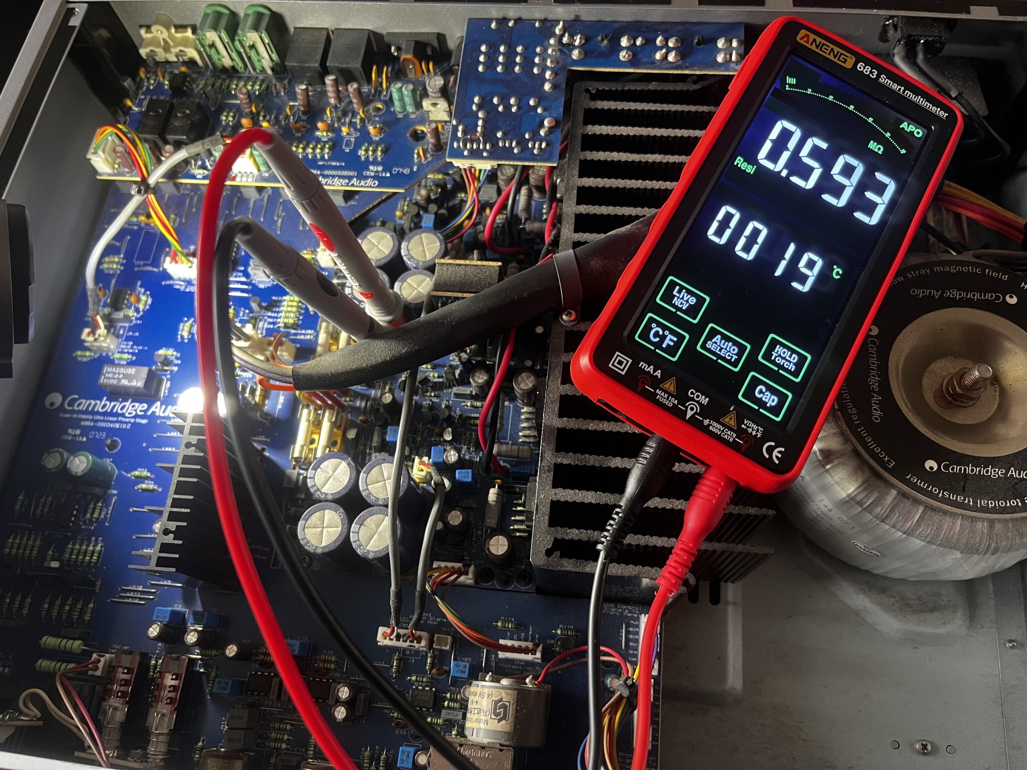

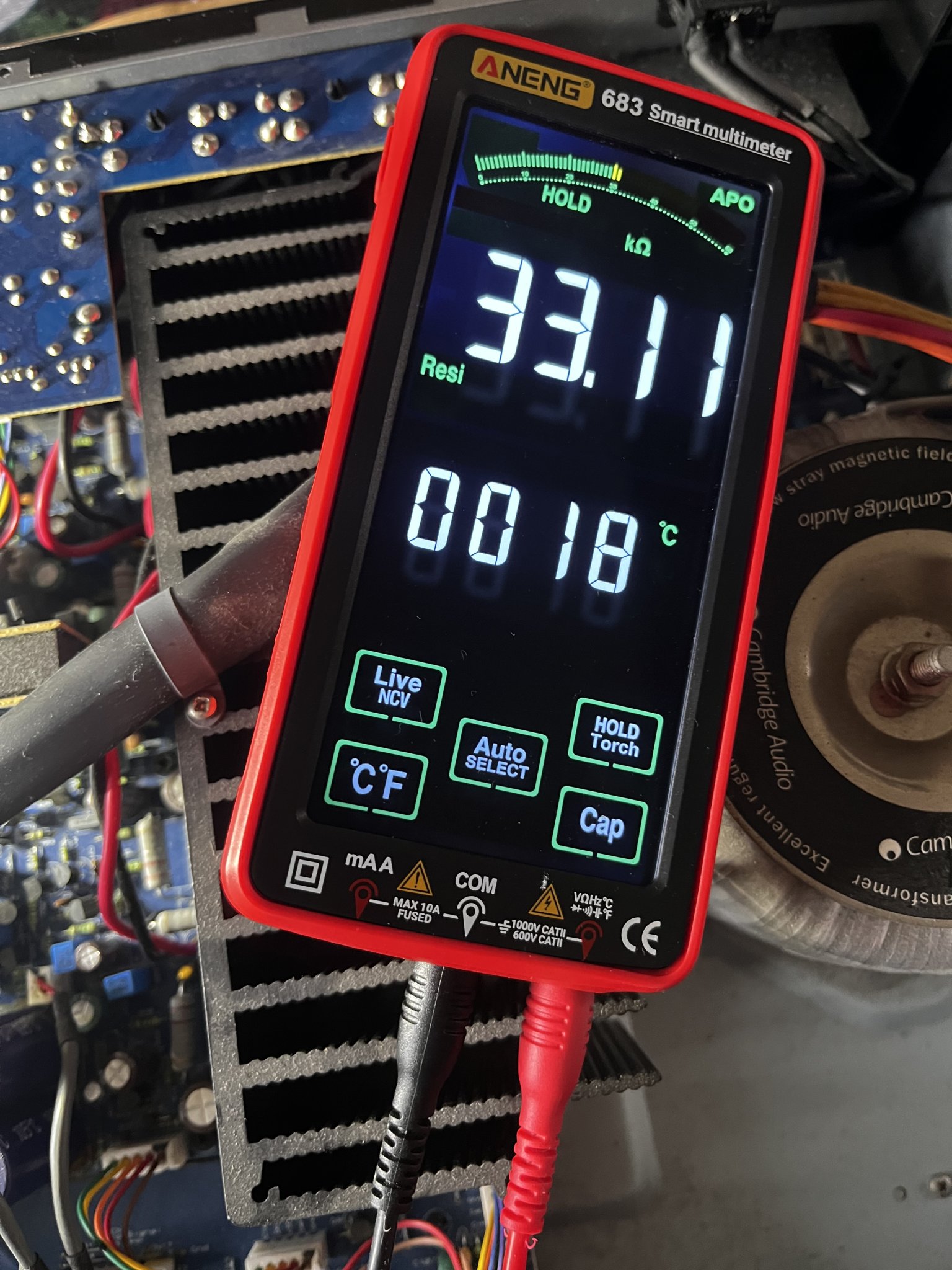

hello guys. I recently bought a Cambridge 640a v2 amplifier and I have a problem with a flashing diode. When you turn it on, you hear a click and after a while it goes into standby. the diode signal shows fault requiring service DC. I checked R42, I'm posting photos of the measurements.
it gives different values with each measurement, could this be the reason?
