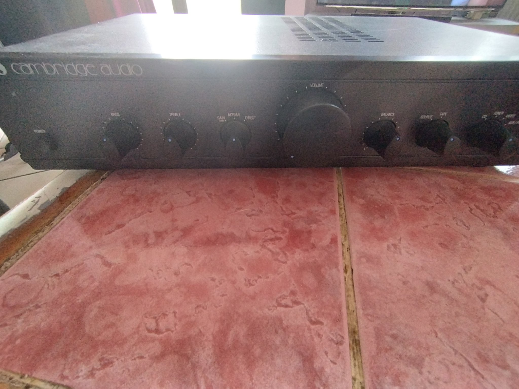

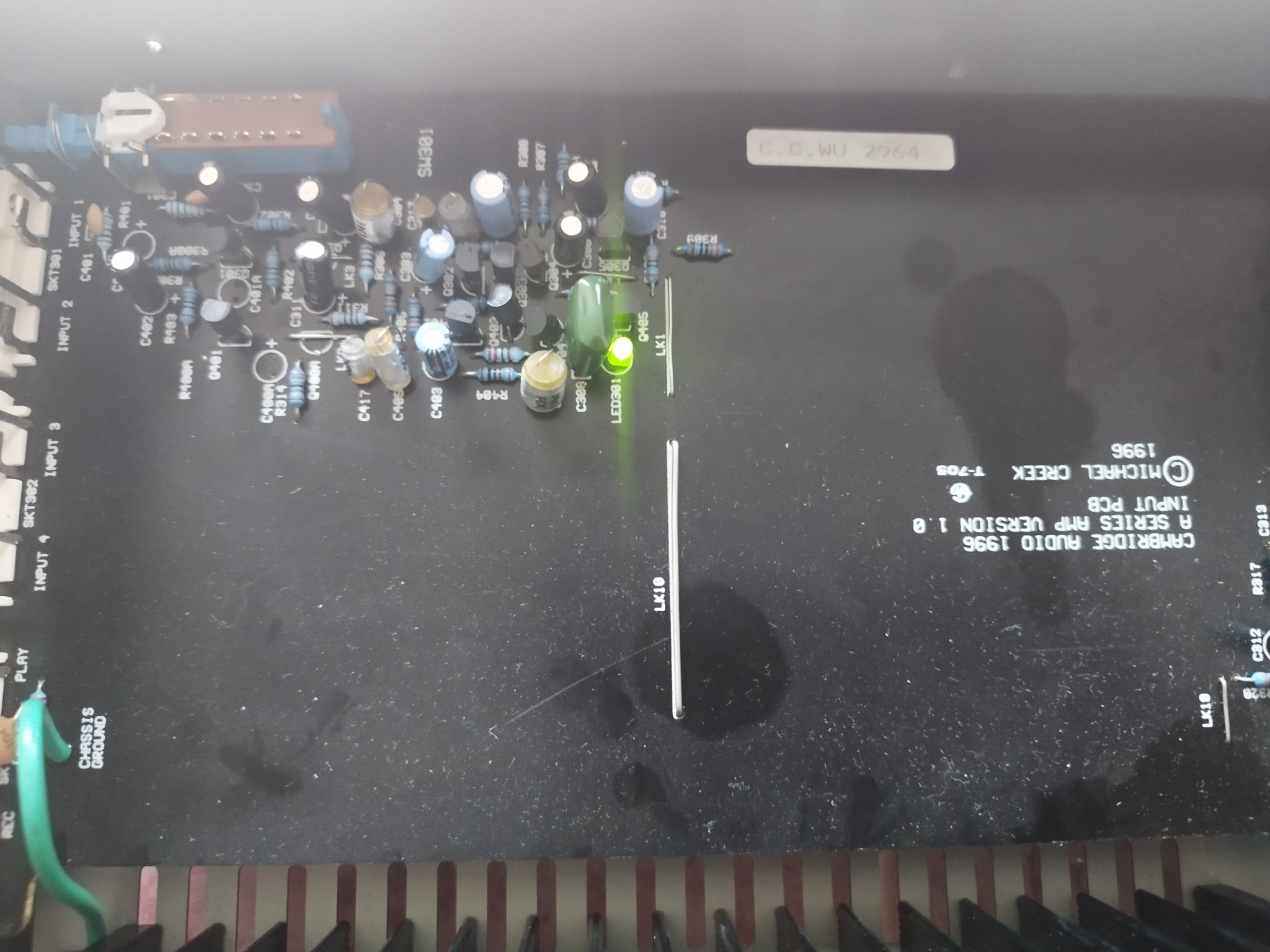

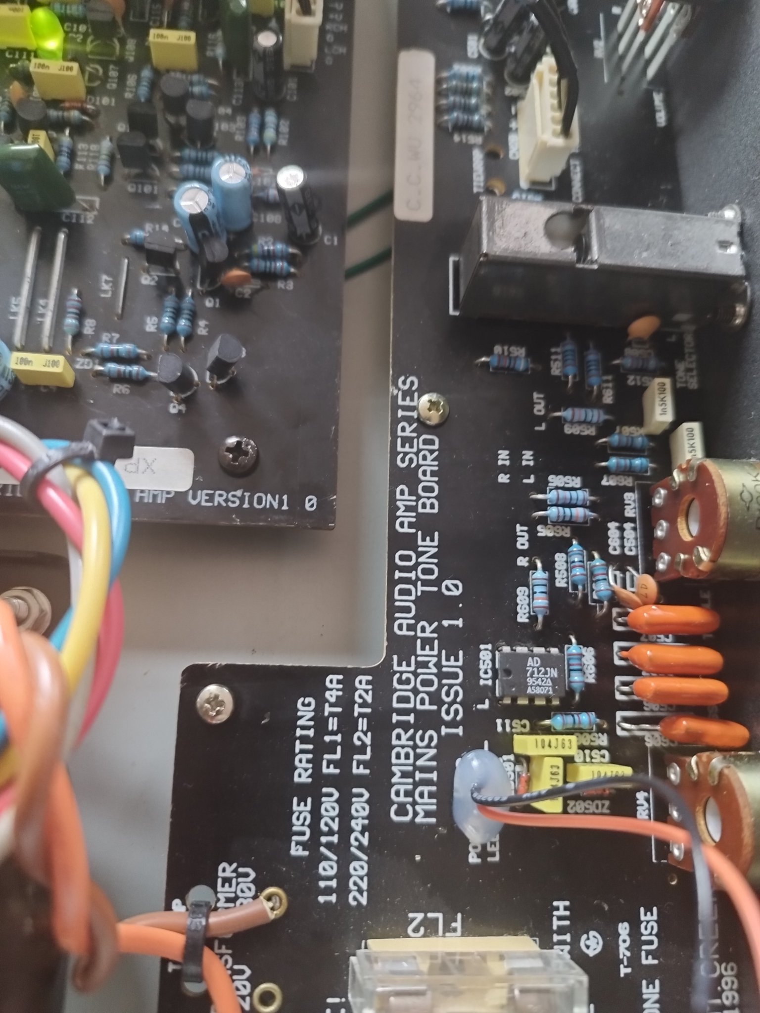

hello
I just got an A3i.
looks like it has never been used.
tested with mission mk 70 mkII, I love it.
infinity reference 21i, I like it a lot less.
I just find that the power supply makes a purring noise.
I will have to dismantle the pcb and check the solders.
Is there an order to perform to access it?
