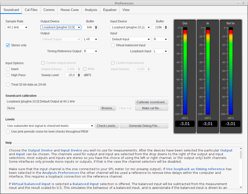

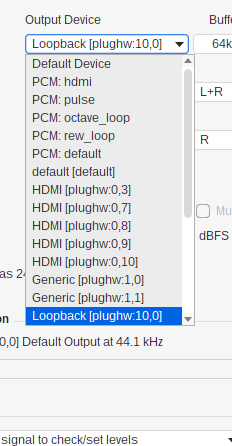

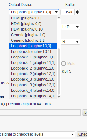

Do you really need subdevices selection? See my example - loopback works fine, just select the corresponding card->device (not subdevice). I have a few loopback devices and all are available in REW:
Also, newer REW supports alsa PCM devices, allowing you to define any device in your .asoundrc and use it in REW. Those devices are prefixed with PCM:

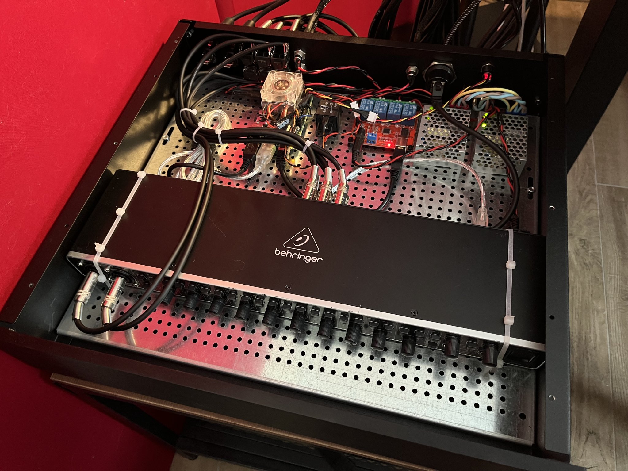

It works like a charm. 🙂
I use it with the plughw software interface and with an overclocked RPi 4 I am able to reach a really low chunksize (64 frames with the next20 version) with 2 in and 6 out audio channels.
