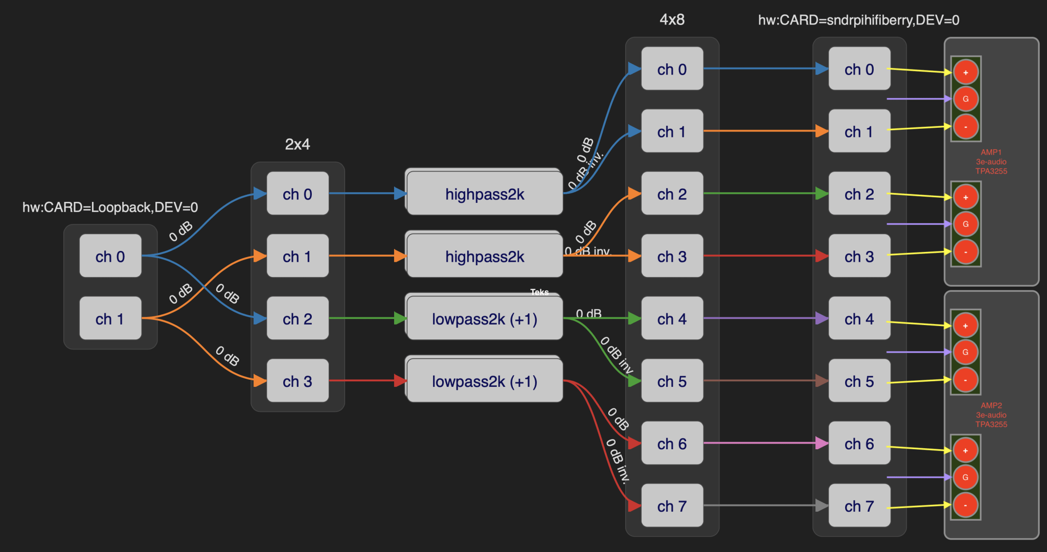

Hi everyone,
I'm considering a project using the HiFiBerry DAC8X, which features four DACs and eight outputs. My goal is to achieve a balanced output configuration, effectively turning the DAC8X into a 4-channel balanced output setup.
Specifically, I'm curious if CamillaDSP supports reversing signals to create this balanced output on a stereo DAC. I want to ensure that the signals can be properly managed to achieve the balanced configuration without any issues.
Has anyone here attempted a similar setup with the DAC8X or another multi-channel DAC? Any insights or guidance on configuring CamillaDSP for this purpose would be greatly appreciated.

Yes this will work just fine. Good idea btw! I would suggest to build a pipeline where you first prepare the four channels you want, and then add a mixer to add the additional ones. You can invert the copies directly in the mixer.Specifically, I'm curious if CamillaDSP supports reversing signals to create this balanced output on a stereo DAC
There won't be any delay!It can revers a channel but I think you will have a delay in this channel
Yes and yesI can't find anything in the documentation on the level detection of the limiter and compressor. Is the limiter a peak limiter and can the compressor be used as a RMS limiter?
I do something similar in CamillaDSP. I use bridged Hypex NC252MP amplifiers for my subs, this two input channels to each amplifier, one of which must be inverted. As I have enough DAC channels to do it, rather than use an inverted splitter cable I invert one channel in CamillaDSP, it works great.

Thank you for your replies! I actually figured it out last night 😁, but I haven't had the amplifier modules to test it yet. My goal is to build two-way speakers (clones of Buchardt S400) where each driver gets amplified from one channel of a stereo amp module (3e-audio TPA3255). This setup is similar to bi-amping/active but involves signal splitting using CamillaDSP.
The first amp will handle the highs (left/right tweeter) and the second will handle the lows (same left/right). I’ve been waiting a long time to get a proper 4-channel sound card. Initially, I started with two USB stereo cards, combining them into one four-channel output with ALSA. Then I switched to the Sound Blaster X3 but was still not satisfied with the sound quality (my reference was the RPi3 + Allo Boss).
Currently, I've been testing all the solutions on a cheap Wondom BDM8-A TPA3255, which has a single-ended input. Since I’m waiting for the new amps (3e-audio), I’ve been figuring out how to connect my new setup (RPI5 + DAC8X) to the new amp boards, which have balanced inputs. Now, my mystery is solved!
