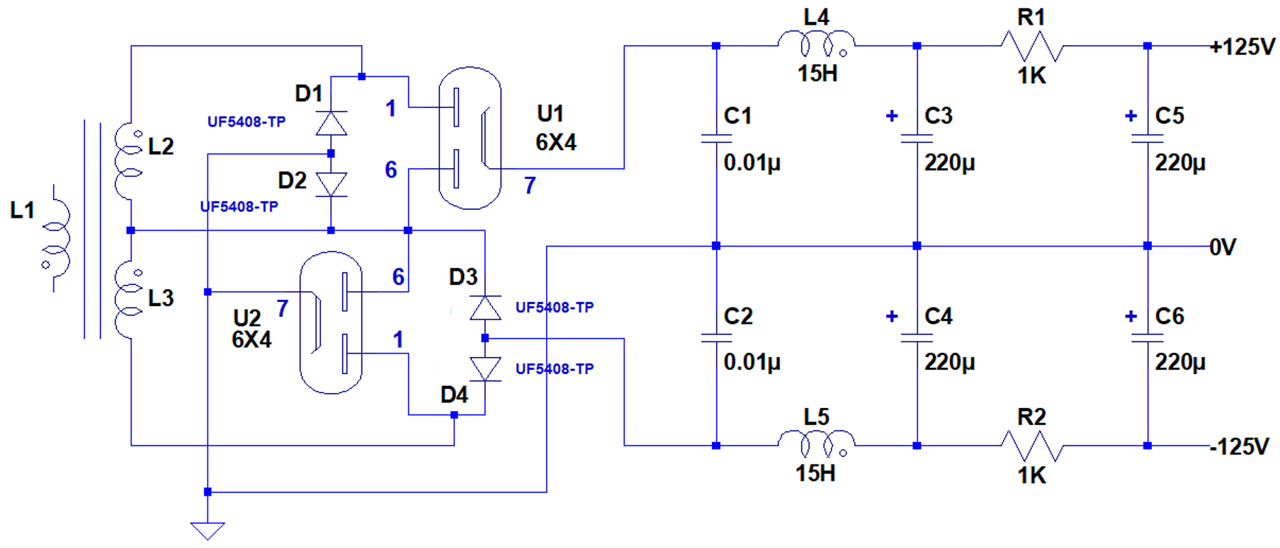

Can a pair of twin tube diodes be used to generate split rails?
There was no problem with the diodes.
After a lot of blown fuses the problem seems to be in using both windings of the centre-tapped transformer this way:

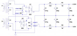

There's no problem if I use one of the secondaries of the second transformer like this:
I don't understand why but would love to know.
Before the fuse blew each time the output voltage would get up to about -5V. Maybe there's some insulation breakdown in the original secondary I was using.
I could try using both windings of the second transformer and see if I have the same problem.

It is bizarre and not easy to understand without being able to 'touch' it... I appears that there is a connection to 'ground' via the transformer centre tap?
Silly question again, with the split primaries, do you still get a negative output if you pull the bottom 6X4 (U2) out?
Be careful until you work out where the connection is/was. Even the scheme in #44 could fail if there is a centre tap to ground resistance...
I see a short as follows- When the top end of L2 is negative D1 is set to conduct. At the same time at the opposite and of the PT the potential has gone +ve so pins 1-7 of U2 will conduct thru to the CT of D1 & D2. A good path for lots of current.
If the fuse doesn't blow an alternate path appears in a similar way during the nexr half cycle of the supply.:)
Am I missing something??

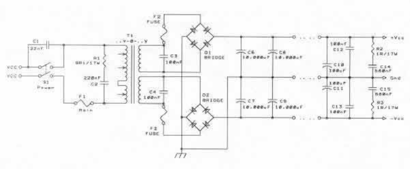

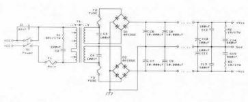

It does look that way but this is a standard configuration.

DOH!
You are correct, that's the problem. The centre tap shorts the two sections. You can only use that configuration with 2 independent secondaries...

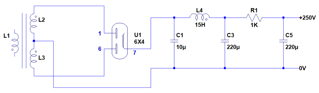

Looks like 250V at the output to the load, what is the load current?
Is the original really connected choke input?

The original 2 CLC filter power supplies, each of which looked like this:
each supplied 2 common cathode gain stages and 3 cathode follower filter stages for a total of approximately 10mA.

And 220 microF caps? Doesn't make sense in an old toob type cct. The 6X4 specs say 10uF max for cap in filter.
That would explain the 10uF capacitor at the output of the VRs in the original 250V supplies. My plan is to replace those with much smaller capacitors for switching transient filtering only to reduce the output voltage to 0.9Vin.
The 220uF caps are all glued into place so I might as well use them. There are an additional couple at the end of the umbilicals in the filter boxes. So, total of 3 220uF caps on each 250V supply.
