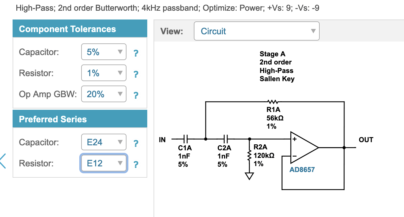

Virtuix Cad has fairly large OPA library.
Located in the library block.
It is incredible convenient.
Since it will place the whole circuit as a already assembled block.
You can Tune the block to your specifications.
Cutoff and Q
Then will generate needed resistor values
according to what value capacitor you want to use.
And what the needed Q is.
Assuming you will just be using standard Q values
Bessel = .5
Butterworth = .707
it is rather painless to design filters with it.
and pointless to use external calculators.
Since Virtuix Cad already contains a calculator
and numerous assembled blocks
just use board friendly cap values from
1n to 10n
and low noise op amp friendly resistance values
from 8 to 12k

Correct
And since you only need .5 Q
both capacitors and resistors will be equal.
Making the circuit a bundle of fun since both resistors are equal.
It is incredibly easy to make it a adjustable filter.
Which you could also predict with Virtuix Cad.
Using a common Dual Gang 10k potentiometer
Minimum resistor value is 4k with set resistors.
As you rolled up the resistance to max pot value
10k + 4k is 14k
14k with 10n is approx 1100 Hz
So it could be a adjustable filter from 1100 to 4000 Hz

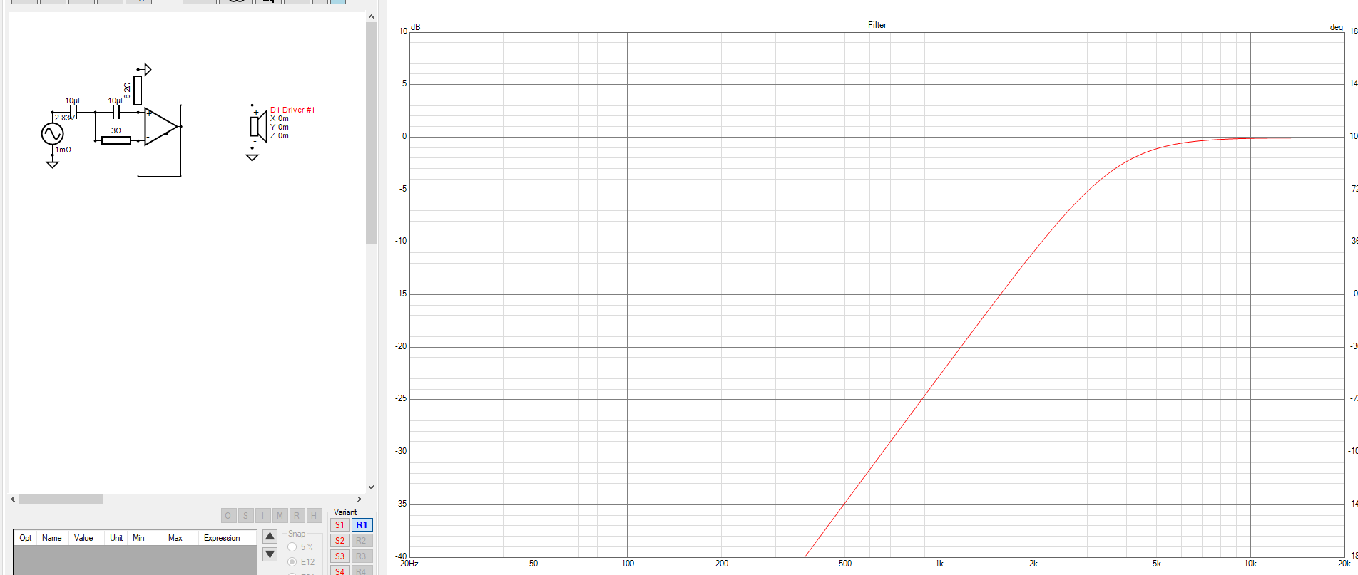

10k + 4k is 14k

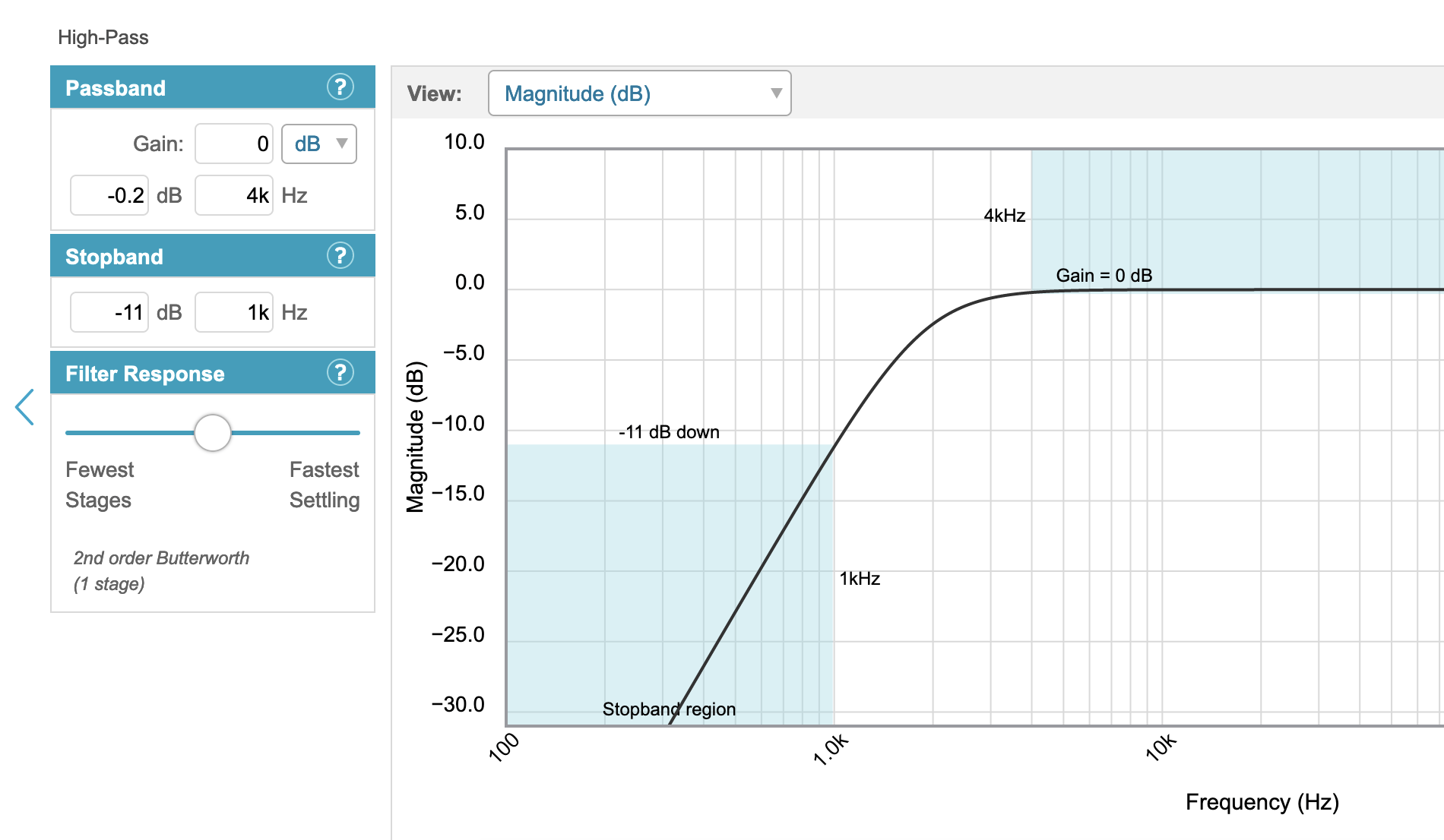

I wrote 1k to 4k adjustable
realize now it should have noted 1k to 4k is the filter cutoff.
hopefully not causing confusion for resistance value.
R4, R5 set minimum resistance value 4k for 4k filter cutoff
P1 at full rotation 10k + 4k for 14k
14k will yield 1.1k filter cutoff as shown in graph in post #26

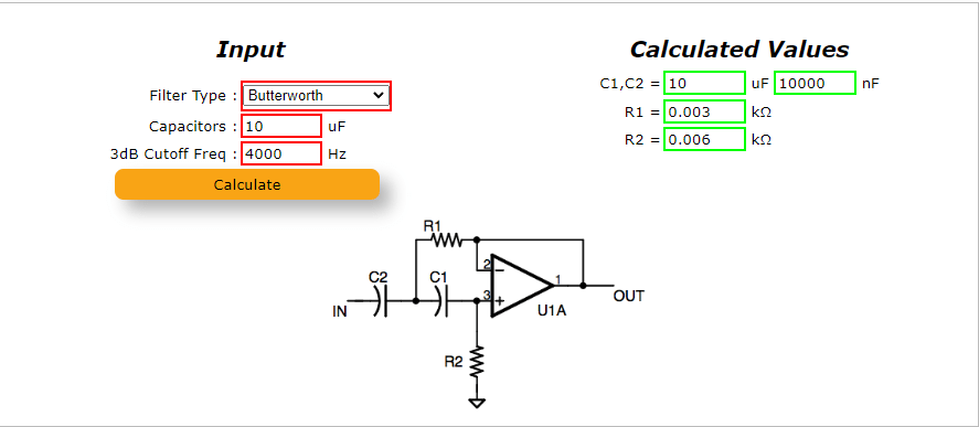

Really depends on the cutoff frequency you desire.and if I want to make a bandpass filter or low-pass filter should I also design with those cap values?
I just tend to use the smallest cap value possible
since they fit on the board easier and lower cost of course.
also as mentioned for low noise I like to keep resistor values
around 8 to 12k.
So again depending on desired cutoff frequency, I tend to play with
the cap value so the resistors dont exceed 8 to 12k ideally.
of course eventually depending how low the frequency is.
you will be forced to use larger capacitors. no way around it.
and the resulting resistor values as well can be higher than 12k.
also if trying to make a adjustable filter using common 10k or 100k dual gang or quad gang potentiometers
the resulting capacitor value will have to be necessary to achieve the desired cutoff.
