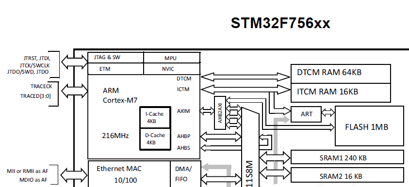

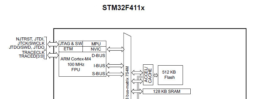

Hi JMF11,
Do you think STM32F4 is enough faster to run convolution ?
I started to use a Linux machine to interface with the stm32, instead of the windows machine... and it behaves differently. I now can get shorter or longer USB frames according to the feedback I provide.

If convolution is the primary function you're wanting I'd not choose the ARM M4 as its not really optimised for that (convolution in my understanding is a long FIR filter). It doesn't have the architecture for efficiently running FIR filters - it can manage the multiplies well enough but not the parallel data moves. That's not to say it can't run them but you won't approach the performance of a dedicated DSP at the same clock rate.
Hi abraxalito, a trivial 102-tap FIR filter routine could be something like this, relying on the MADD instruction and the HILO register pair. It needs to run each time there is a new audio sample available.
"Cxxx" are the FIR filter coefficients (possibly from Flash memory)
"Sxxx" are the consecutive audio samples (from RAM)
"Sout" would contain the resulting filtered audio sample
The "Cxxx" coefficients shall be read using a pointer incrementing from 0 to 101.
The "Sxxx" audio samples shall be read using a pointer implementing a circular buffer, having a depth of 102.
Upon completing the FIR filter routine, the coefficients pointer shall be reset, and the audio sample pointer shall remain as is.
Each MADD instruction executes in 10 nanosecond or so.
Ask yourself if this is for multiplying and accumulating two 32-bit data words already sitting in the required ALU registers, or if this is for multiplying and accumulating 32-bit data words possibly sitting in Flash or RAM.
Imagine the data and the coefficients are in Flash or RAM.
Imagine there is only one data bus between the Flash/RAM and the ALU.

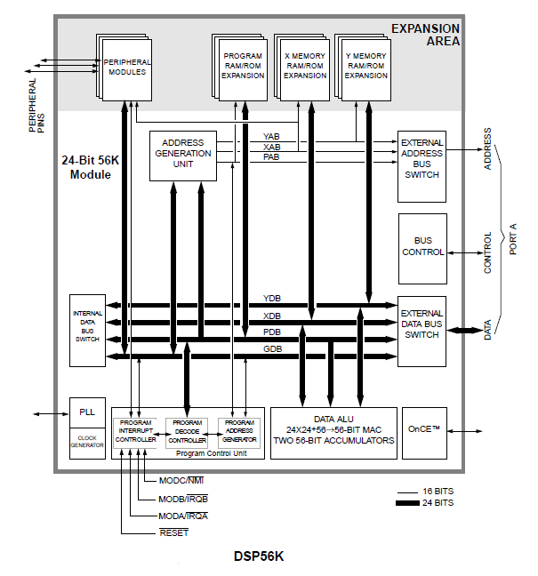

Many Digital Signal Processors feature :
Consider the STM32F7 architecture : the ALU embeds 4 KB of I-Cache memory, and 4 KB of D-Cache memory, and is tightly coupled to 16 KB of Instruction memory (ITCM), and 64 KB of Data Memory (DTCM). Once the instruction and data are in cache, the AHB bus-matrix gets out of the way. I don't know if the MADD instruction can have one operand in D-Cache, and the other operand in DTCM, enabling the two operands to converge to the ALU, in parallel.
Consider the DSP56K architecture : the ALU is tightly coupled to the Program Data Bus (PDB), the X-Data Bus (XDB), and the Y-Data Bus (YDB) using three busses operating in parallelism. The two operands of the MACC instruction converge to the ALU, in parallel (DXB and YDB). At the same time, the ALU fetches the next instruction, thanks to the Program Data Bus (PDB).
IMO, provided you have some luck with your Assembler or C compiler, you could persuade a STM32F7 to behave like a decent Digital Signal Processor. Possibly you'll miss the pointer auto-increment feature. Possibly, a practical FIR filter tap for audio, dealing with 32-bit audio data in RAM and 32-bit coefficient data in Flash, could execute in three clock cycles. Add another 30 cycles for managing the circular buffer and for formatting and storing the filtered audio sample. Say the clock is 200 MHz. A 512-tap FIR filter could thus execute in 2.8 µs. At a 48 kHz sampling frequency, the audio samples occur each 20.8 µs. We can thus execute up to six 1024-tap FIR filters, enough for implementing a linear phase stereo 3-way crossover having a frequency resolution of 94 Hz. At the moment, I don't know if this is sharp enough for a bass/mid crossover operating at 300 Hz.
Wondering if you could take some time, verifying this.
In Assembler, or in C?
- a way to auto-increment a pointer,
- three independent data buses, three independent RAM planes for simultaneously reading two new operands and fetching a new instruction,
- a zero-overhead loop arrangement in case of tight loops, more efficient than unrolling the code.
