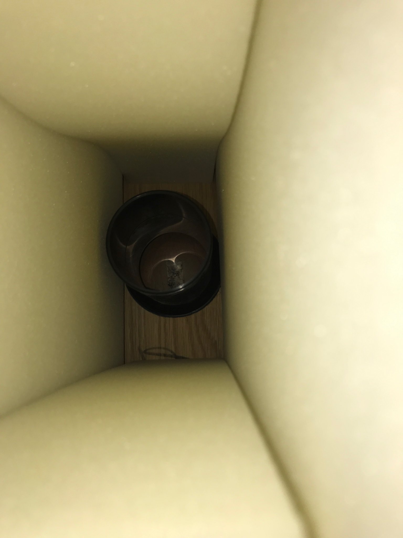

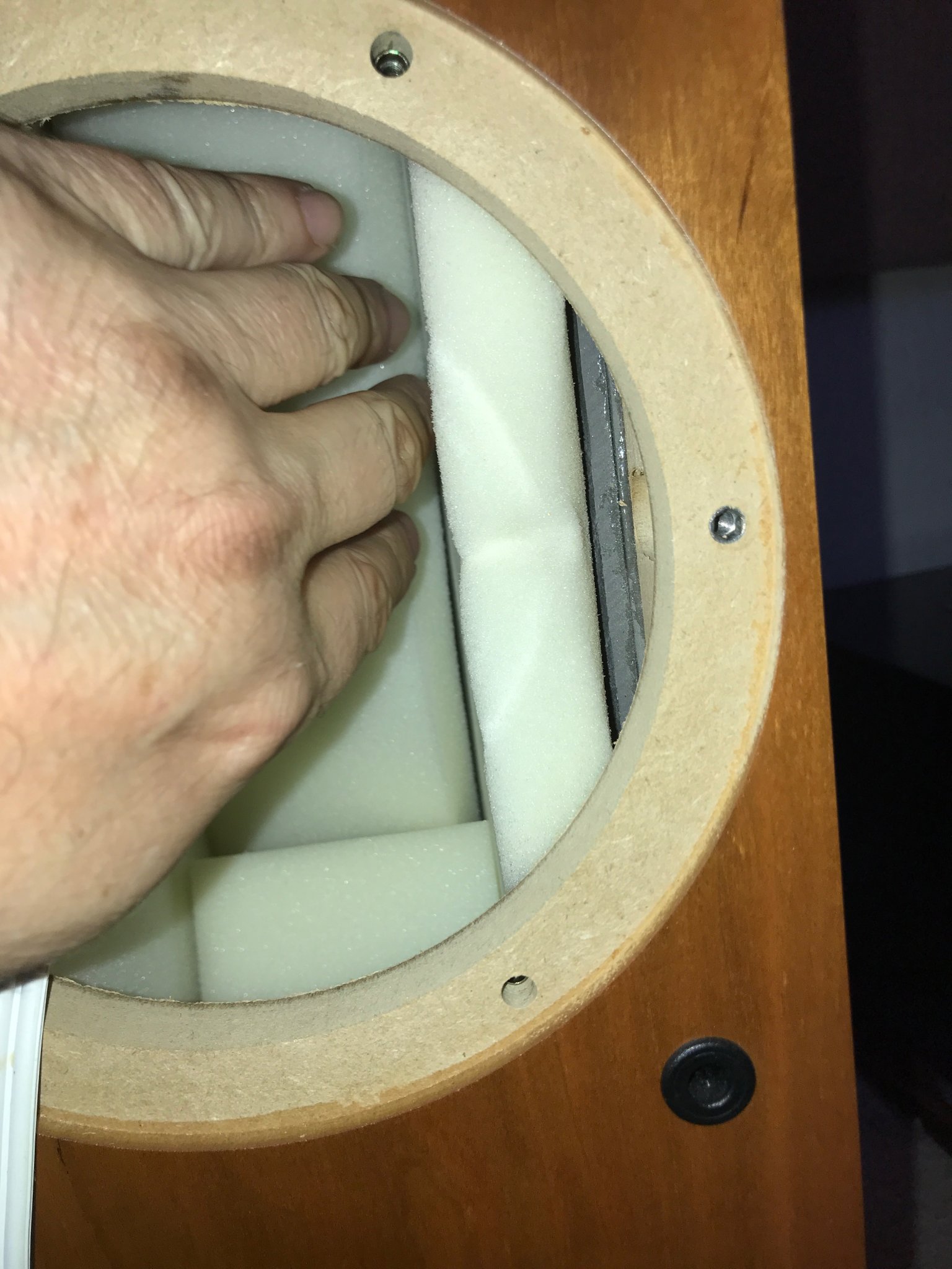

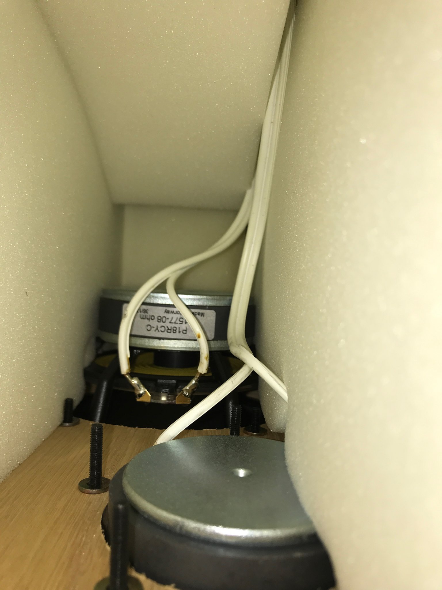

this is what I’ve got so far on hand.
they are a pair of Proac DT8
Pull the foam out?
I don’t find foam very good for damping. You can play with that as well. Usually in a BR you do not want so much.
SEAS woofer. 5.25”? Tweeter too? Looks like it could be one of the nice 19mm units.
The vent is out the bottom? If it is these are ML-TLs and not a reflex and they require from lined to fully filled depending...

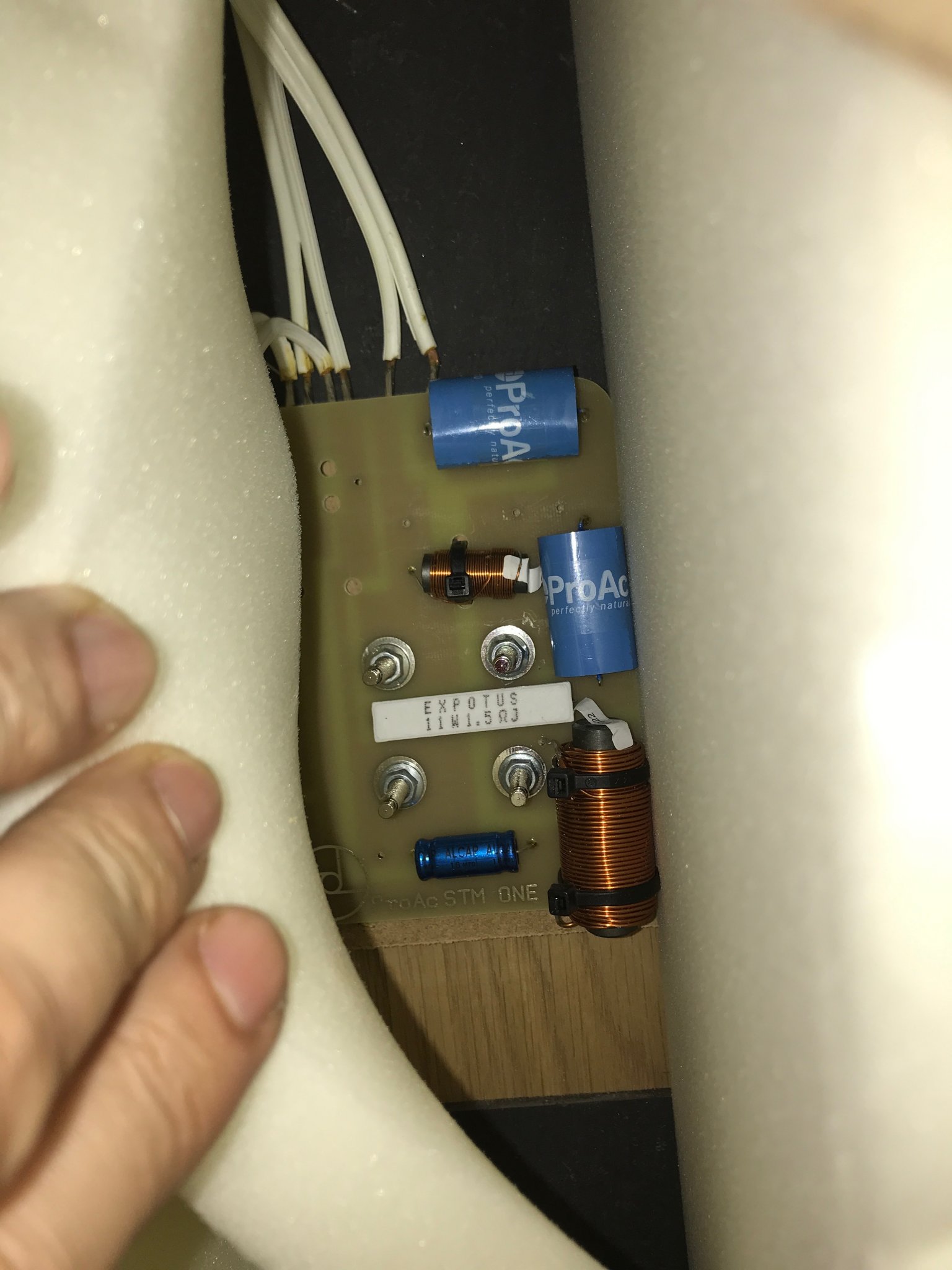

Crossover?
Given the high aspect ratio, simple crossbraces form side to side and the end-on strips down the length )not sure how long you sre going to be able to feed thru the driver hole.,

both are SEAS 6.5” woofers. Made for Proac.
i emailed SEAS for their specs but they haven’t got back to me. Doubt they would give me the specs anyways.
the tweeter is a scanspeak https://www.scan-speak.dk/datasheet/pdf/d2604-830000.pdf
port is down firing.
this is the crossover.

Just looking at that XO I have a feeling that these are not a 2-Way but a 2.5 iteration, that would make better sense of the different woofers.
Not really possible to tell without a circuit diagram
