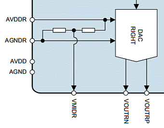

I'd like to try that approach on a WM8741 DAC. But it is not quite clear to me how to connect to such:
I’d check first to make sure the voltage at pin 11 and 18 is half of AVDD.
Remove C9 and C10 (they are most likely 10uF). Solder 0.1uF SMD capacitors in their place – you can get the npo’s at this capacitance but you’ll need to look hard. Make sure they are properly soldered at both ends so that they won’t be susceptible to any mechanical resonance; place them as close to the IC as possible. Note: these capacitors are actually a part of a Vref Generator (C6).
Then, fire-up the Vref Generators and ensure their output is the same as “half of AVDD” – see the first sentence above. The schematic posted by JohnW is for a Vref voltage tuned to 2.5V value.
Feed the 5534 out (from a first Vref Generator) to pin 11. Via a SEPARATE wire, connect the same pin 11 to 5534 INV input. I’d use short, solid core pure copper wires for this. Do not just bridge 5534's OUT and INV pins!!
Repeat for pin 18 with a second Vref Generator.

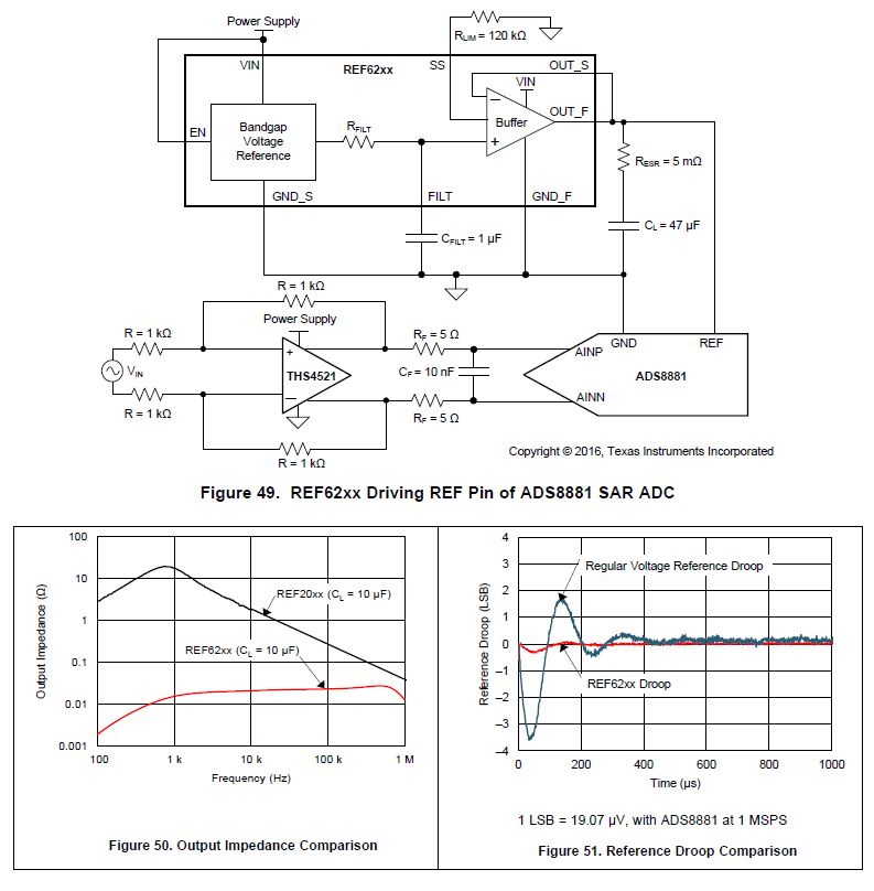

The VGen idea is very interesting and I intend to use such voltage reference in my DAC. But I want to use less noisy circuit. So, after few days of searching proper solution of the voltage reference for WM8741 I found Texas Instruments' chip: REF6225.
It has:
- Temperature Drift: 3 ppm/°C (max) from 0°C to +70°C
- Output Noise: 5 μVRMS with 47-μF Capacitor
- Integrated Drive Buffer
– Output Impedance: < 50 mΩ (0-200 kHz)
- Supply Current: 820 μA
- Initial Accuracy: ±0.05%
- Output Current Drive: ±4 mA
I have just drawn a schematic of the VRef. My DAC will have a dual mono setup so I use four such voltage references.

Why don't you just use LT3042? Or am I missing something?
T
That seems a good idea. It generates less noise than many references. Less parts, cheaper and smaller.

I use REF6225 Texas Instruments because the IC is High-Precision Voltage Reference included driver buffer in outputs. It has one important feature: nearly flat output impedance less than 50mOhms in range 100Hz - 1MHz with single small capacitor. Look at the diagram of output voltage drop comparison, too.
Suggested LT3042 has lower output noise but unknown output impedance.

Hi Jean-Paul
I agree. Less parts thanks to integrated output buffer. Applying standard reference source it would be necessary to use second IC: output buffer and few other parts (caps, resistors).

3045 has exremly low output impedance acording to specsheet. You could place 3 or 4 ICs in parallel with exceptional results. I do not use 3042’s
I read LT3045 datasheet but cannot find output impedance value. I choose REF6225 because I have not spare rooms near the DAC chip. My idea is maximal condensed of parts and short traces between them. So 3-4 LT3045s and few RsCs around each regulator will take more room on PCB and make traces longer than using single REF6225.
But your suggestion is very interesting. Maybe I will use the LT3045 to supply VCXO clock.
