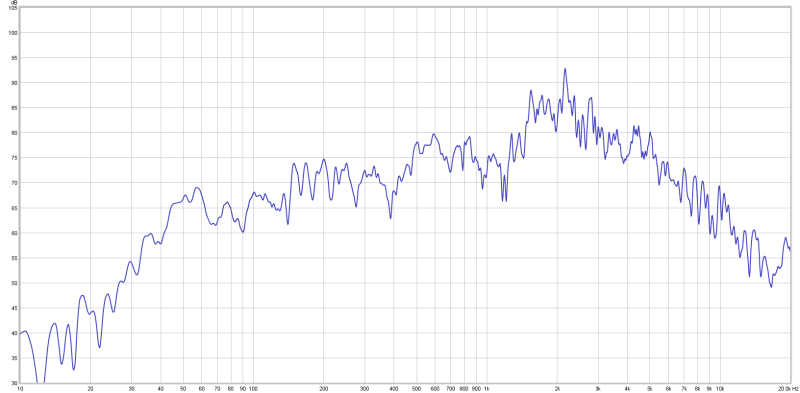

Panel response
Signal chain to panel:
- HDMI output from GeForce graphics card
- To Magnavox LCD TV
- Out the TV's SPDIF output, to a Behringer Ultragraph DEQ1024 (everything flat, just used as a DAC)
- To a Yamaha P2700 power amp, with the volume set to about -19dB.
Measurement:
- Lexicon Omega SV USB, channel 1, volume all the way up in both hardware and software
- Dayton EMM-6 measurement mic, with calibration (can't remember where I got it, must have been from Parts Express I guess, if that matters in terms of who would've provided the calibration)
The graph below doesn't capture that the output sounded pretty smooth except for a nasty resonance somewhere in the midrange I would guess between 500-1000Hz. I couldn't tell if that was panel self-noise or, maybe more likely, the ragged edge of the aramid honeycomb scraping against the pillow that I've got the panel set up on.

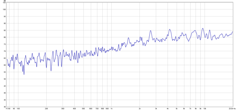

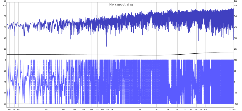

I might be measuring something incorrectly. The phase, impulse response, group delay and distortion are unintelligible. I get similar results measuring my sub, so I don't think it's the general difficulty of measuring DMLs with conventional methods that some papers point to.
There's a fair amount of fan noise from my amps that are sitting out in the middle of the room right now. Would that do it?

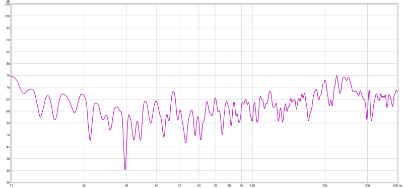

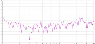

Here's my measured sub response for a PPSL, 12x16x38.5" sealed enclosure, 2x GRS 12-SW4 drivers:

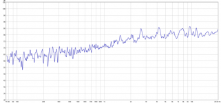

Yeah, they were faulty. I didn't realize that REW distinguishes whether you're measuring *from* the right or the left "channel", a notion that doesn't even really make sense to me when we're talking about mono mic inputs. The previous graphs were showing whatever noise happened to show up in the other idle mic input, I think.
With that fixed, it looks like response is pretty good from around 60Hz - 5K. Maybe Tectonic is onto something with adding ribbons.

Wonderful to see data. That's the way to go!With that fixed...
Ordinarily, you'd want 1/12 smoothing (as a good compromise value).
And you need to specify the distance (with your listening chair as a good choice since REW records the initial sound and less so the reverberation in the room).
Of great importance (in light of the poor results in the other thread where a home-brew poster-board DML is tested), it to display the distortion (total THD and maybe 2nd and 3rd harmonics). Just a matter of clicking "Distortion" in REW and you get it clear as day based on your last run. Failing to post the distortion - which is so easily posted - might possibly expose you to critical comments, eh.
http://www.diyaudio.com/forums/full-range/272576-study-dmls-full-range-speaker.html
It's hard to specify loudness. But we can take for granted you are testing at a level comparable to listening level?
Your mic doesn't need a correction table since it is plenty good enough raw. But for your own peace of mind, always good to run a loop (the system without the acoustic part of the loop) in order to be sure all the electronic and software elements are flat and clean.

That result is shown a plate that damps to hard or the most Likly,not rigid enough from front to back, exciting the backplate in the higher frequencys will not get trough the core material to the front plate. Try using it the wrong way around exciter facing you, it will confirm or disconfirm the core being the problem. If the problem persists it could be it damps to hard.
What I did was using a stiff paper directly on the coil as a tweeter that excites the panel. It is a bit like a whizer. My tiny panel went to 17-18 kHz down to 300 , the whizer should be rather stiff since it still has to excite the panel for the lower end of the spectrum
