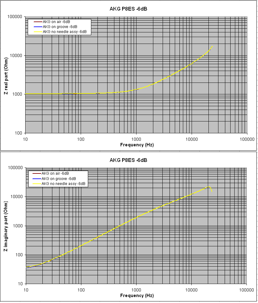

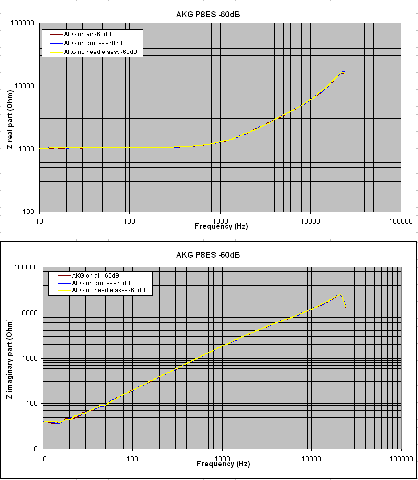

AKG P8ES impedance

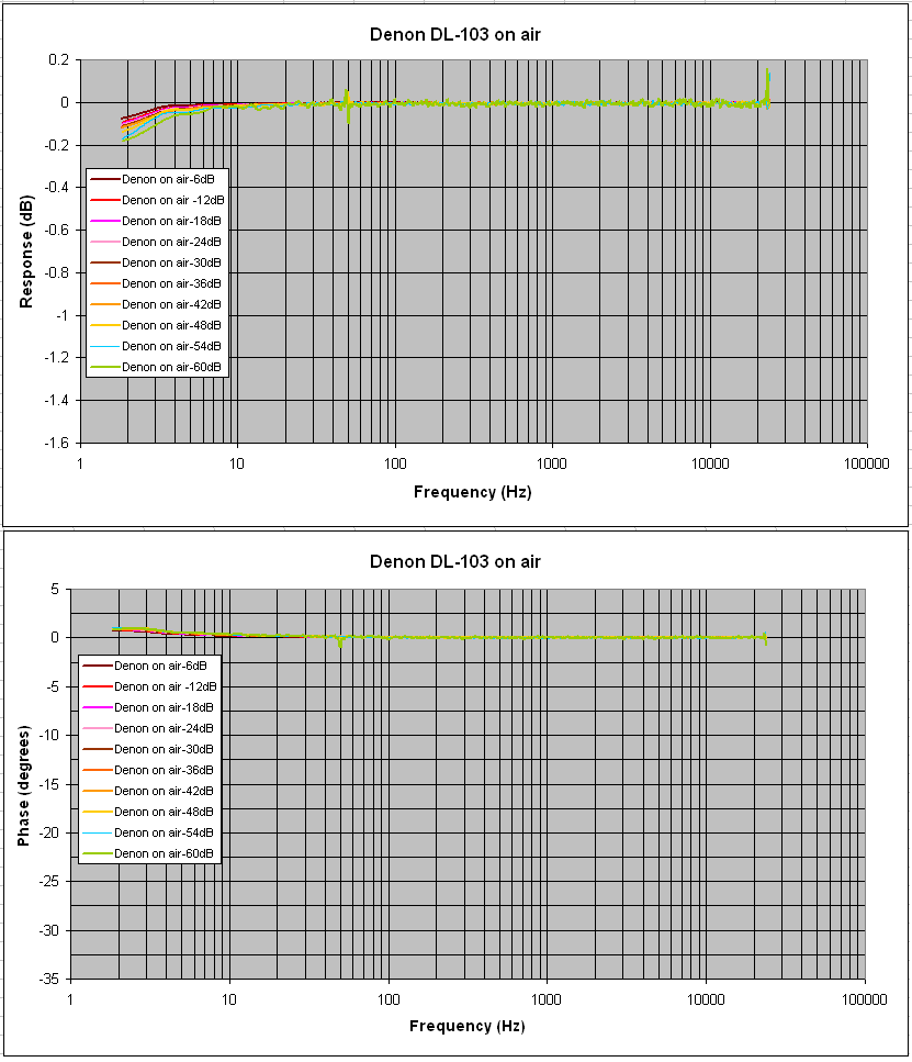

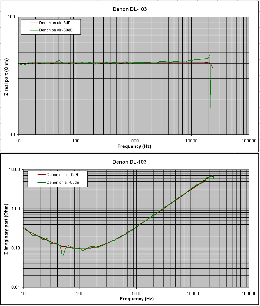

DL-103 with broken cantilever.
Impedance test

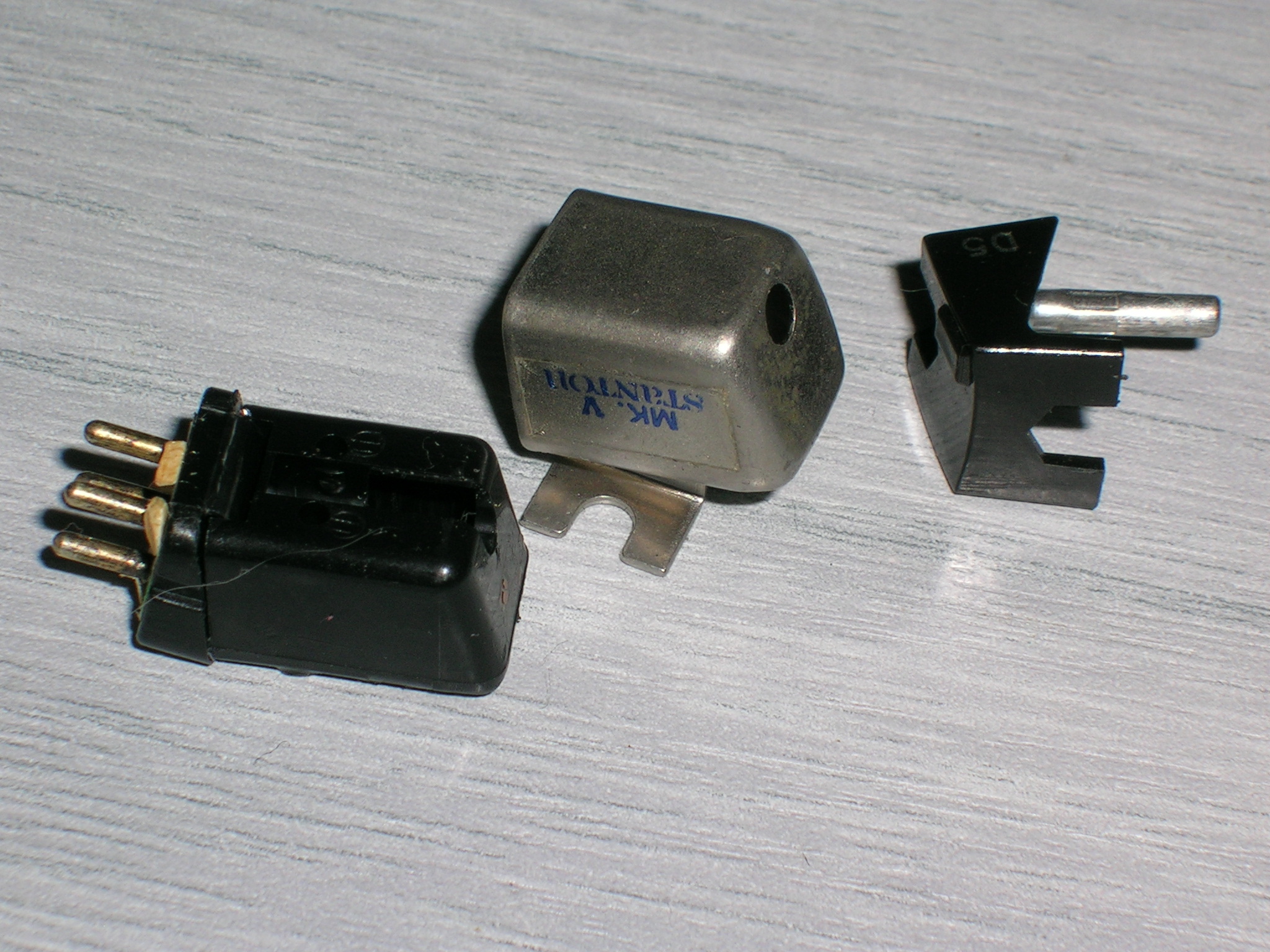

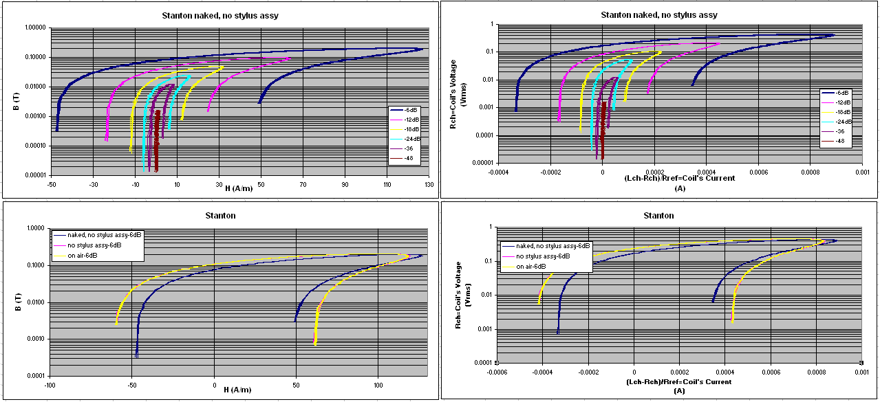

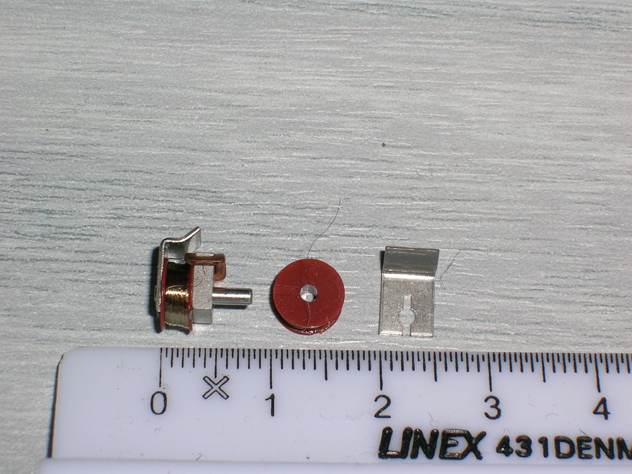

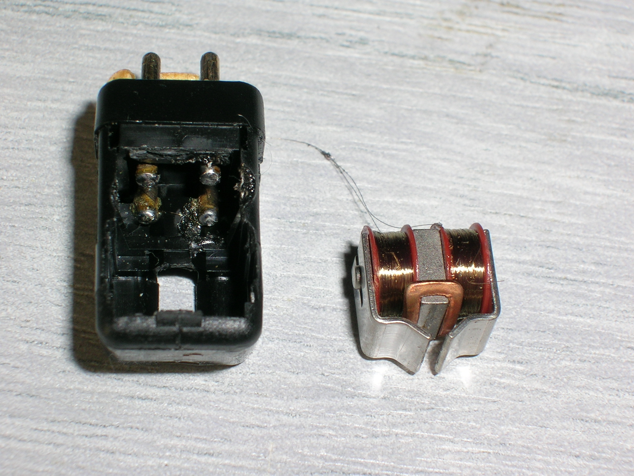

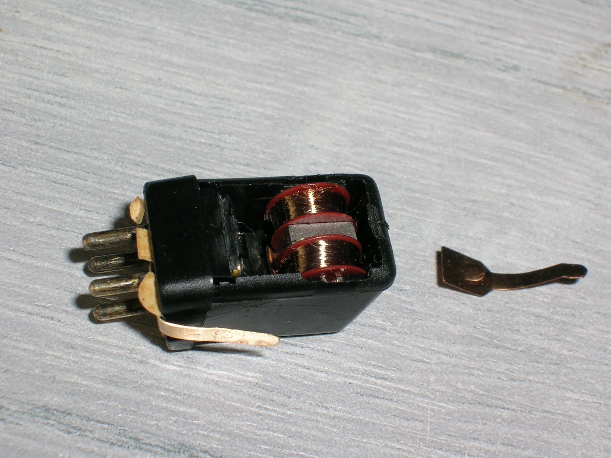

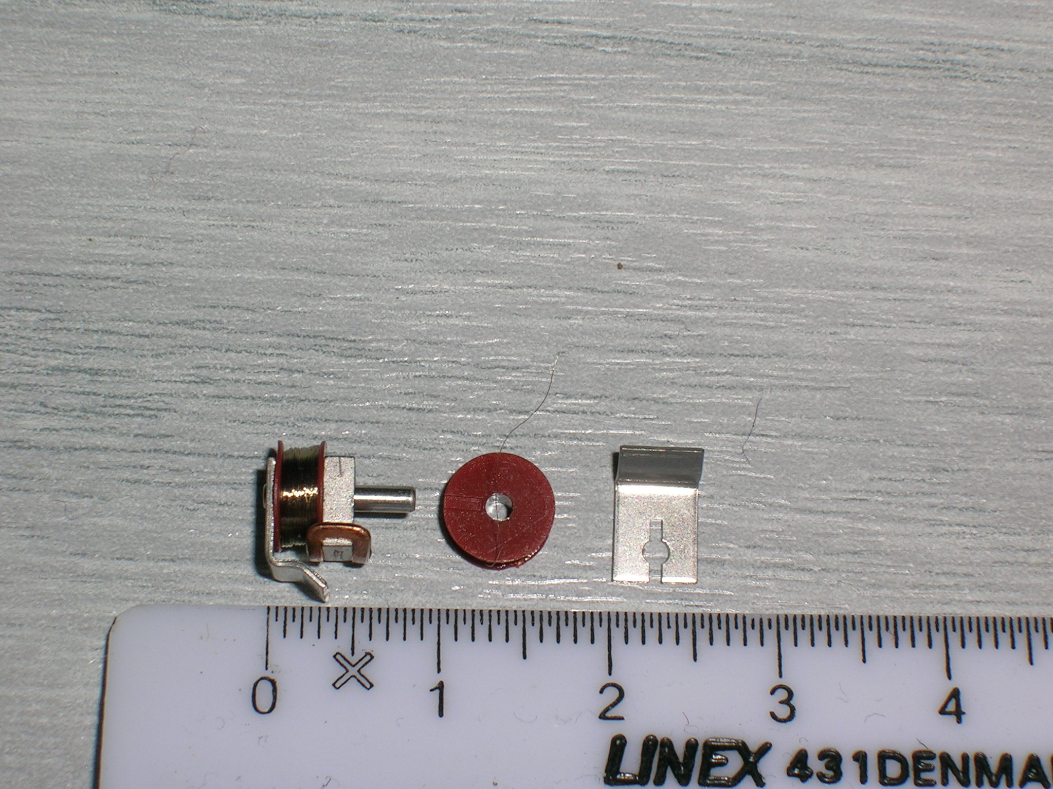

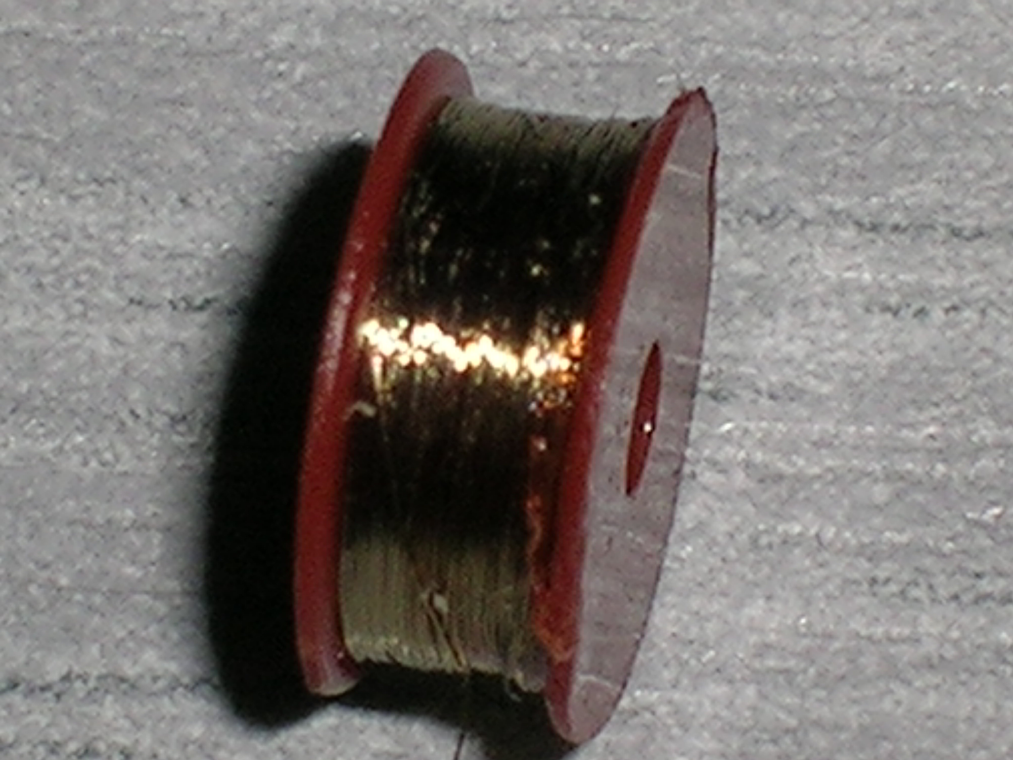

I dissected the body of the Stanton and took a few dimensional measurements with a caliper.

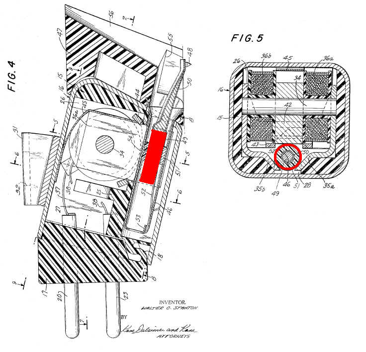

In one of Walter Stanton’s patent (US 3297831) my Stanton MK V is described in detail . So using the sectional drawing and the measurements, I have a rough idea of the magnetic motor structure.
Coil Outer diameter: 6.16mm
Coil inner diameter: 2.08mm
Coil height: 1.88mm
Wire diameter: 0.04mm
Coil turns ~2500
Magnetic path length :0.0176m
Magnetic core cross section: 0.0000016376sq.m

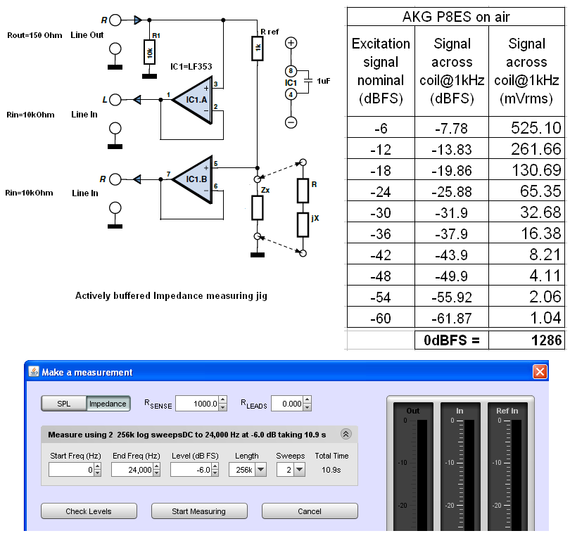

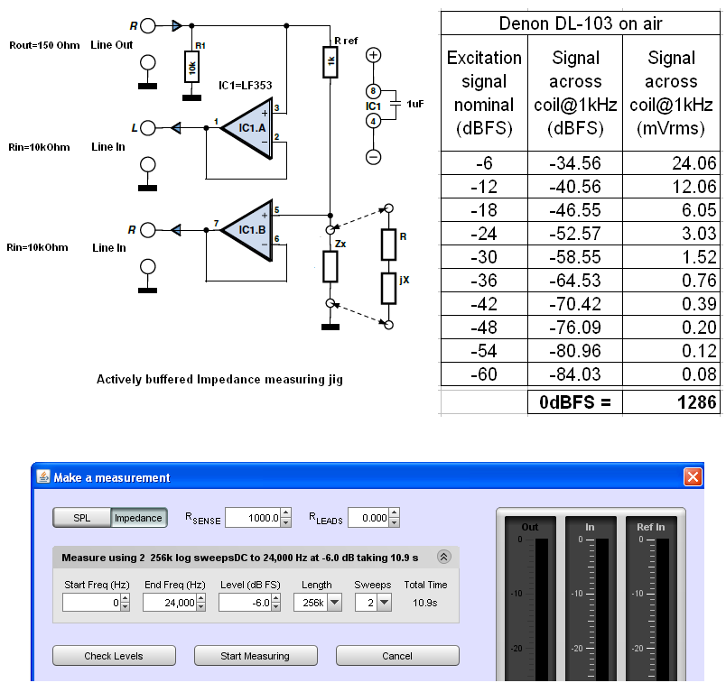

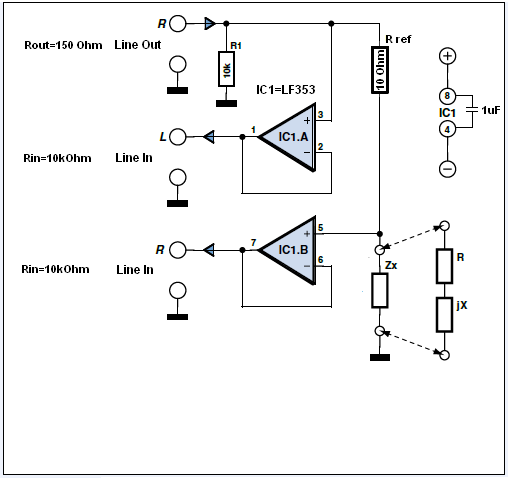

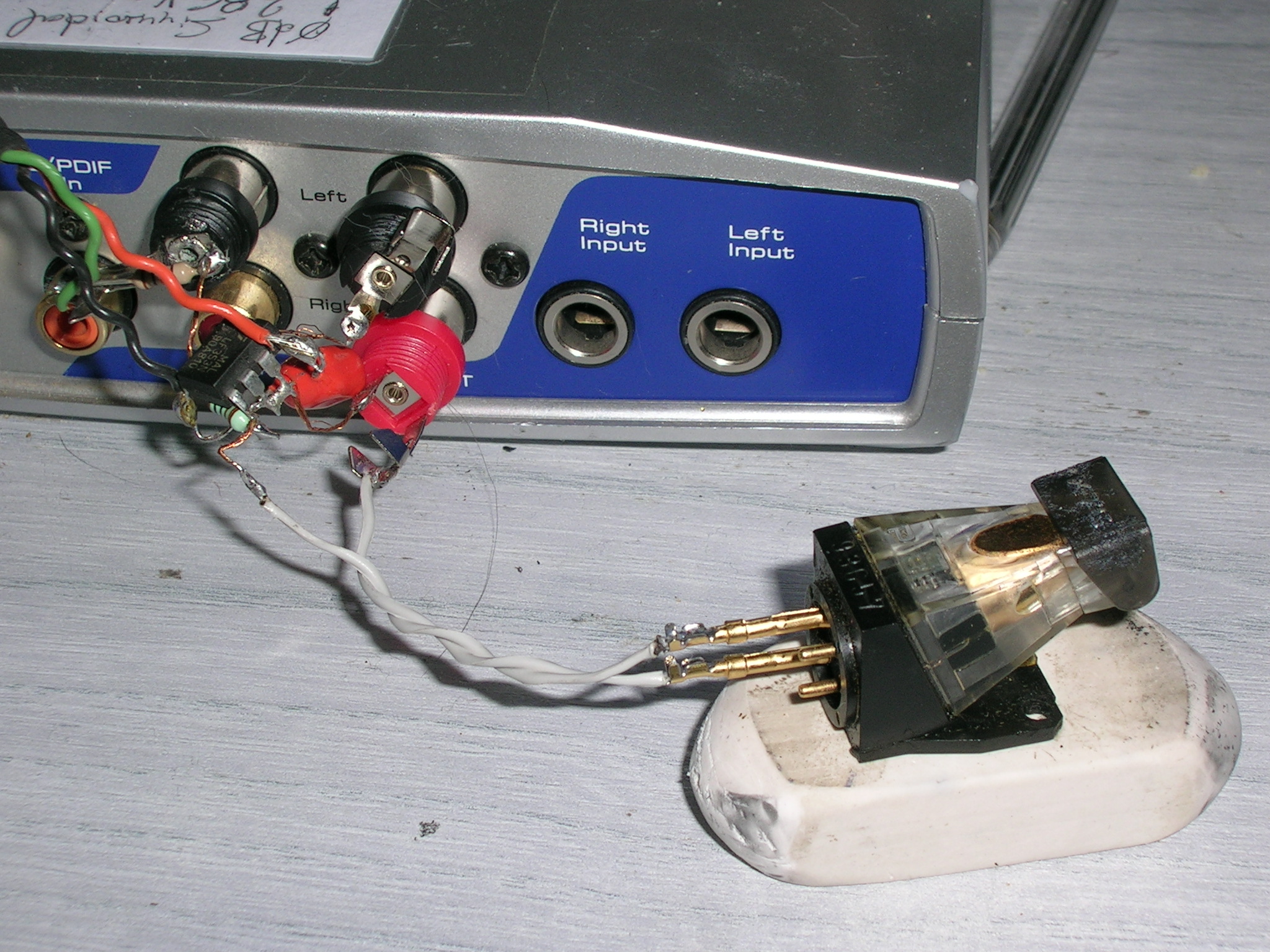

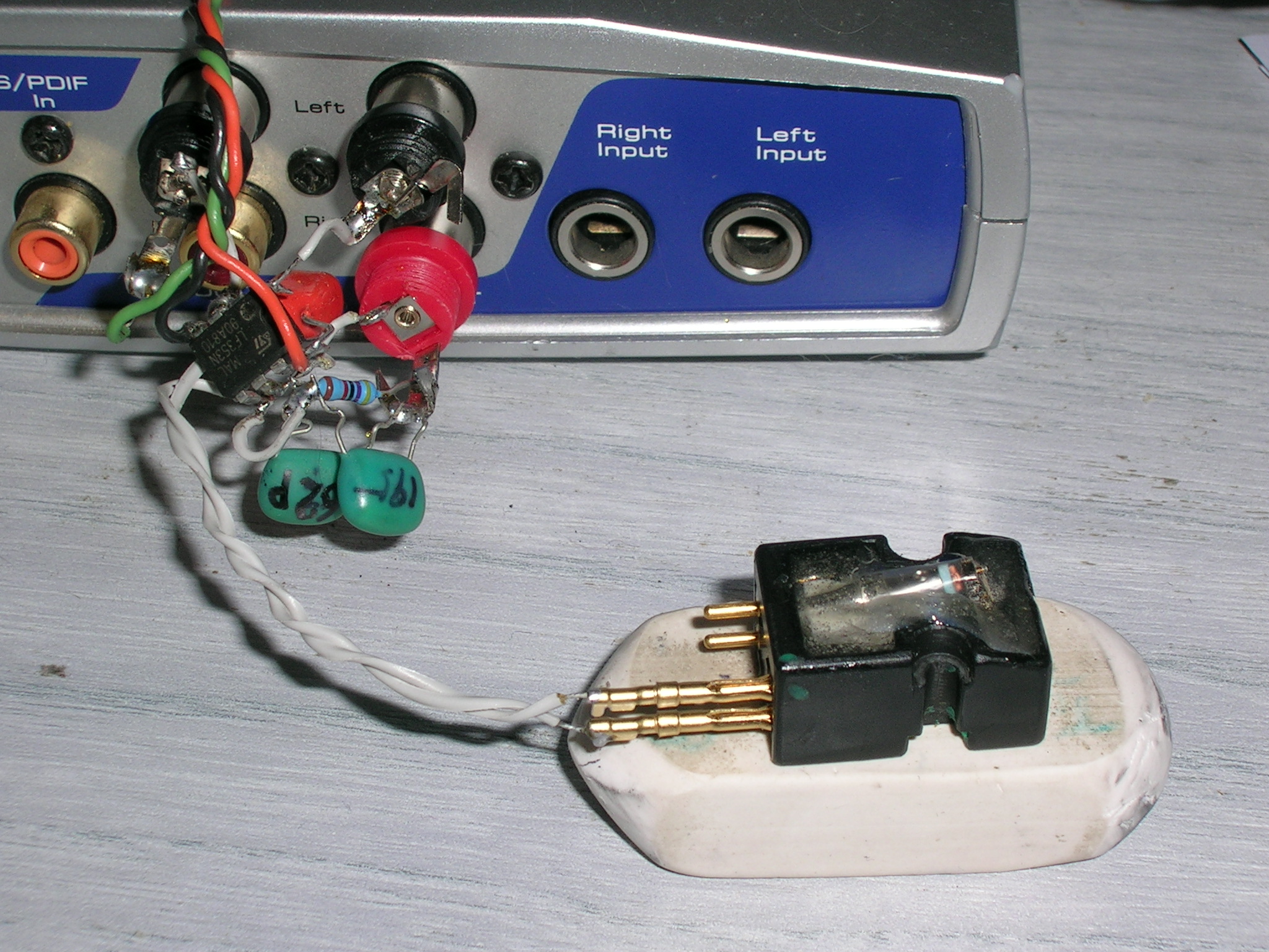

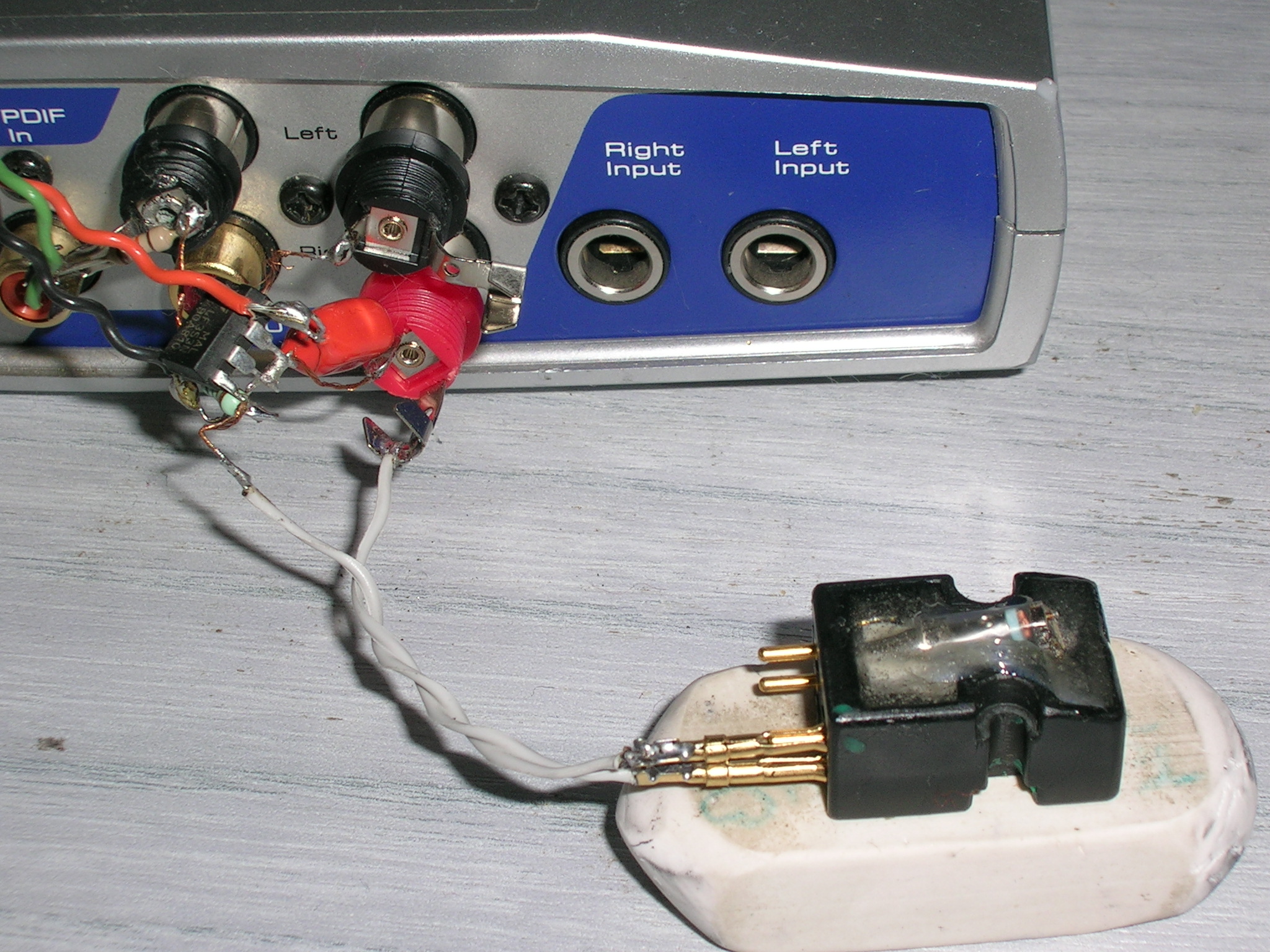

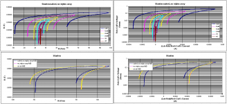

I altered the impedance measuring jig (replaced the 1kOhm ref resistor with a 9.945Ohm resistor).
I used 120Hz signal with different amplitude settings and took some wav recordings. I converted those to txt using Audacity and had it entered in Excel.
R ch represents coil’s voltage.
((L ch) – (R ch))/Rref is the coil’s current.

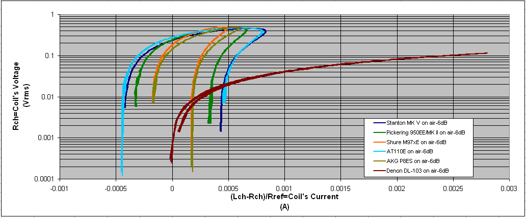

I calculated the magnetization field H (A/m) and magnetic flux B (T).
As B is analogous to coil’s voltage and H is analogous to coil’s current, the coil’s voltage against coil’s current diagram is of the same shape with the B against H diagram. Therefore one can deduce the shape of magnetic hysteresis curve by looking at the shape of coil’s voltage-coil’s current curve
So I had a look on all my cartridges
It seems all magnetic cores to be on the same range of magnetic hardness (same retentivity), except from the Denon which has the magnetically softest core.
They all differ in coersive force, thus they differ in hysteresis losses.
Again the Denon has by far the smallest hysteresis losses, then AKG and Shure, then Pickering and the higher losses are on the AT and Stanton.

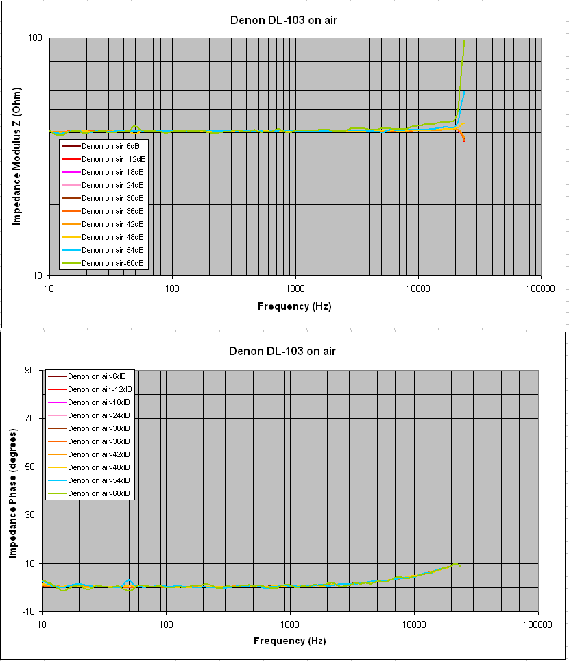

George these are absolutely fascinating measurements, but I confess I really don't know how to interpret them. Re: the Denon given its much lower sensitivity are you measuring it at the same voltage levels as the MM carts? Have you tried measuring the Denon with a lower load resistance (eg 100R or 500R)?
Finally how do you interpret these results? That final set of hysteresis curves is particularly interesting. I am surprised by the much higher currents in the Denon. Is this somehing that is going to be typical of MC carts with low inductance and low coil R? Knowing that all of these are "good sounding" cartridges what are we to make of these results?

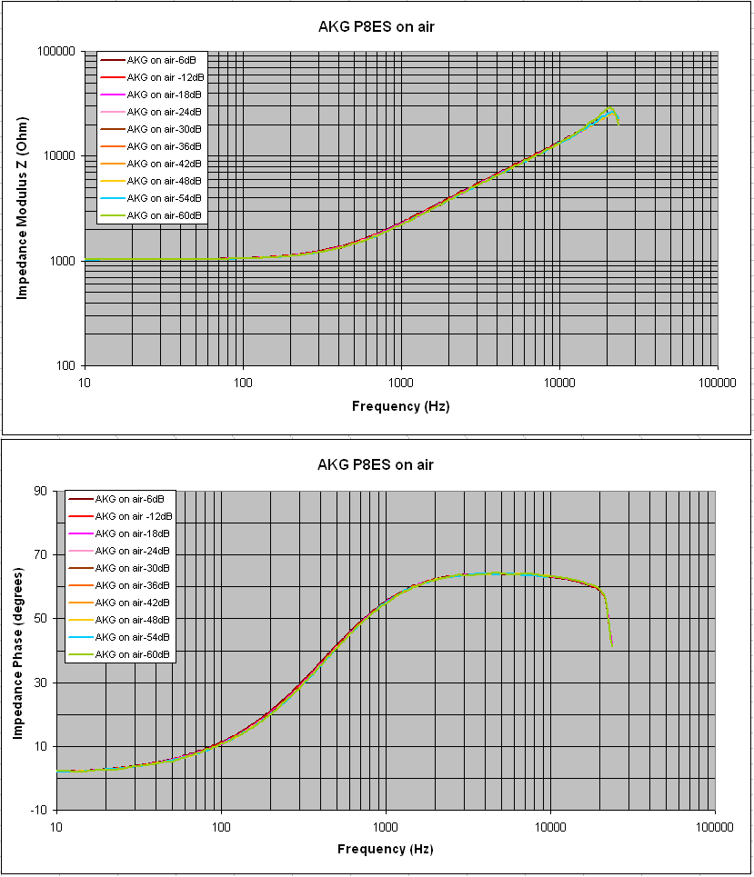

Thank you nezbleu and Bill.
I don’t draw any conclusions yet, only the obvious technical aspects.
I guess, all important information is encoded into the impedance diagrams I posted some post above. The magnetic domain diagrams will surely reflect those information too (e.g. hysteresis diagram I am sure will widen up when the excitation signal increases in frequency, reflecting the resistive component of the complex impedance).
Why I do this analysis/ brake into pieces then? Only curiosity.
When I finish, some more info on which part of the motor causes what on the impedance curve will hopefully come out.

The signal current from a typical MC with 100R load can be much higher than a MM with 47k load.Re: the Denon given its much lower sensitivity are you measuring it at the same voltage levels as the MM carts? Have you tried measuring the Denon with a lower load resistance (eg 100R or 500R)?
The signal power of both types is similar, if anything MC slightly higher.
MM generators are fairly poor - too many turns of really fine wire

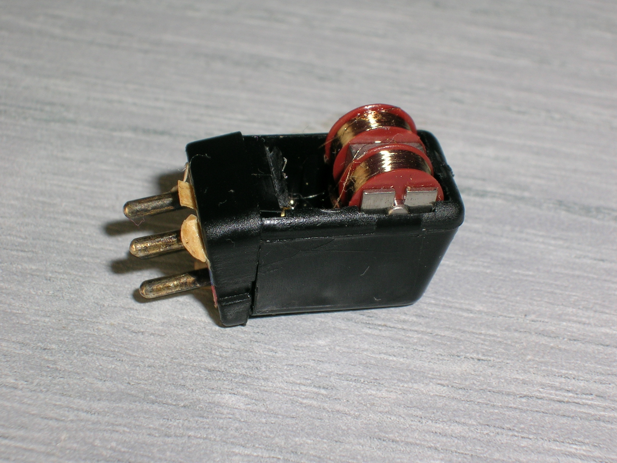

The Stanton I dismantled had SWG48 wire (1.6 mil diam). Engineering tables show this wire handle 3.4 to 5.2 mA DC continuously.
The coil of an MC is quite open to air with a few turns and very few layers (maybe single layer), so there should be no derating due to heat build up.
And I think the wire of the DL-103 is thicker than that of Stanton. I have to check it.
George
