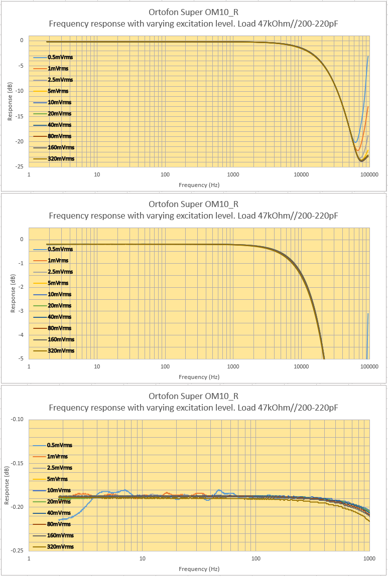

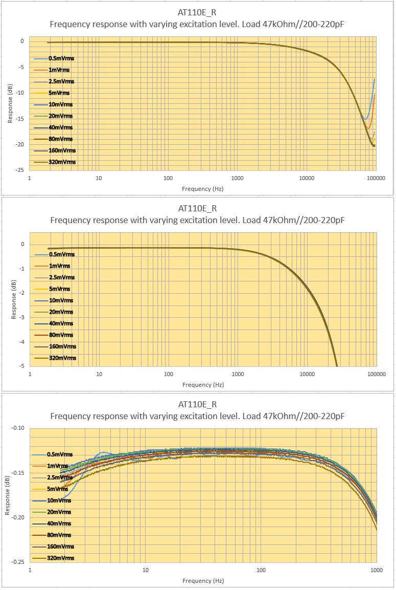

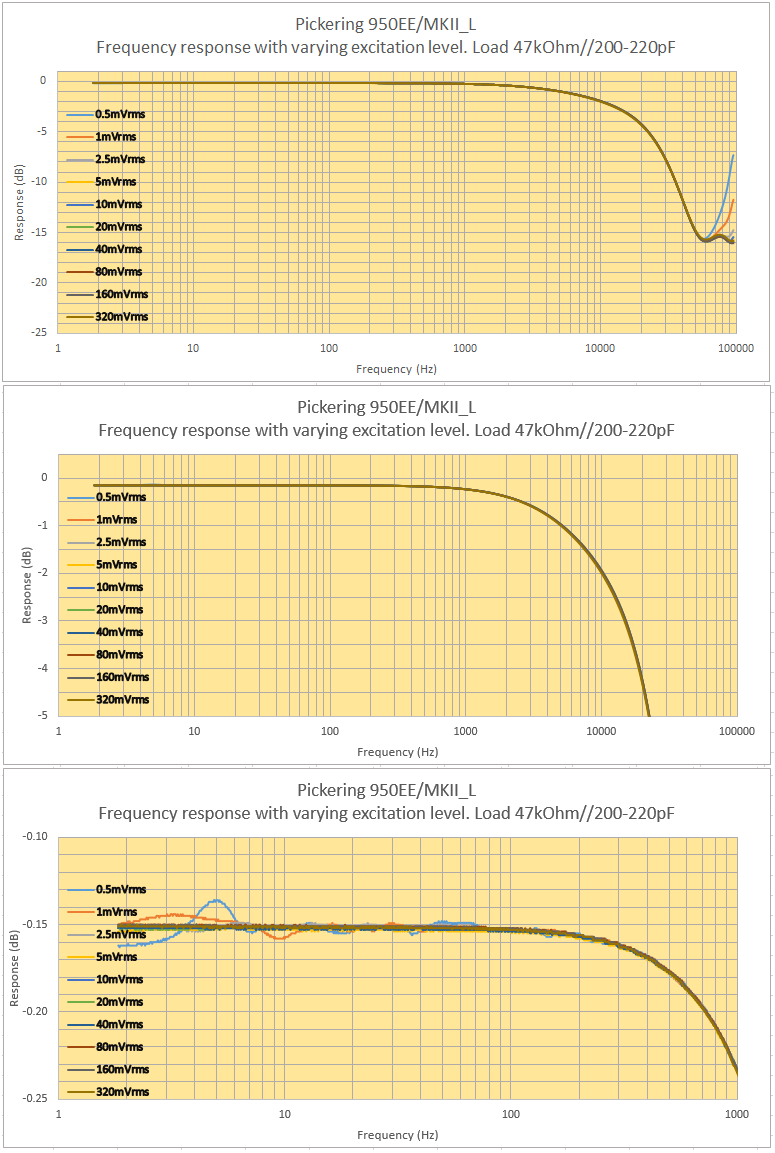

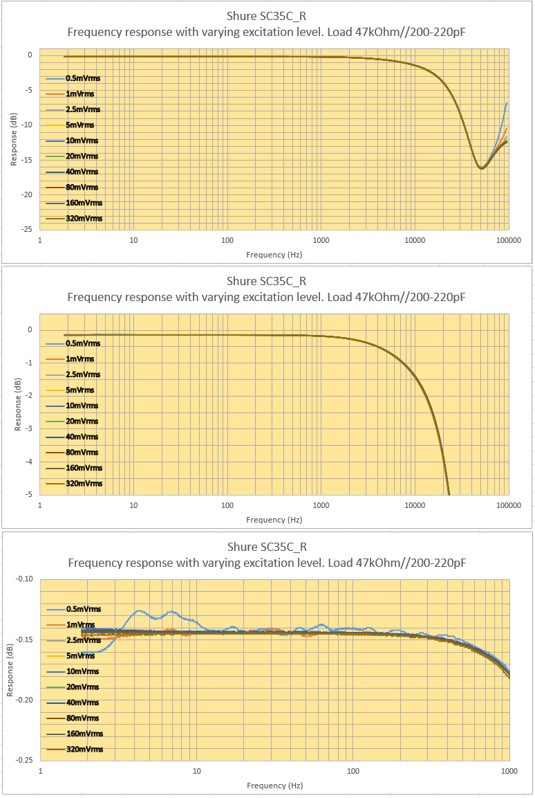

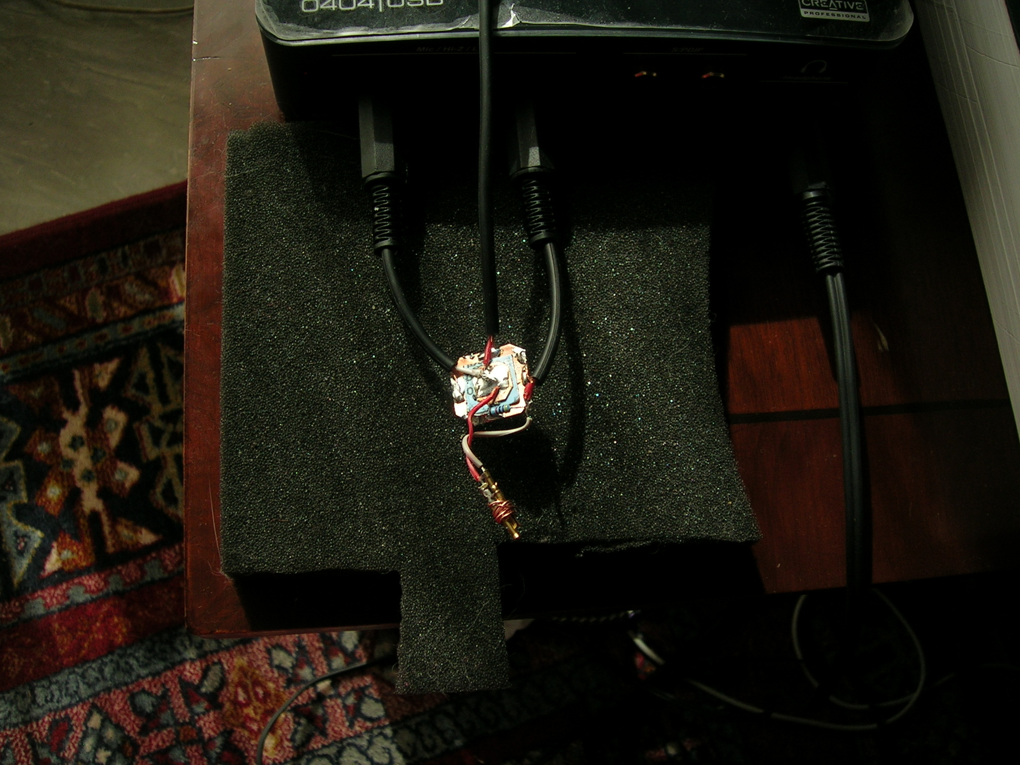

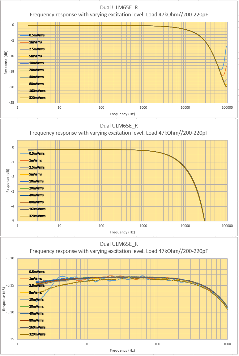

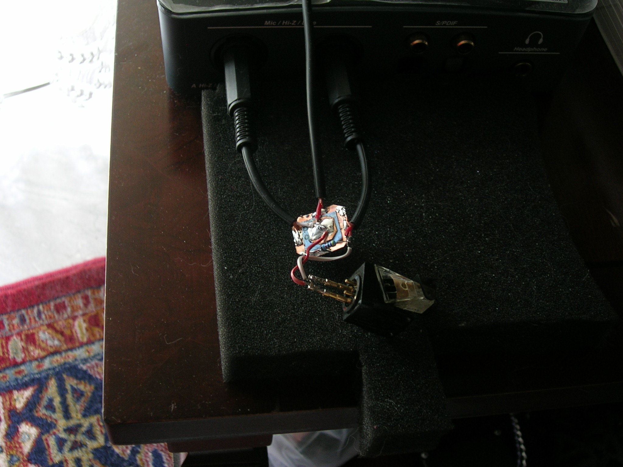

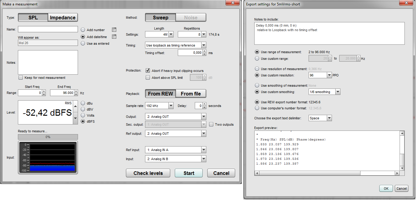

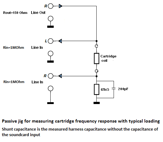

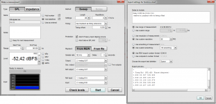

Frequency response test of the fixed part of cartridge’s motor (coil and magnetic core).
Ten steps of excitation voltage.
New jig, E-MU 0404 soundcard, REW SW.
192kHz SR, 4M sweep, x8 repetitions, 3minutes per sweep, 1504 freq points data sampling (96 PPO).
1/6 oct smoothing, subtractive method at each excitation voltage step (cartridge response-short response in Excel).
George
George

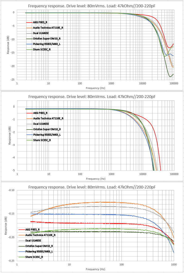

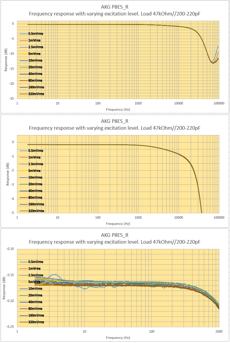

AKG P8ES_R channel
Audio Technica AT110E_R channel
Dual ULM65E_R channel
Ortofon Super OM10_R channel
Pickering 950EE/MKII_L channel
Shure SC35C_R channel
