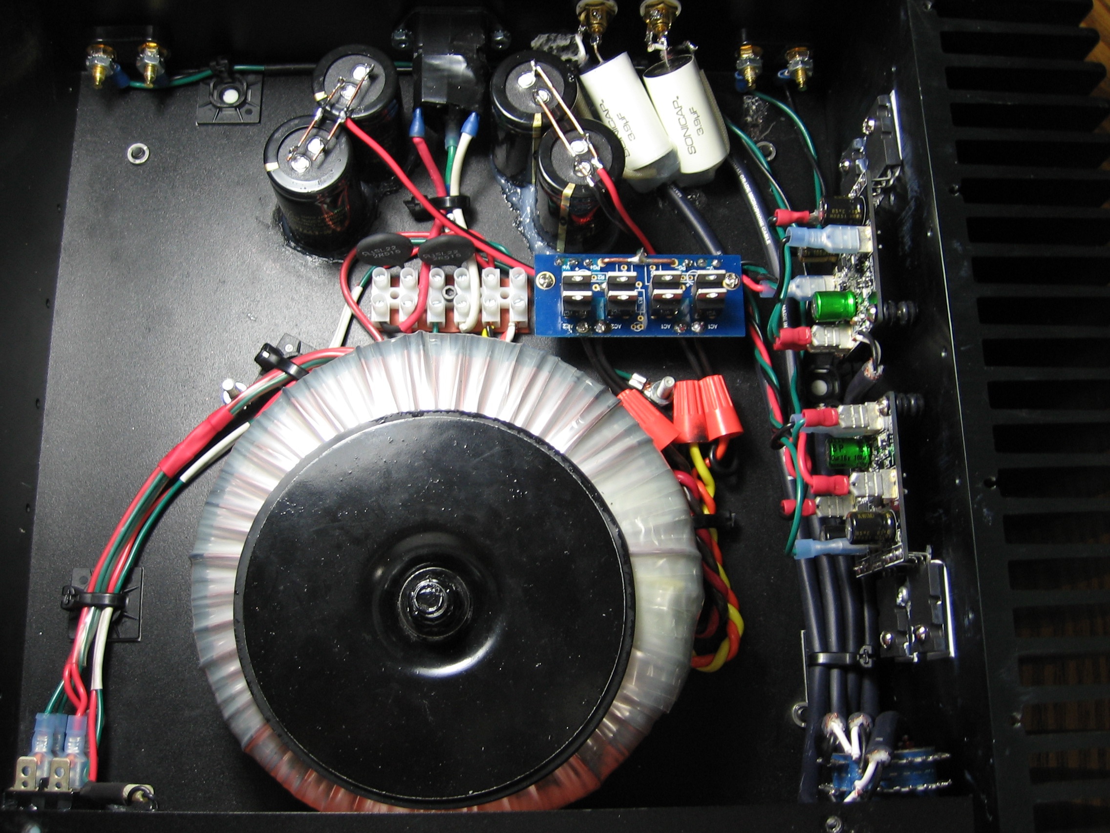

in my case I use microphone cable for the input signal only and the rest I use regular 18 AWG copper cable (cheap from radio shack). Check picture.
