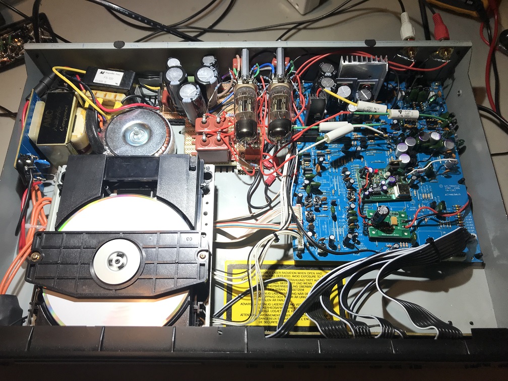

Dear all,
Following up here with the listening results.

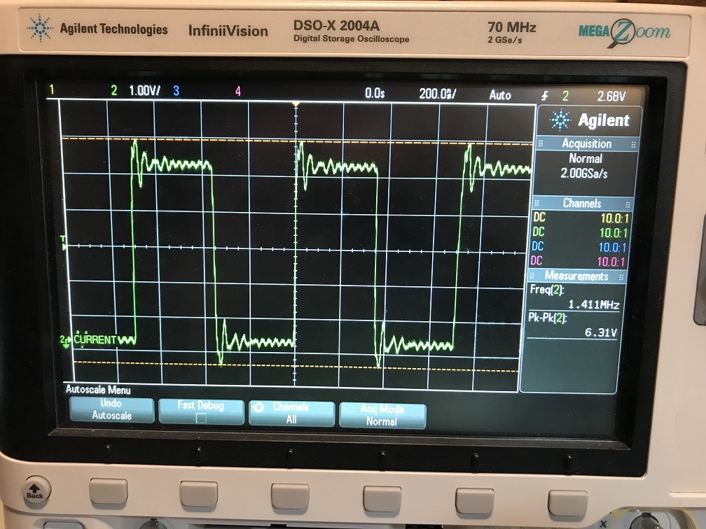

At the DAC four outputs I placed RCRC (10k/220p/10k/470p) filters which do a very good job at suppressing the rubbish coming out (see pic).
Unfortunately I was not able to make accurate measurements because the test CD I use with a 1KHz signal was burnt on my PC and the CD player does not like it, meaning that I hear a lot of noise.
So here are the listening results:
SRPP and Grounded Cathode
Nice sound, warmer and slightly bigger stage than with Burson. A bit too much amplification (but no distortion) will require an L pad attenuator at the output, before RCA...unless there's a different way to reduce gain. I did not notice any difference between SRPP and Grounded Cathode
Broskie Cathode Follower
Flat, cold sound. Did not like it
So, unless there's something else I can try, I have a winner which eliminates the need for the (very good!) Burson opamps.
However, I admit I am rather disappointed because I was expecting a wow effect by using tubes vs. good opamps. There is indeed an improvement but not so much to really get me excited.
Has anybody any further idea on how to improve?
Thanks again,
Fabrizio

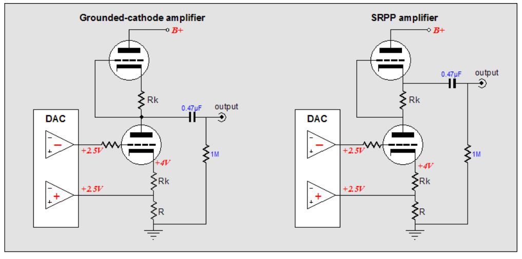

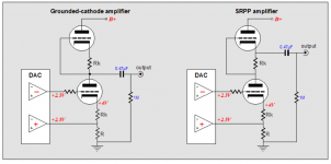

Gain control (reduction) for differential SRPP
So I did some more tests and here is the final brief recap
  • Differential ground-cathode (slightly better audio performance than Burson)
  • Differential SRPP (slightly better audio performance than Burson)
  • Broskie cathode follower (not as good as Burson)
  • Differential anode plate follower - on two different bias points (on par with Burson)
  • Differential anode plate follower + cathode follower (on par with Burson)
Unless there's another other configuration or tube set beyond 6N6P (I have space for two only) worth considering, I am going back to SRPP (see picture)
Now the final question is, how can I reduce the differential SRPP gain, without adding attenuator L pads at the four inputs?
Thanks again,
Fabrizio
