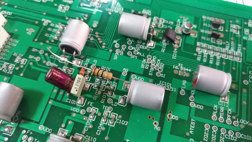

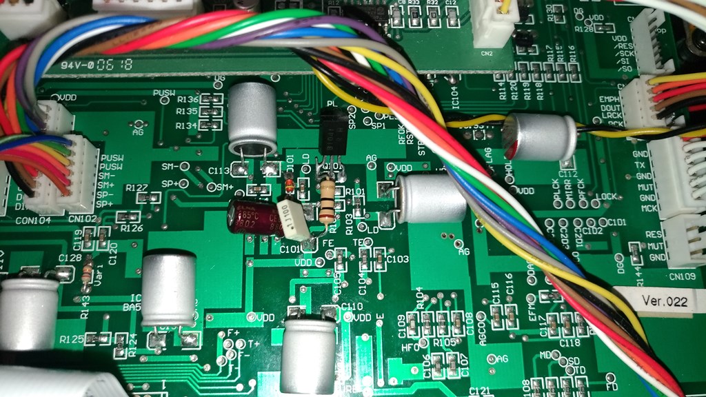

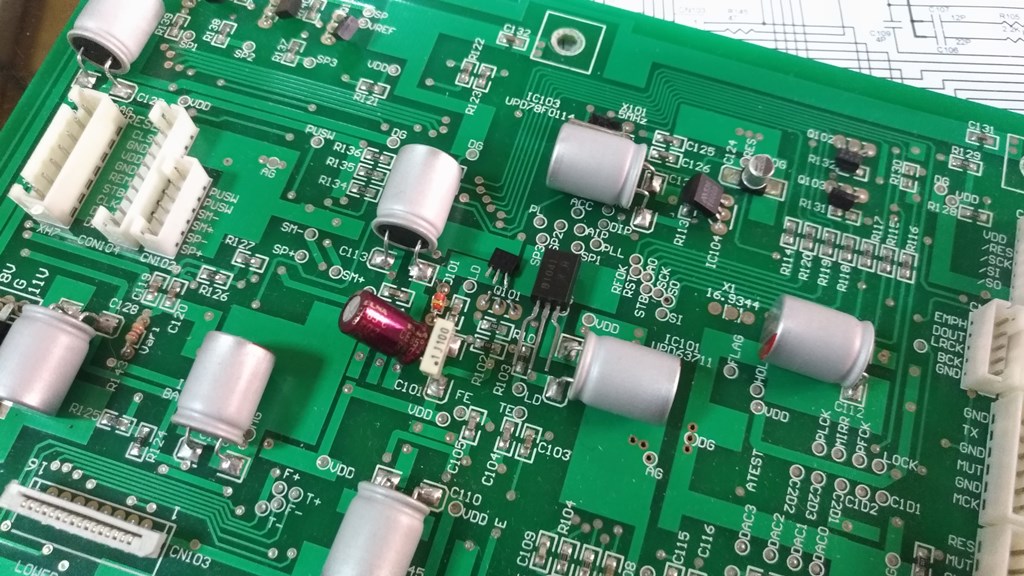

replaced laser power control Q101 with a higher power, higher current capable transistor 2SB1041 pin compattible.
replace also the emitter resistor R101, which should handle around 50mA current, with a 1/2watt resistor. (can you see the difference?!)
I don't expect this replacement would provide any benefit to the sound, but definitely this could relieve the stress on these tiny components, and make them live longer.
