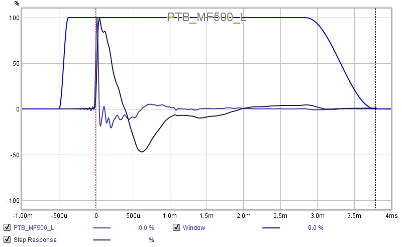

Denny ,
have you inverted the Polarity somewhere in your Test circuit for your new Impulse Response plots ?
or are those results in the actual Polarity -{ positive and negative connections }- that your drivers are in connected to the crossovers ?
Alternately , does your Amplifier invert Polarity ? ... and did you post the Reference Test Signal shape not though your amplifier ?
ToTo Man ,
Is the Horizontal Axis of those Plots in milliseconds ? or in metres ?
{ I can guess , but better is to ask to be sure.}

Hi Alan,
The amp + would have been connected to the positive on the speakers, the red terminal.
I don't know if there is an inversion there. I used a Sugden A28 amp. I see that REW has a setting to invert the input but this defaults to off.
The impulse responses are generated by the REW software from data recorded during the FR tests. I'm not an expert on REW so I don't know what it does with the Reference signal. Can you expand a bit on your question.

Hi Alan,
Many thanks for the reply, I appreciate it, and I look forward to hearing more from you in due course, but let me answer your questions in the meantime:
- The impulse response x-axis is in milliseconds.
- I don't (think) I have the equipment to measure impedance plots. I'm still fairly new to all this stuff. In fact it's only fairly recently that I realised that DCR is a pretty useless measure of a driver's operational health and output efficiency. My measuring kit is basically a UMIK-1 USB mic and RoomEQWizard software, which allows me to make acoustic measurements to measure things like frequency response, harmonic distortion, phase, impulse, RT60, waterfall, etc.
- I mainly focus on the frequency response graphs when matching up drivers, because this is the most obvious aspect that my ear focuses on when I listen to a pair of speakers. The harmonic distortion plots are very useful too however as they can help to weed out faulty drivers (I have successfully used this method to confirm faults in an MD500 and HF2000). I'm therefore not sure how much additional benefit measuring the impedance curves would bring, given that I am already able to pair-match on frequency response and distortion levels?

Hi Alan,
REW has a function to Invert the impulse in the Controls. Would inverting make more sense?

Hi DennyG ,
The Impulse Response under the first frequency response in your Post #1213 is in correct Polarity.
The Step Responses of your mid-domes in #1218 are in Inverted Polarity , but do not worry about that because those Step Responses show that both domes are in good condition , as there is a fairly smooth curve shape and no large ripples of breakup.
For Post #1219 , what Vertical Axis did you measure on ? Is it on Tweeter Axis ? or Mid-dome Axis ? or at some height in between both ? or ?
Also , that short burst of small ripples before the first spike , and there is similar in ToTo Man's Celestion plot , but not in his Tannoy plot. Do you know if those Ripples are residue of a Filter or similar within the Test Device ? or a result from the loudspeaker ? That is , has any other speaker driver you have measured with the same test equipment given that type of small-ripple initial response ?
And as it seems that you are now content with the sound from your 66s I ask: what value of Resistance did you finally decide for connection in Series with the 3.9uF cap in Parallel with the mid-domes ?

The chart below is the PTB_MF500_L Impulse response and calculated Step response using the REW software after inversion using the REW Controls. It now looks like the Response using Holmimpulse. There is no inversion option in Holmimpulse that I can see and the default setting for REW is for no inversion so why the REW measurement is inverted is a mystery. Something to check next time.The Step Responses of your mid-domes in #1218 are in Inverted Polarity , but do not worry about that because those Step Responses show that both domes are in good condition , as there is a fairly smooth curve shape and no large ripples of breakup.
For post #1219 I measured on the tweeter axis which is 920 mm above the floor level.For Post #1219 , what Vertical Axis did you measure on ? Is it on Tweeter Axis ? or Mid-dome Axis ? or at some height in between both ? or ?
REW tests on other speakers also have that increasing ripple starting at about -0.6 to -0.5 mS.
I assume the ripples before the sharp rise are intended to 'warm up' the sound card. I can't find anything in the REW documentation but for Speaker Workshop there are 'warm up' settings described as follows:
"The sound card you use may very well have startup issues when starting a record operation due to things like capacitors charging up and clocks getting to speed. As an option, Speaker Workshop lets you send a short low-level signal to the card before the actual data is sent. This seriously improves the measurement quality for a single sample and marginally improves multi-sample tests as well. The default of 100 seems to work well. A longer default would help with a card that takes a long time to get to full performance. This can be checked by doing a simple Measure Impedance of a driver with a single MLS sample with different warmup settings"
