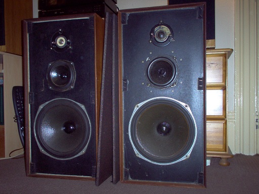

So in the process of restoring these classic speakers, I decided to restore the finish to the wood. Also, the capacitors have been ordered (wife agreed to let me get 'em early!) and so I will be fixing them up next week. 🙂
Here are some pictures of the before and after:
I think they turned out great.

What did you use to clean up your 44's??
No problem. 🙂
I use Howard's for just about all of my speakers. Vintage speakers tend to have tired looking wood, and this stuff rejuvenates it and makes it look like new!

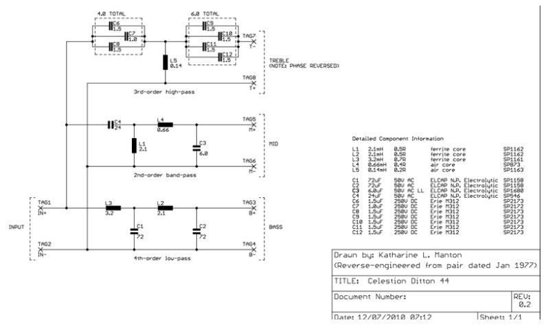

nice 3d- I'm also the owner of ditton 44 🙂, and i would try to replace the old cxover caps- I'm curious if you have replaced the 4 green taps also.
About the 4 black elcap caps, I don't know if I need to maintain identical values (at least for capacity) or if is possible a certain tolerance (+- 10% ) without distorting the original sound. What do you think about it?
Yours new caps are polyprop. or other type? Is hard to find perfectly identical values...

capacitors for Celestion 44 crossover restoration
I have posted a lot about restoring the crossover in the Celestion 44 in the thread titled:
Crossover nightmare!!!!!!!
started by:
lorienblack
including how to keep the basic audio character of the 44 whilst getting a greater degree of clarity.
There are some other tips there also by 44 owners ,
including one about a fault that develops in the board the lead connection terminals are mounted on , and that should be checked !
There is no Flag beside your name mogwai60/Marco ,
thus I do not know what Nation you are in to advise where you can buy capacitors from.
In the Crossover nightmare!!!!!!! thread I posted some Mail-order sellers ,
and why to use only particular combinations of capacitors to sum to get the unusual cap values of the originals.

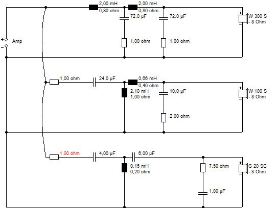

I see you have Katharine Manton's schematic ,
thus you will already know some of what has been posted in the Crossover nightmare!!!!!!! thread ,
and we have discussed adapting the SEAS tweeter there ,
as well as upgrading the capacitors in the old crossover.

I've got a few problems with these babies as it goes...🙄
1) One of the woofers has a badly frayed wire connecting the chassis to the cone, which will break at any moment. I may simply replace them with something similar in the 12" line in the long run.
2) One of the mylar HF2000 tweeters is a clumsy repair with a badly beat up dome, and a mesh I've had to remove since it was glued on wrong.
3) The cabinets aren't a match. One has a cardboard tube on the mid, one has a 3L chipboard box, both heavily stuffed. This should be an easy fix, but getting the bolts and tee nuts off the midrange with the cardboard tube was destructive due to glue everywhere. I had to cut them off in the end.
For all that, they sound nice, albeit with a bit of cone breakup from the largish 6" mid. My sim (below) surprisingly suggests that all drivers should be wired in phase. This makes sense actually. The Visaton G20SC tweeter looks an OK replacement near 86dB efficiency similar to the SEAS 19TFF, but I've no problem with attenuating something different.
Will post some pictures as it progresses. I think this will be a nice speaker when updated, but I can't see any suitable midrange replacement on a 137mm cutout yet. Awkward size by modern standards.

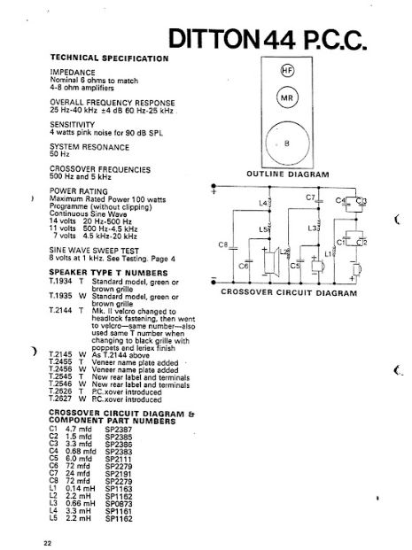

In this thread on Page 1 , Post #6 is one variation of an original 44 crossover -{ = MkI } , and #8 is a MkII crossover.
The crossover in your Post #2 looks like a Celestion crossover board from another model of their l'speakers from about the MkII Ditton era ,
albeit with later manufactured non-polar electros substituted by a restorer.

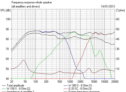

---> what brand/model mid-driver did you use for your Simulation ?
---> If I have read the Visaton data correctly , that tweeter is 89dB ...

I am puzzled that you used 8 ohm for the drivers in your simulation ... ?
and that you changed the input Inductor of the woofer filter to 2mH ... ?
The values Katharine Manton stated on her schematic are correct , or very close to , for all mH.
Where you have drawn resistors connected to the 72uF caps is correct for ESR compensation ,
though I recommend increasing the resistance to 1.5 ohm for the output 72uF cap.
For the mid-driver's filter , there has been at least two , and perhaps three variations by Celestion during the life of the original 44 , and another variation in the MkII. ,
all sucessively reducing the capacitance for the input cap of that filter.
I recommend you use no larger than 30uF for the input cap , and start with about 1.8 ohms series connected to it.
You can use less , eg: 27uF , 25uF , 24uF ... I would choose whichever is simplest to buy as a single capacitor.
{ I have posted about Single capacitor advantage over Parallel pairs of not-equal capacitances in both the above listed threads.}
The output cap you have marked as 10uF ... ?
It is 6uF for the Celestion drivers , and I recommend you start with about 2.7 ohms in Series with it.

Thanks for your detailed reply, Alan. The Dittons are #4 on my list of outstanding projects, but I think they will be the best. It's an early Mark 1 as it goes. 😀
You are right, that bass cone loose wire shouldn't be too hard to fix. I have seen a professional speaker repairer do this sort of stuff in 10 minutes. 😎
My Visaton sim was really an attempt to understand the speaker with modern equivalents. The tweeter is an easy replacement with the 91dB Mylar Monacor DT-19SU: MONACOR INTERNATIONAL : Product Detail Page

a correction to my #57 above , and a reply to #58
I included in #57:
"The Visaton G20SC tweeter looks an OK replacement near 86dB efficiency similar to the SEAS 19TFF, but I've no problem with attenuating something different.
and that would cause a flat frequency response across mids and treble , because the old Celestion HF2000 was 87dB or less.
{ Actually it had a downwards sloping frequency response from about 89dB at low end to about 85dB from about 16kHz to almost 20kHz.}
If you want a modern sound then stay at 89dB , but restorers of both 44 and 66 model Celestions in this Forum have posted prefering the SEAS 87dB tweeter.
The Visaton plot shows slightly less than 6 ohms almost flat Impedance ...
which is good , as you can connect 100 ohm or slightly higher resistance in Parallel with that tweeter to reduce its middle area impedance to the amount suitable to cross at 5kHz with the existing 0.14mH inductor ,
though you will need to use 3.6uF and 11uF for the capacitors ,
because the old HF2000 did not have a flat frequency response.
{ You can use 3.9uF and 10uF with the .14mH inductor , however there will then be a slight emphasis hump in the frequency response at a frequency a little higher than 5kHz , and of less than half an octave bandwidth.}"
I later looked again at the Visaton G_20_SC data , and then some of my old notes about the 44's crossover ,
and saw I was mistaken - twice ! - so here is a correction:
Visaton data states 88dB sensitivity , and the frequency response plot shows the same ,
thus this may be a good match for the 44's mid-driver if a modern flat frequency response is preferred.
From the Impedance plot it seems to be about 5.85 ohms at the lowest in the bandwidth we want ,
and that is close to exactly the text book value for use with a .14mH inductor for 5kHz crossover ,
thus I recommend you do some plots with your simulator for the following tweeter filter options:
all with Load = 5.85 ohms.
Plot 1 ---> 3.3uF + .14mH + 12uF .
Plot 2 ---> 3.6uF + .14mH + 11uF .
Plot 3 ---> 3.9uF + .14mH + 10uF .
and look at the shape of the roll-off from higher treble down through the nominal 5kHz crossover point , and down to lower than 2.5kHz.
Then allow for the slight increase in Impedance of the tweeter below 5kHz ,
and its natural roll-off of output from about 2.5kHz ,
and it should be easy to decide which filter option may work best , or if another option needs to be tried.
Post all three plots here if easy enough to do.
