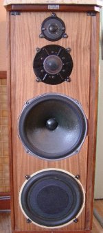

Ditton 66 (series ii) passive radiator
Guys please your help
My friend just got ( a gift!!
) Ditton 66 Series II from another friend..
But (there is always a BUT inst it???) unfortunately one the passive radiators is missing.
Do you possibly know where to find one?
PM or just a M please
Pics are enclosed (not the usual model i'm afraid looks like a cast basket here...)
thanks in advance
Harel
