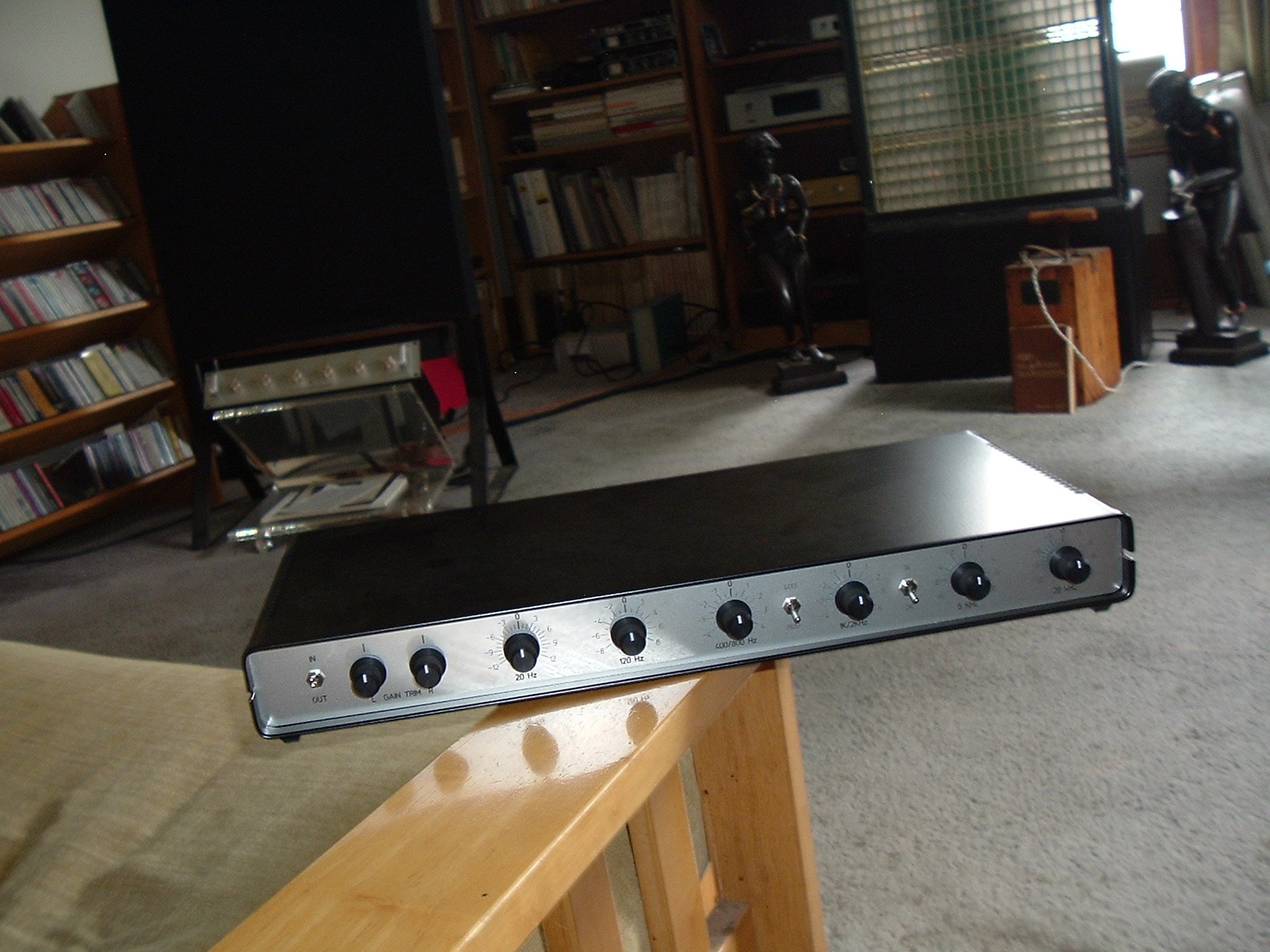

Did put the Equalizer section in a nice small box (see Pictures of 2 versions) on the end of a 10M umbilical that plugs into my DIY Cello Encore Line Stage. Can dial-in the EQ; adjust the gain of each channel by 3dB or so and defeat the equalization FROM the LISTENING POSITION.
Use it a lot to "tame" bright CD's and "boost" deficient bass on older LP's. Amazingly, in many cases only ONE to TWO dB is all that is needed in the midrange.

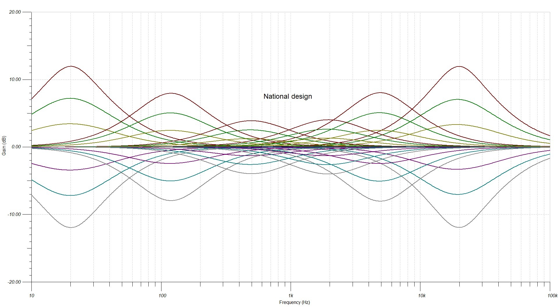

Thanks for the heads up about that National Handbook. Having modelled it with the 6 Palette bands and compared it to the Burwen/Cello characteristics, it is identical. It has precisely the same frequency response with regard to pot setting. Now of course, the Audio Palette used switched resistors, and a 60 position custom switches to get precise dB boost and cut setting. Now it is possible to do that with Seiden switches with 6 degree indexing, or a similar Shallco unit - but the price for 6 stereo switches is completely prohibitive (well over a grand). I know - I went so far as to get quotes!
So the only sensible option is to use linear stereo pots, such as were used in the Palette Preamplifier. That gives a non-linear setting of boost/cut to pot rotation, worst for the 15Hz and 25kHz filters. If you look closely at the Palette Pre, you can see that the settings reflect that behavior.
The good thing is that the National circuit uses one op-amp per cell, whereas the best I managed with the Burwen/Palette was three per cell.
The only problem with the design rules in the National is that for a given characteristic (frequency, and maximum boost) it calculates resistor values, at fixed resistor and capacitor ratios, and the capacitor values come out as awkward values. Since capacitors are only available in a relatively few values, but resistors are cheap and in E96 series easily, a preferred design rule would be to chose common capacitor values, and then work out the resistors to meet the design goals. Rather then fight the equations, I have hand optimized the resistor values using commonly available 1% tolerance polypropylene or polystyrene capacitors to be identical to the Audio Palette responses. And decreased the pot value and summing resistor values to get noise down.
So when I get around to building mine, I will definitely be using the 1977 National Semiconductor Audio Handbook circuit. So thanks Stellavox!

SO in my latest unit, I reduced the low Khz to +/- 4db; 120hz/5Khz to +/-8dB and the frequency extremes to +/-12db.
ALSO - to make it really usable, I put the EQ portion in a separate box. With an 20ft umbilical so I could adjust it from the listening position. Added an IN/OUT switch (really necessary- activates relay back in the line stage) and ~6db gain trim pots for each channel. Pic attached

Nicely built unit!SO in my latest unit, I reduced the low Khz to +/- 4db; 120hz/5Khz to +/-8dB and the frequency extremes to +/-12db.

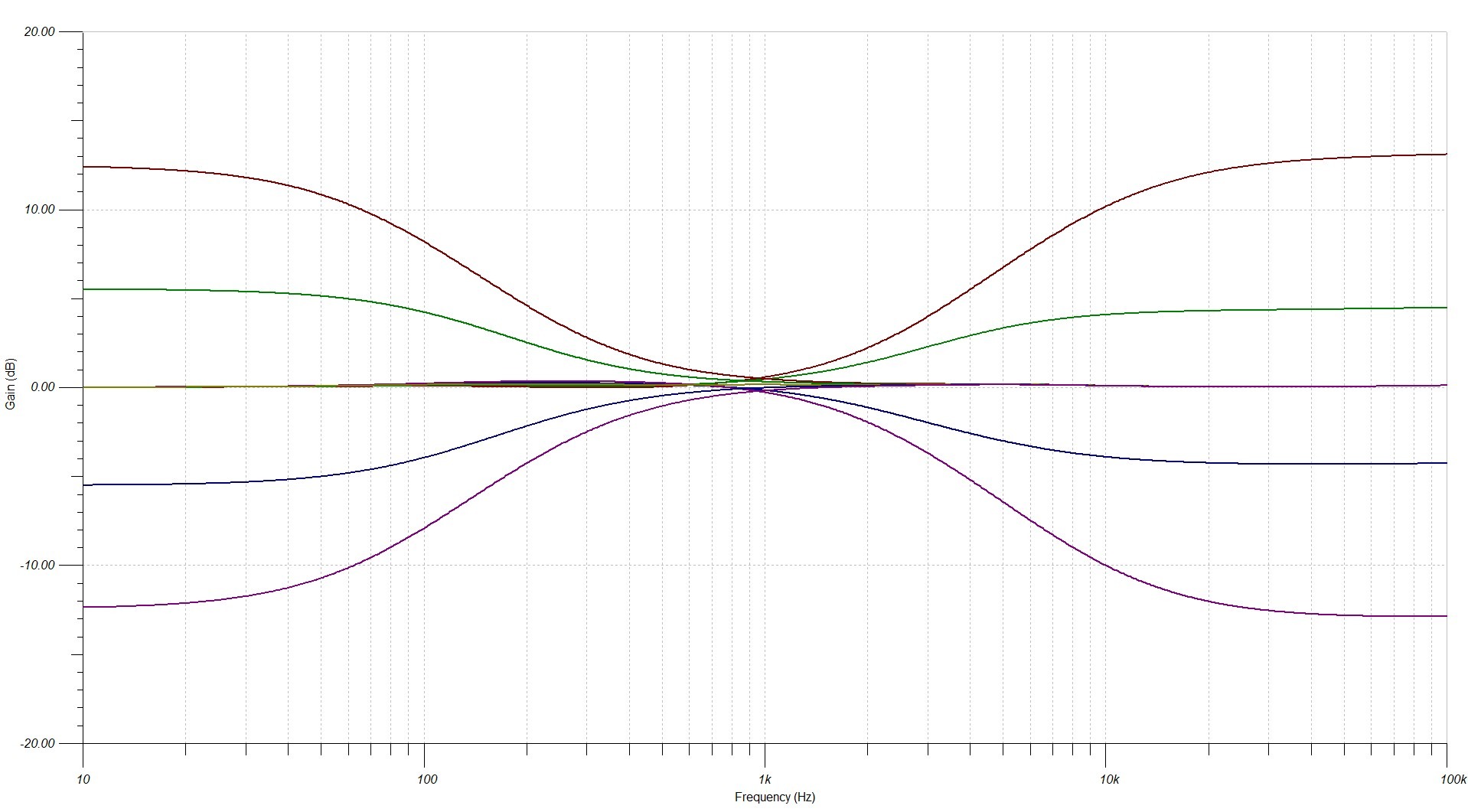

In an earlier mail I plotted out the Baxandall-type characteristics of the 120Hz and 5kHz filters of Burwen's early work on the Audio Palette. I thought this was very odd, and spent quite some time trying to find out what was going on. Then I looked at the spec at the beginning. Burwen says of these filter frequencies:
120Hz control +/-14.5dB @ 15Hz in 0.5dB steps
5,000Hz control +/- 12dB @ 25kHz in 0.5dB steps
Which confirms the Baxandall curves.
This means that in Burwen's design, with the 15Hz control at maximum (29dB) and the 120Hz control at maximum of 14.5dB, the combined boost at 15Hz will be 43.5dB! And likewise at 25kHz, 36dB!!
Anyway the topology of Burwen's early Cello design is that the 15Hz, 500Hz, 2kHz and 25kHz are in parallel, (and have similar shapes to the Palette Pre). Then the Baxandall sections are in series with those.
