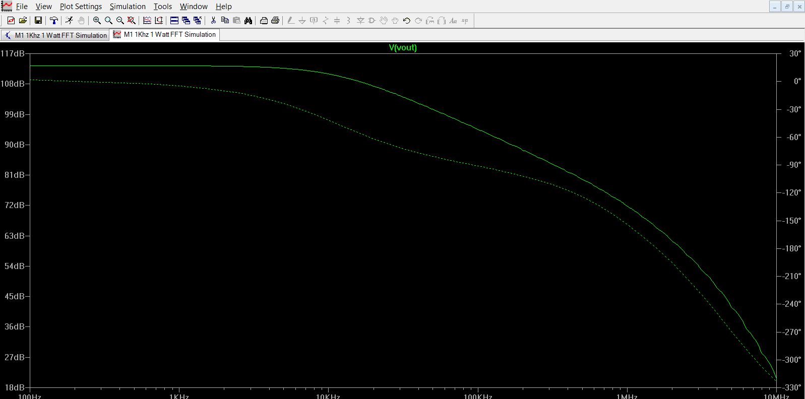

Here is the layout, if anyone wants the dual layer caps I will share them, one leg is on the green and the other is on the blue or top layer. I have them in Layout 6. The current on 2 oz. board is almost 30 amps.
ANY other thoughts and or suggestions and criticisms, I am going forward with the board and SMD's BUT BIG ones, easy to solder for old eyes like mine. Eighth decade coming up fast.:D
