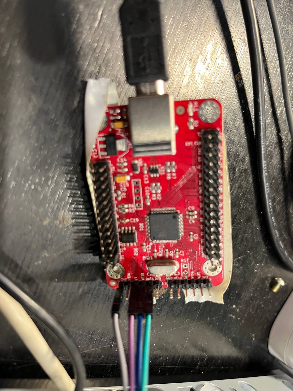

Maybe someone succeeded with USB transport from another manufacturer?

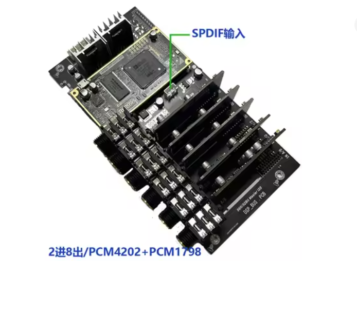

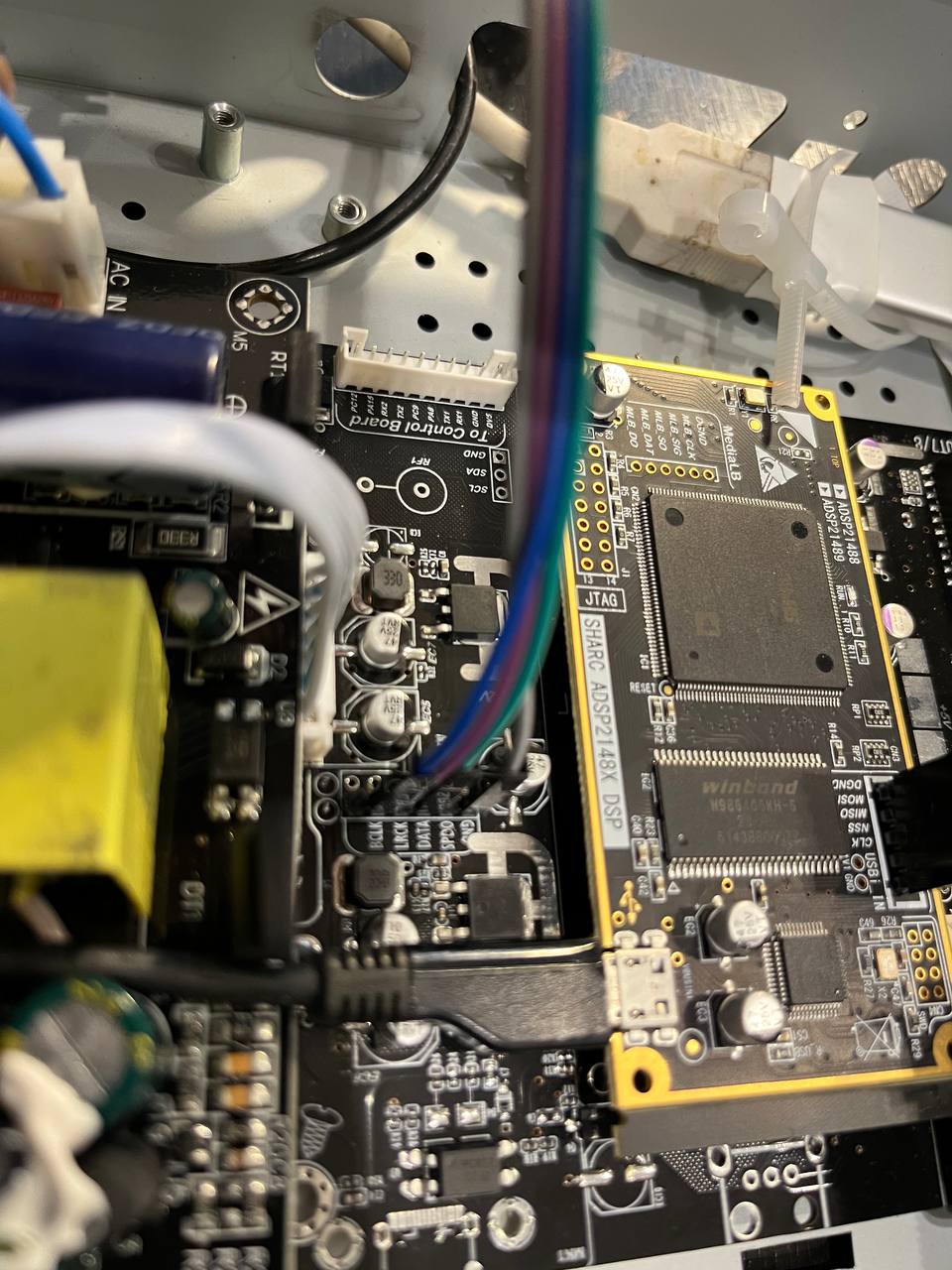

Hello everyone, can anyone help me with the DP48X driver and FIR48 firmware? I also don't know if my board is version 1.0 or 2.0. I hope everyone can help me. Thanks for reading.
It is V1.0, the control board where the ADSP21489 is has a microcontroller, the square chip at one end and also has SPDIF input. It is programmed with Sigma Studio and you need a USBi interface, the original from Analog Devices has a high price, on Aliexpress there are clones with a better price.
I see I can upgrade from version 1.0 to 2.0 by removing the Stm32 mcu and installing a control board with a screen because the mcu is on the control board. I don't know if I can do that? linkIt is V1.0, the control board where the ADSP21489 is has a microcontroller, the square chip at one end and also has SPDIF input. It is programmed with Sigma Studio and you need a USBi interface, the original from Analog Devices has a high price, on Aliexpress there are clones with a better price.
