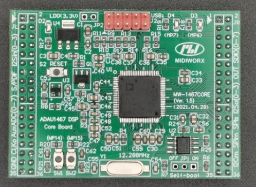

You're absolutely right, ADAU1467 is infinitely more practical and versatile than ADSP21489. And in fact, I have already purchased 2 ADAU 1467-based cards that are currently on their way to my homeSo, the ICE-1000, which is basically the ICE-100b, is the 5MHz variant and you can buy those for around $200 on mouser/digi/etc. The 40MHz version is ICE-2000, is over $1000, and is a different beast. The cheap ones I saw on ebay are of the ICE-1000 type. So it depends. Now, this JTAG ICE (in-circuit emulator is what ICE stands for) would also be usable if you wanted to, in the future, buy the eval boards directly from ADI or on the other parts websites, with it being about $450 (when you can find them in stock) for the new ADSP-21593, which has the power of 4 x ADSP-21489. And the carrying board is able to work with other main boards, so swapping in the future drops down to $100-200 instead of replacing everything (if wanting to do upgrade-able down the line).
But, yes, I will be buying an ICE-100 cheap one sometime soon. You can either wait or not. I gave links to alternatives for those not wanting to wait or do so complicated a setup.
Also, for those not willing to learn some programming, etc., these are better fits. One of them is for having multiple in a single speaker if doing a three way (issues of two different master oscillating crystals, will never truly sync, but you can get close with doing the delays for the drivers), whereas the other is for 8 input, 8 output, spdif in and out, etc.
https://www.aliexpress.com/item/3256802662225376.html?spm=a2g0o.productlist.0.0.16704feaHORhEP&algo_pvid=92c9c83a-04f7-487a-bf3c-aad8da40d51d&algo_exp_id=92c9c83a-04f7-487a-bf3c-aad8da40d51d-2&pdp_ext_f={"sku_id":"12000022454946709"}&pdp_npi=2@dis!USD!!89.85!!!!!@210318c216558245227396043ef032!12000022454946709!sea
https://www.aliexpress.com/item/3256802932654622.html?spm=a2g0o.productlist.0.0.16704feaHORhEP&algo_pvid=92c9c83a-04f7-487a-bf3c-aad8da40d51d&algo_exp_id=92c9c83a-04f7-487a-bf3c-aad8da40d51d-1&pdp_ext_f={"sku_id":"12000024198353420"}&pdp_npi=2@dis!USD!!45.8!!!!!@210318c216558245227396043ef032!12000024198353420!sea
Those can be fully programmed with sigmastudio without CCES. The ADAU1467 gets close to the processing power of the ADSP-21489, but it simplifies what you need greatly. Cost is about the same (if needing 2 of the first one for up to a 4-way or the second one which has all the inputs similar to the board we are working on).
Verify first with the vendor, for the first link, whether the boards have the 1463 or the 1467. Also verify what ADC and DAC is being sent with the board. For the second link, it is plug and play using 3.5mm aux. two channel plugs.
But those would likely be simpler for many to work with, while providing what they need. In fact, two of the first link would, in theory, have more taps available than the adsp-21489. Once again, synchronization issues may arise, but should be minimal. There are numerous ways to handle two in a single system.

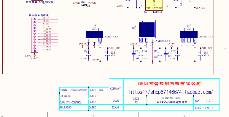

I found shop address also in schematics:
https://shop67146674.taobao.com/

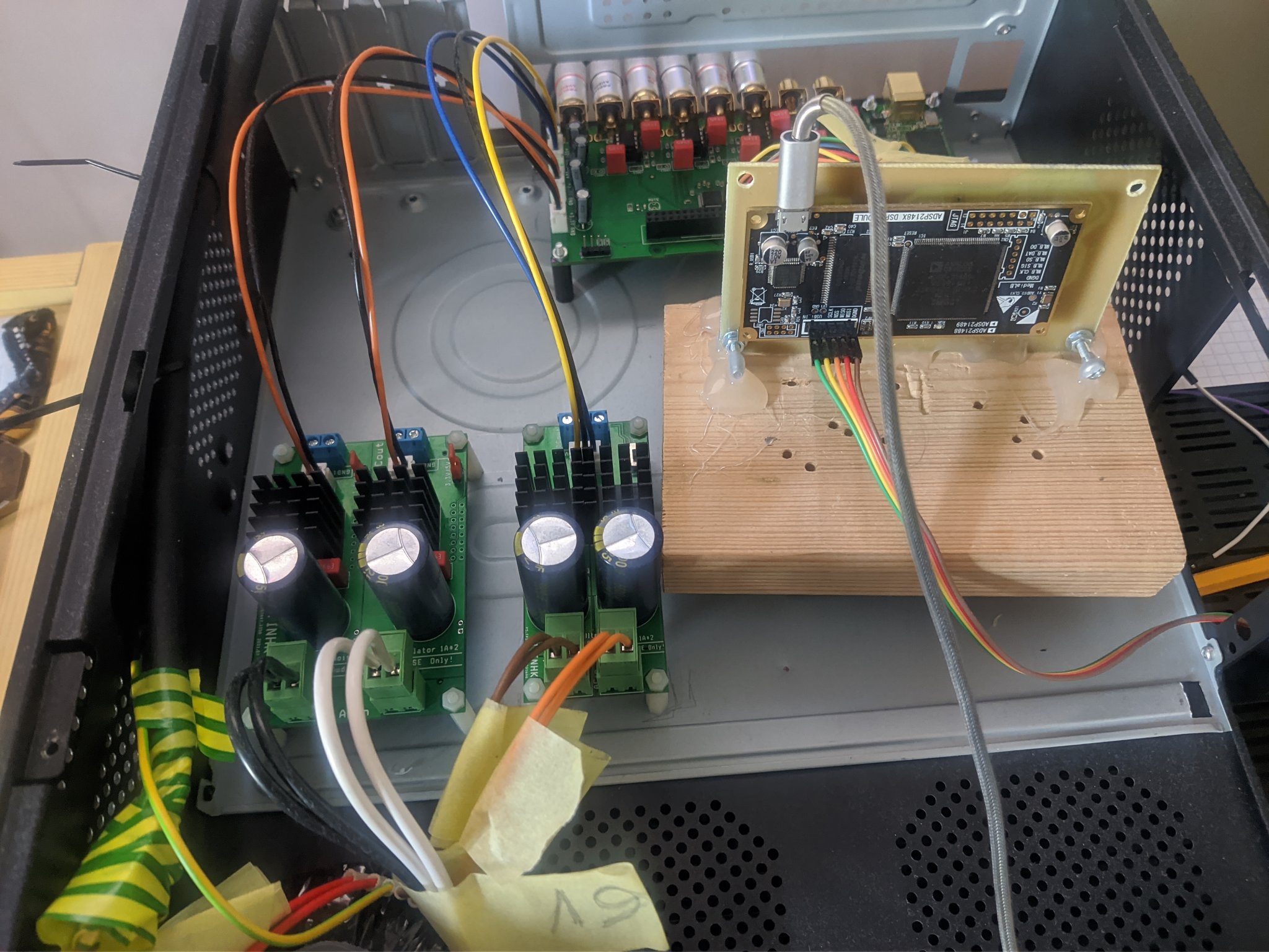

I am using just DSP board without their Motherboard or DAC/ADC, I use my own inputs and outputs via I2S
I have it connected with CM6632A XMOS (In slave mode) and https://www.diyinhk.com/shop/audio-...84khz-32bit-es9016-pcm-dxd-dsd-audio-dac.html
For more flexibility and comfort I want to add bluetooth input, rotary encoder (input select and volume control of dac via i2c registers - more like mute function acutally, oled or lcd screen) So experience is as it is finished productI had raspberryPi hooked up as input with various distros like volumio, moode audio etc.
Was really easy to set up, had most of functionality.. except one - resampling of bluetooth and it seems impossible to be done on ALSA so also on most popular audio streaming distros - cannot feed SHARC DSP board with 44.1k, need to be 96k (on vendor firmware)
So I ordered ESP32 will play with it.. other option for me is Qualcomm bluetooth CSRA6620(or similar) + programmer (this one have resampling done in hardware)
and think best option - Enable ASRC on DSP board
SHARC also have FIR accelerator.. not sure its enabled by default, think it needs special version of algo in SigmaStudio

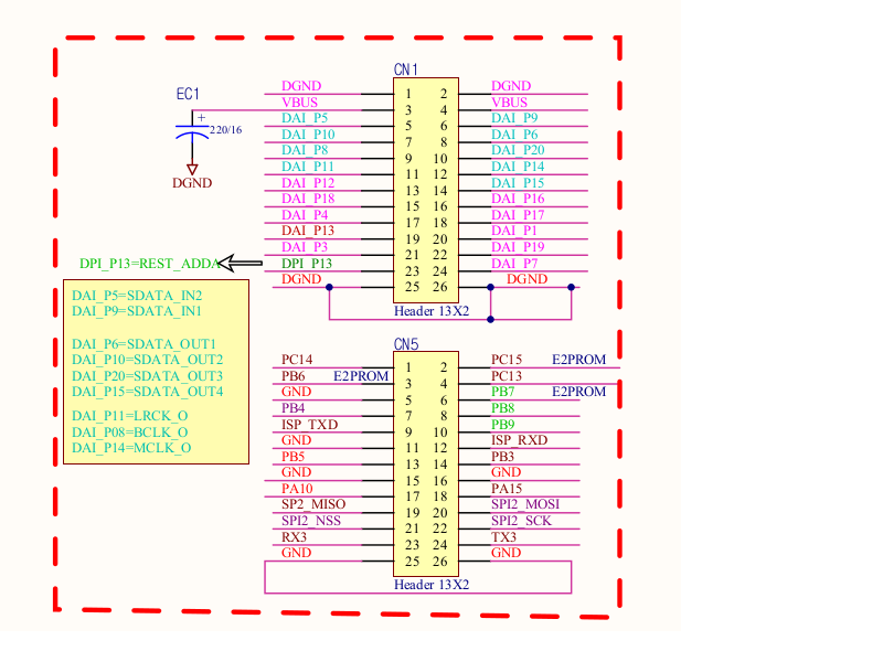

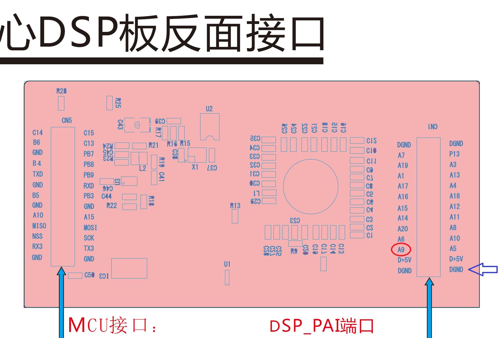

Hi All,
I'm currently using ADAU1701 from Sure/Wondom to get a 2.1 system.
Amplifiers are from IcePower.
I'm building new speakers that will be 2 ways.
So, I need more channels, 4.1.
I have a non used ASDP21489 board.
And ordered some ADC and DAC to upgrade my current "amplifier".
I want to use SigmaStudio.
I'm not far from @ppp000 setting !
My first question is how to identify and set the DAI (A9 is red circle for exemple) in SigmaStudio to make the system work in I2S?
-Input 1 : Bluetooth 5.0, I2S (1x : https://www.audiophonics.fr/fr/modu...ooth-50-csr8675-aptx-hd-vers-i2s-p-14184.html)
-Input 2 : I2S ADC (1x : https://www.audiophonics.fr/fr/appa...umerique-wm8782-i2s-24bit-192khz-p-13351.html)
-Output 1-6 : I2S DAC (3x : https://www.audiophonics.fr/fr/dac-...dif-vers-rca-32bit-384khz-dsd256-p-15975.html)
-Switch 1 : Toggle source from BT to ADC.
-Potentiometer 1 : Volume control.
Second question is how to make in Sigma, a switch to toggle from source input ?
Thanks !

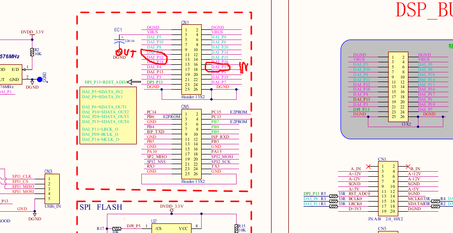

Okay, so things are different for SHARC, there is no possibility to configure pins (as it is on ADAU). Here it is coded in firmware, same as I2s Master/Slave mode, Sampling rate (for this board 96k) and other. In sigmastudio you just add filters and controls they gave with 'sigmastudio for sharc'. Thats all, unless you program in C and have JTAG.Hi All,

Connector CN1 have all i2s/spdif pins, you identified A9
So need to plan on what you connect - Main requirements to what you connect should be:
*i2s slave mode - DAC you linked have oscillators so Im guessing they work in Master mode (maybe just desoldering will work or other easy way, look on internet/manual). Think they wont work out the box (but I also can be wrong..)
*DSP take and output 96k signal only, so bluetooth need to be resampled to 96k before you connect it to DSP. Think one you choose can be configured to resample to 96k, but you need to buy programmer.. connect.. configure.
So you might reconsider buying those
ADC should work when you configure it
