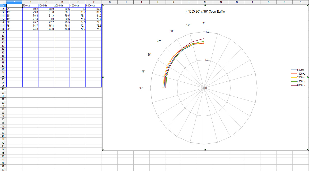

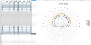

Being a cheap-skate, I'm exploring the possibility of creating the polar plots by hand... measure with REW and export the date [manually] into a spread-sheet and generate the plots that way!? Can REW gate the IR in the way ARTA can?

Looks nice Paul. Expand the polar radial axis to 50 to 100 dB so we came resolve variations. I like your plan for simplified LX521. Full range on top will probably be better with 4FE35 based on what you have shown so far as it has better sensitivity and looks smoother and lower HD. The 8 in go with Peerless or Silver Flute wool cone woofer. Instead of W frame do slot OB with dual 10 in - I think SL has that as horizontal a lot loaded sub.

Have adjusted the chart's axis to read 50, 75, 100, plus set it to 10° segments... Hope to do the first set of measurements with the Vifa & test baffle tomorrow if I have time before work... certainly Tuesday if not.
Had a very quick 20 minute play with Open Office spread sheets to generate a polar plot.
Nice and fast work, BMS :up:

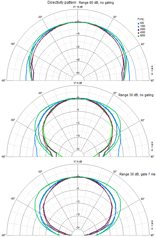

Just to give you a perspective I add three iterations of showing a polar data set with Arta:
Top is a wide dB span as in your spreadsheet. Even at 80 dB span you don't see much of a figure 8.
The diagram in the middle is at 30 dB, which is what most everybody does - an improvement in judging the dipole pattern.
At the bottom the impulse response is gated for a 7 ms window. Now the polars are increasingly free from room reflection artefacts, especially at +60° angles.
Thanks Rudolf, just figured out how to Gate the IR within REW. With the data used for the 0° to 90° 4FE35 polar plot, looks like first room reflections hit at just over 5ms. So a 5ms window should be used.

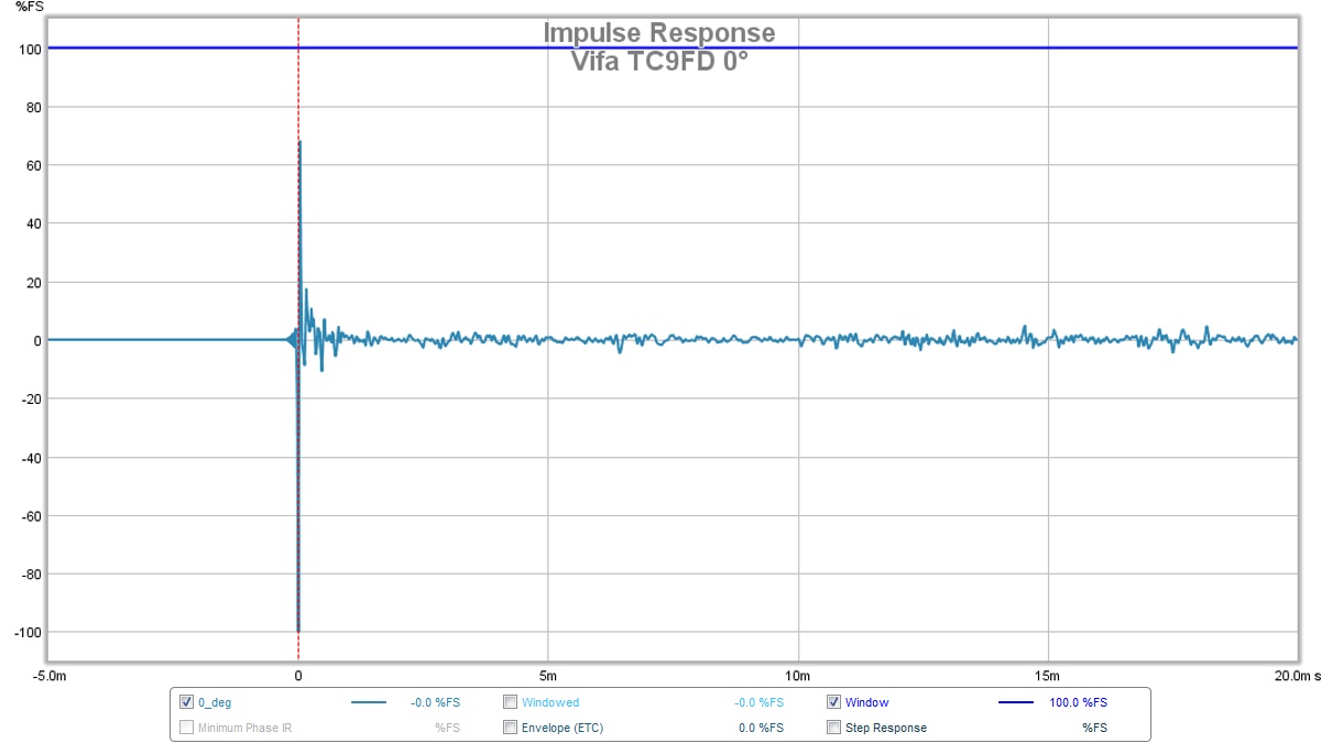

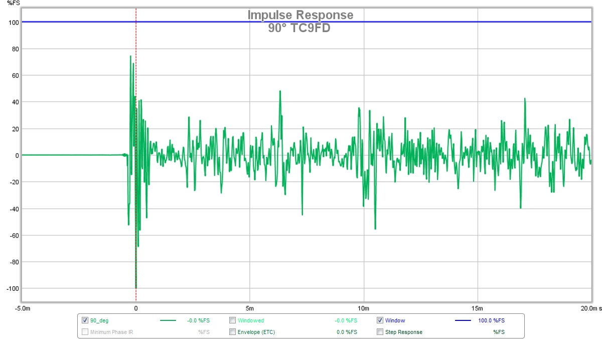

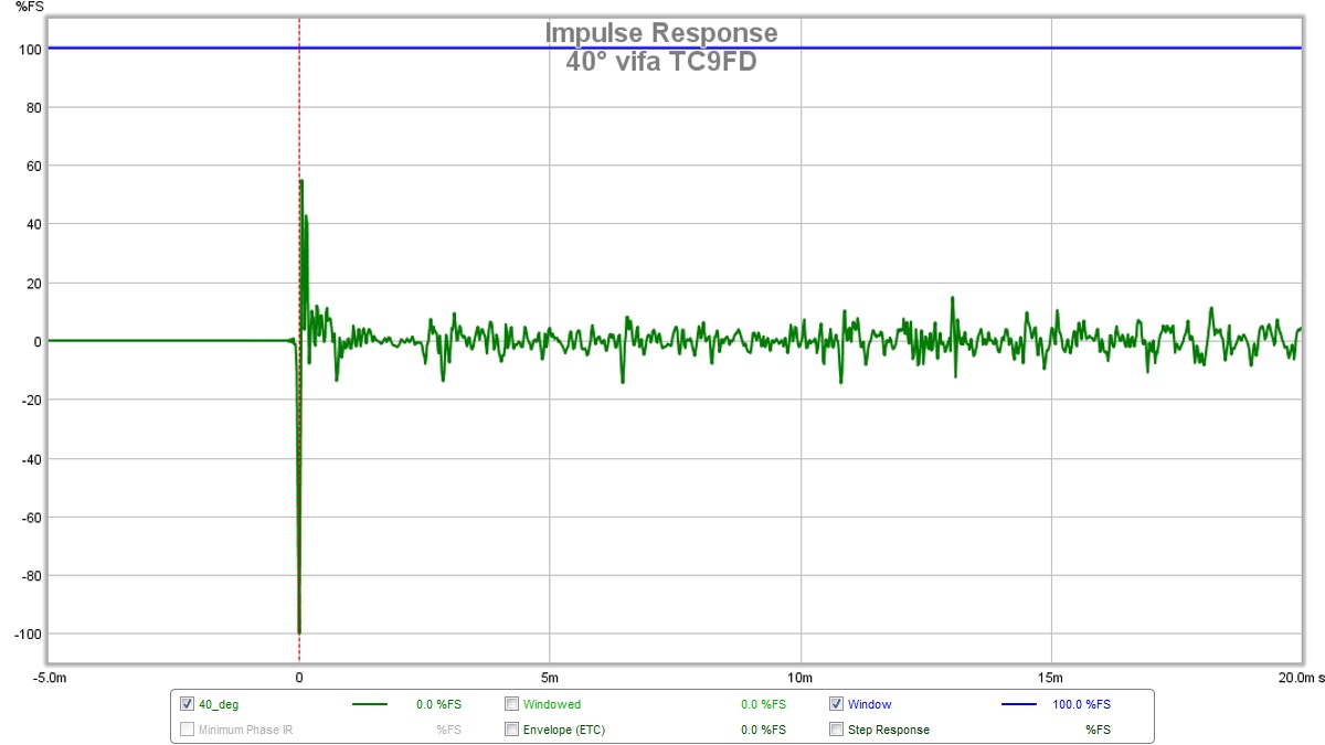

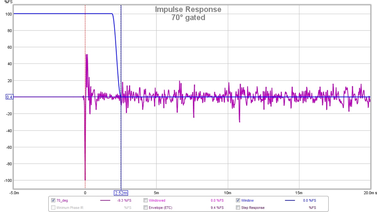

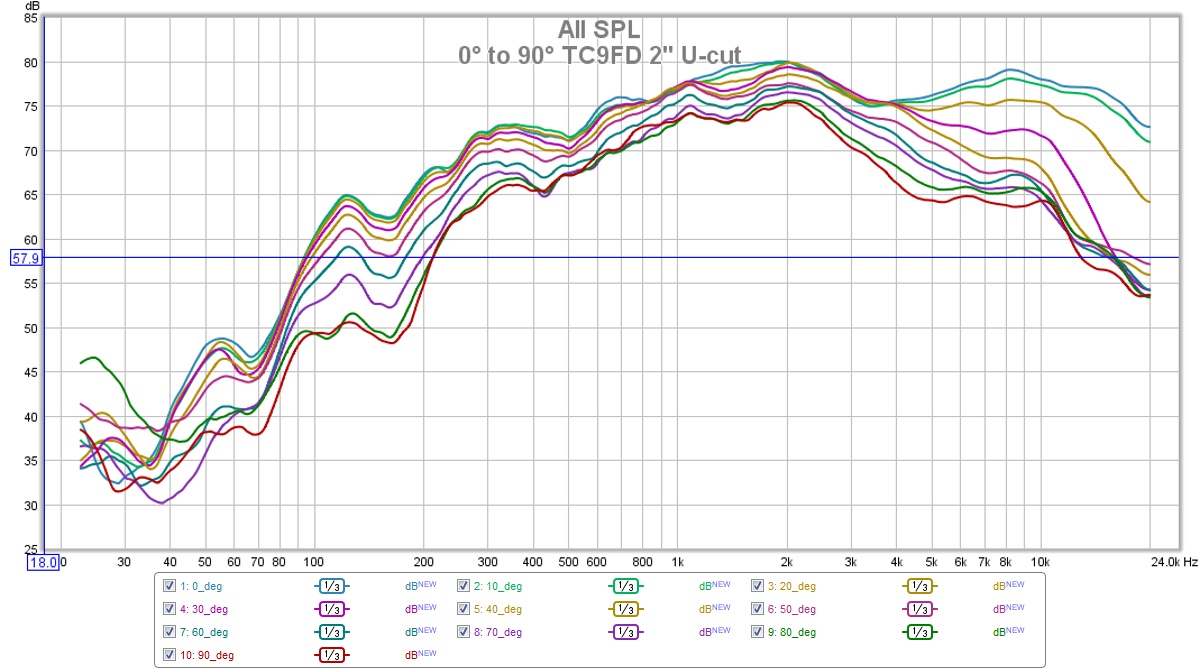

Whoop! First set of measures completed and have a few screen grabs from REW:
-- 0° IR
-- 40° IR
-- 90° IR
-- 70° IR with 2.5ms right gate

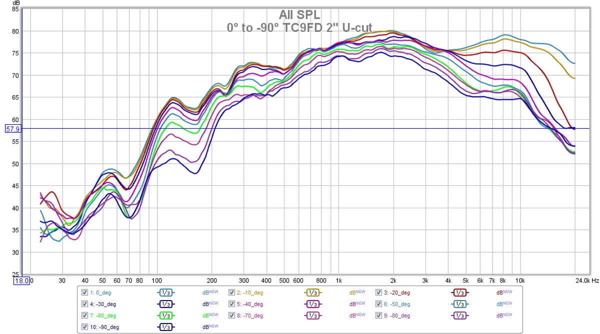

-- 0° to 90° FR, 1/3 smoothing ... Vifa TC9FD, 2" U-cut OB
-- 0° to -90° FR 1/3 smoothing ... Vifa TC9FD, 2" U-cut OB
If we think 2.5ms is OK for the right gate, I'll proceed with producing the polar plot.

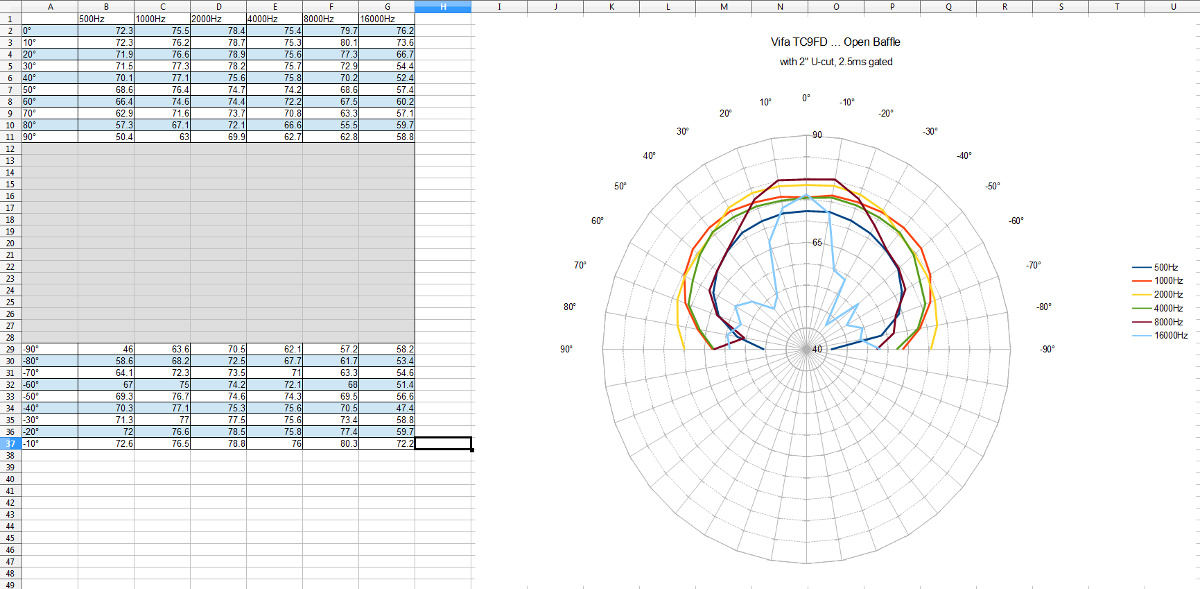

And the polar plot of +90° to 0° to -90°, with a 2.5ms right gate...
Setting up and measures took roughly 1hr, preparing the data and plots, about the same...
If 80dB SPL is to low, I can re-do this set before I make the next cut on the U-shape.
