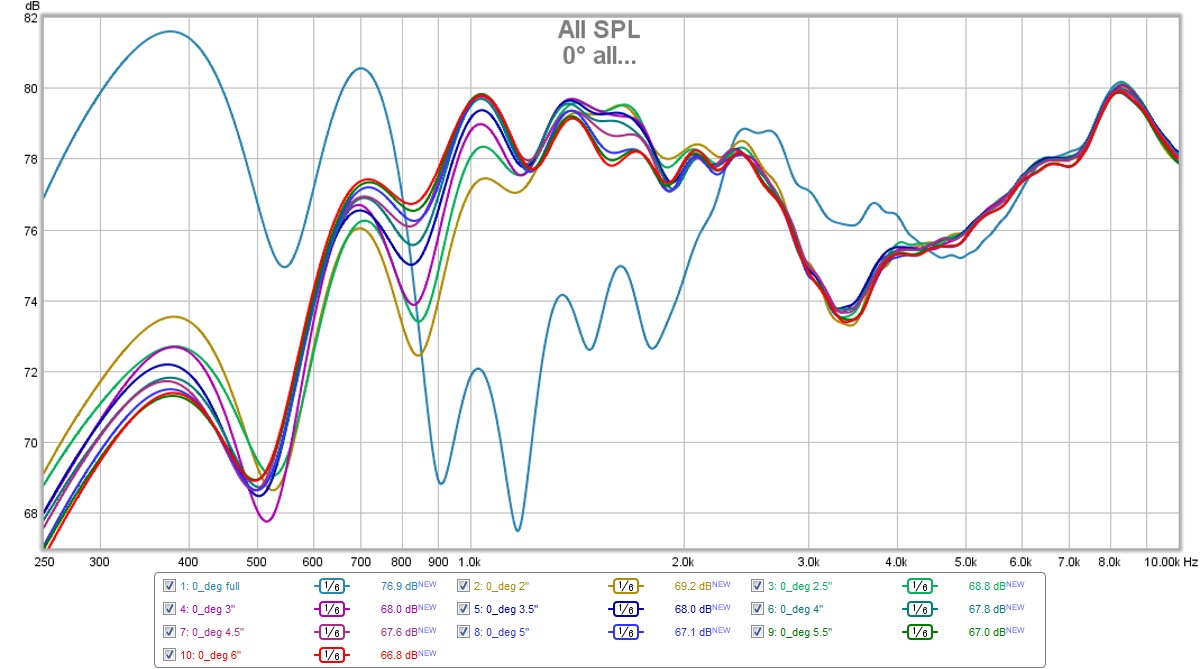

An extra chart of all the on-axis responses, gives a slightly clearer view of the changes through the mid range as the cut width increased. Rudolf, if you wish any specific combination of data, just ask :)

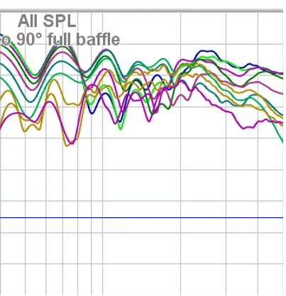

I zoomed into the central area of BMS' dipole measurements. You need to ignore the 80-90° curves in the following animated Gif. They are too difficult to get correctly in a very small room.
What else do you see? The Gif starts with the closed baffle, which features the somewhat chaotic response pattern that Linkwitz shows for the "b=8a" case in A3-5.
When the gap between inner and outer baffle widens, the response curves get more distance between them (beaming) and a better controlled distance between them (constant directivity). The process starts at the lower frequencies and moves to higher frequencies while the gap widens.
I will discuss with BuildMeSomething how we can get rid of those irritating 80-90° curves.
^yep. When the distance from the center of the radiating surface to edges is not constant, ripples are smoothend/distributed. The worst case is circular baffle with the source in the middle.
Your baffles, specially the spiral are good compromises. However, some limiting laws of physics can't be broken!

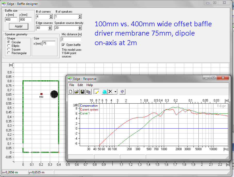

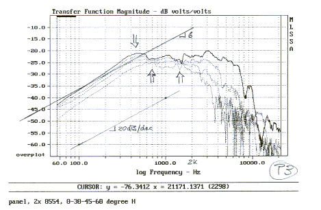

Why did I not get all the rippling in the frequency response on my 12 in wide OB on post #1? Is it the offset that helped?
I'm not sure which of the various ripplings you are aiming at. The notches at 500 Hz, 800-900 Hz and 1.2 kHz are due to the floor reflection. You don't see them as much in a multi-driver system with a cleverly choosen Xover point. The downward slope from 1 kHz to 4 kHz is part of the (small) baffle response pattern - you don't see that with a very large pattern and offset driver. The inconsistencies between 0°- and off-axis angles are part of the too-large-to-be-really-called-dipole dilemma.

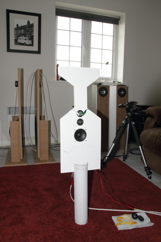

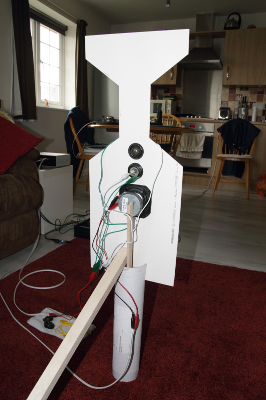

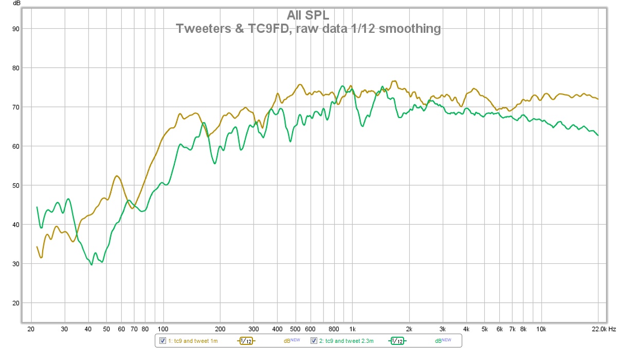

Put together a very quick baffle using an odd bit of picture-mount card [1.6mm] with two tweeters and a Vifa TC9FD. Shape is not intentional, that's how it was, I just cut three hole roughly along the vertical axis. Very quick EQ to get them level(ish) and had a good long listen... First time I've heard a single speaker disappear as a point source, room reflections helped here, but it was a bit eerie [in a good way] none the less.
Measured at 1m TC9 height, then listening position... Once I get going with this properly I'll post in the multi-driver pages.

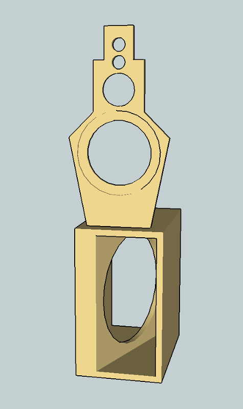

Preliminary idea on the narrow OB... 1" tweeters, ~4" mid , 8" mid-woofer and 15" woofer ... 4-way active system
Is the second tweeter for rear facing? Looks a lot like SL LX521 but with sideways 15 in slot woofer. You could make woofer box a bit larger and squeeze two 15 in in a W slot loaded config (still sideways). Looks good though.
Rear tweeter... from what I understand the rear tweeter is needed to get the correct cancelation at +/-90° between the front & back wave... On Linkwitz site, he says that using a baffle thicker than 3/4" can start to have an adverse effect on the upper frequencies due to the interaction of front/back wave at this juncture.
Was thinking of twin Alpha 15's, a W or Straight slot loaded sideways config would help keep a narrower width. XO between the 15" & 8" would be <=150Hz.
