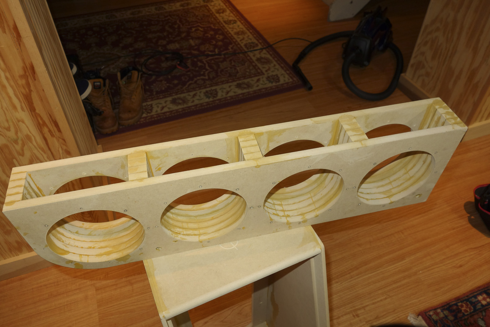

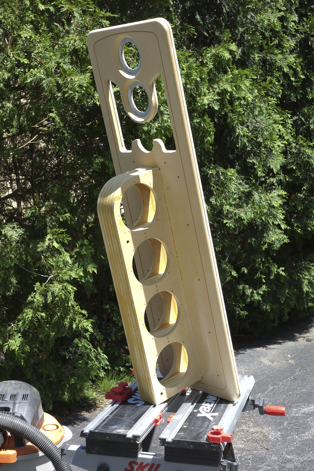

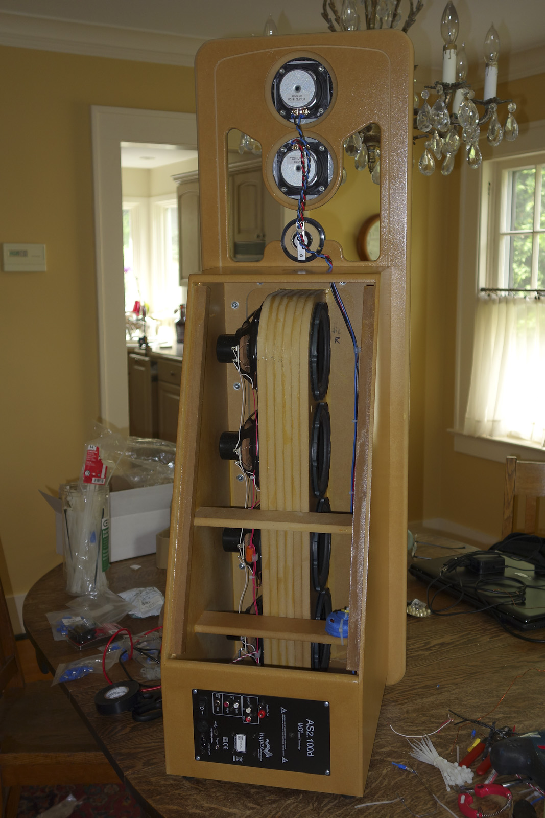

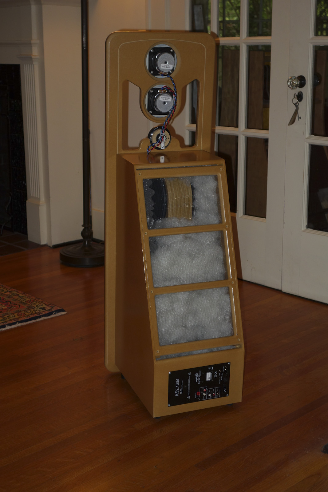

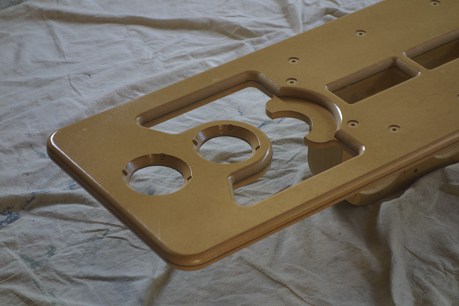

I have been lurking these forums since 2009, posting a quick answer once or twice. But when I saw this I had to step into the fold. This is indeed an excellent design. I completed one that was very similar last spring. It was CNC cut from MDF and uses constrained layer damping in the main baffle with very specific cutouts. Uses the same Vifa mid/tweet, except it's a 1-1/2 config (inductor in series with the top mid). Woofers are 8x Aura/NS6-255-8A. Directivity is very uniform from as low as I can measure to above 14K except for a shoulder around 1K. See pictures. Crossovers, Eq and amps are provided by the Hypex modules you see in the photos.
Not quite so cheap and fast, but it is simply the most natural bass I have ever heard. The mids sounded so good full range that I never finished the x-over for the dome/waveguide that is shown in the photos.
I was thinking of posting the construction details in a thread, do you think this will be of interest?

It is so cool to see that our designs are so similar (it's almost creepy). I want to build mine out of wood when I get a shop - they sound great and the bass is superb. The cardboard sounds really good, I can only imagine how much better in wood. As much as I like foam core and cardboard, this speaker needs wood and you are probably even better off with constrained layers. It makes some serious pressure with 6 in my case and 8 drivers in your case. I see you stacked yours in push-pull asymmetrically opposed arrangement too. Please explain what is going on on the top - it looks like the Vifa has a cutout around it to provide better imagine? The Vifa directivity is indeed very good. I have some measurements in another thread if you are interested:http://www.diyaudio.com/forums/attachments/full-range/402191d1393333563-3-4-driver-very-good-dispersion-high-xmax-nautaloss-ii-2-drivers-polar-1m.png
X
I kick myself for not buying those 6 in Aurasounds when they were on sale!
