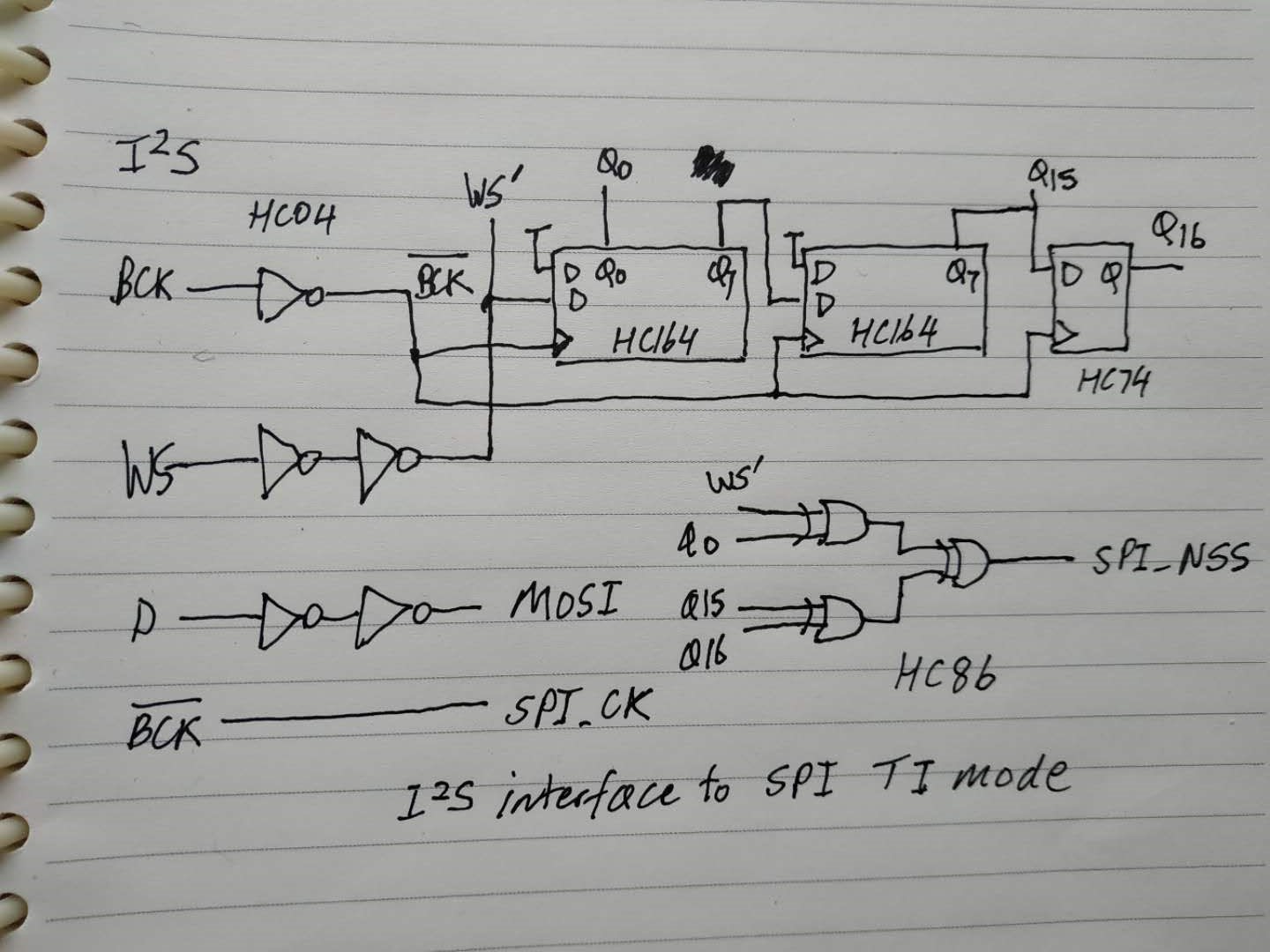

ARM Cortex M0 series CPUs have been around for about a decade now but, unlike their bigger siblings (M4, M7), don't come with I2S interfaces at the cheaper end of their product ranges. I decided to have a go at re-purposing the SPI interface which comes as standard on many low-end parts for I2S duty.
Over on Aliexpress you can find STM32F030-based boards for around $1 which have the necessary SPI interface. While its certainly cheap, the F030 is getting a bit long in the tooth now and has been superceded by the G030 which hopefully eventually will fall to the same (or lower) price as the F030. The G030 is a little bit more powerful (64MHz vs 48MHz) but more importantly is much lower power and also has a single I2S port. Even with the very welcome addition of the I2S port though you'll still need the SPI interface as the manufacturers in their wisdom only implemented a half-duplex I2S. Which means you can either use it for input, or output but not both.
To get started in programming the F030 you'll need to download a toolchain. ST has a helpful package called CubeMX which allows initialization of various peripherals by 'wizard', i.e point and click. After setting those up it generates code which users add their own individual elements to. In order to edit and augment the machine generated code, I use Keil's MDK which is free provided you're not generating more than 32kbytes. I avoid C as much as I can, preferring the embedded assembler capability. A debug probe is also a requirement - I use the debugger part of an STM discovery board which has been reprogrammed to emulate a Segger J-link. This handles programming the chip as well as debug functions such as single stepping and breakpoints.
I'm attaching the schematic of the I2S->SPI interface which uses a handful of 74HC logic. Based on previous experience with an LPC1114 (also a Cortex M0) I reckon a 48MHz M0 can likely handle a 2X oversampling stereo FIR filter with a length no more than 90 taps or so. The G030 may well be able to deal with up to 120 taps. To go longer a second MCU could be used in dual-mono configuration or overclocking would be another option. Going beyond those options would probably require higher precision in MACs though so probably will be better suited to an M4 or even an M7.

The FIR filter had a couple of functions - the primary one being 4X oversampling. The reason for oversampling is to move the image frequencies up in the spectrum in order to make them easier to eliminate by analog filtering. On a NOS DAC, images start at 24.1kHz (44.1kHz - 20kHz) but when you upsample by a factor of 4 with filtering the images start at 156.4kHz. That means a much less steep filter is needed. A secondary function of the filter was providing a bit of boost in the FR to allow a Bessel filter type to be used and still get a flat FR to 20kHz.
I've only ever done FIR filtering with ARM Cortex M so far - I think the guy behind 'Audioweaver' has done the sums for what can be done with IIR, let me look into that and report back.
Its not a universal interface for SPI->I2S because the specific mode I'm using (TI mode) isn't supported on all SPI peripherals. But TI mode is available on SPI interfaces beyond these STM chips - some LPC (NXP) chips have it too.
Here's the DSPconcepts document I was thinking of. Its lowest complexity platform is Cortex M4 where he reckons about 16 CPU cycles per IIR stage. Cortex M0 will be significantly slower so let's assume more like 24 clock cycles for each stage. At 44k1 that would allow about 60 biquads mono or 30 stereo with a 64MHz clock rate. But just a guess.
