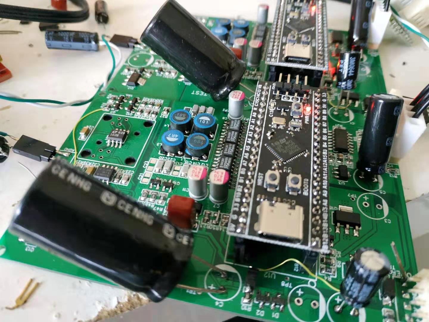

monoDAC prototype
Here is the first realization of an idea I've had brewing in my mind for some time - a mono DAC - i.e. just a single channel on a board. Which channel is decoded from the stereo pair is selectable with a switch as I2S sends both channels to each board. The other interesting aspect here is that its using an ARM MCU to fiddle the channels around on I2S. The filter isn't a separate board as on 'Deca DAC' rather its built-in as the intention is to have filters from now on in software rather than hardware. I've implemented a 5th order Chebyshev and eventually I'll get the MCU to do 2X OS but for now its running NOS.
The MCU daughter board on the monoDAC is a 'Blackpill' which is a cheap and cheerful Cortex M4 board using an STM32F401 (or optionally, an F411). The F401 runs at 84MHz and has a couple of full duplex I2S ports. Blackpills are available (hopefully, with the current supply squeeze on MCUs) on Aliexpress and eBay.

Once I proved the concept - got the I2S peripherals running - the first real experiment was to slow down the I2S. This is something I've done in the past with logic, then at the start of this thread with the STM32F030 helped by external logic to adapt its SPI to I2S duty. This is my first time for doing that using native I2S peripherals. I figured it should be much easier.
But the problem with slowing down I2S is how to generate the new, half-speed clock. A flip-flop is an obvious first choice but it not only has to be divided by 2 from the input BCK it also needs to run in the correct phase. The FF can start up in one of two possible states - a prod into its reset pin driven by the MCU is one way to achieve phase synchronization but I was curious if there was any internal logic (internal to the MCU) which could obviate the need for the external FF with accompanying reset code.
At first I figured a timer might do the job and the F401 has plenty of those, though not all can accept an external clock input. The phase sync problem still remains though which calls for fiddly software. At last it dawned on me that I could use the spare transmit half of the I2S input (F401 supports full duplex I2S) to create the half speed clock. So now I'm using the Data output (outputting 0xAAAAAAAA in 32bit mode) of that port into the BCK pin of the output I2S and it seems to work fine.(*)
The Tx half of the input I2S could also in theory generate a phase-sync'd double-speed WS for when I implement the 2XOS code. With the input fs at 2.8MHz the 2XOS output port runs at the same as the input clock rate, just in 16bit mode.

Very interesting !, could you elaborate about your goals and solution ?
I figure that input I2S adapter is slave (clocked by the transport) and output I2S adapter is slave to, but clocked by the output channel of the input I2S adapter continuously sending a 0xAA pattern, that’s the trick, well done !
What are I2S frames size of your input (from transport) and output (to TDAs) ?

My overall goal here is to adapt my DAC design to be easier to manufacture and hence cheaper. Smaller too if possible. The time-consuming part in the build process (I'm speaking about Dena DAC which is the latest incarnation of my designs here : lingDAC - cost effective RBCD multibit DAC design) is the 7th order LC filter which requires close-tolerance inductors and caps to get a relatively flat FR and well-defined cut-off behaviour. Using 2XOS I hope I can get away with a simpler 5th order filter with wider tolerance components.
But that's not the only goal here - I'm interested in trying out a few things and having a play to explore the limits of what these DAC chips can do. The half-speed I2S is one such avenue. Splitting up the 10 channels (I'm using 5 stereo chips) into two groups of 5 and sending slightly different signals to each is another interesting area which I plan to explore.
Your conjecture is correct - input is slave (16bits filled in 32bit field), output is also slave and fed by the synthesized 1.41MHz clock (16bits in 16bit field). Does this answer your question?

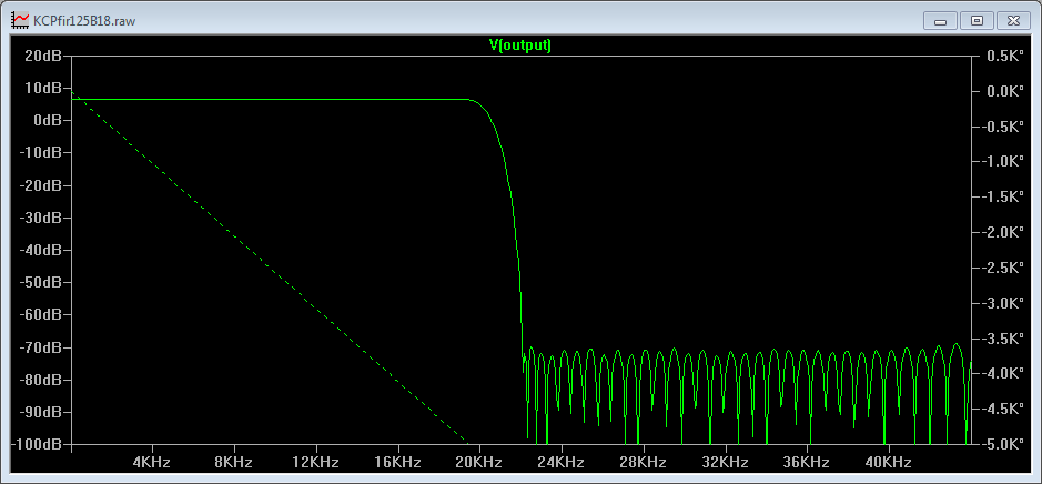

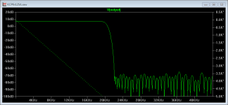

Before writing the code for the 2XOS filter I wanted to play with a few filter responses to see what kind of stop-band performance is possible and how it relates to the precision of the filter coefficients. The online calculator I linked in post #22 is an excellent resource but it only gives the filter response in almost perfect double precision. It gives out filter coefficients in integers but doesn't show the degree to which the response is degraded by reducing their bit length.
I decided to turn to Kendall Castor-Perry's method of simulating an FIR filter using LTSpice's delay line component. This gives rise to the results shown below - the first is the response of a typical 2XOS linear phase filter with 125 taps and 16bit precision. The second shows how the stop-band performance improves with 2 extra bits on the coeffs.
