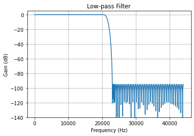

Here's the frequency response of Pacific Microsonics' PMD100 digital filter chip, its generally regarded as the best sounding of its genre. I figured I'd have a go at working out whether a cheap Cortex M4 could implement it.

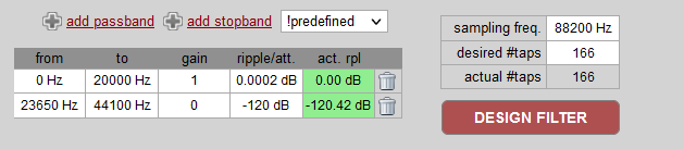

Looks as though the stopband starts just below 23kHz from eyeballing the plot. When I put the parameters into http://t-filter.engineerjs.com I found it needed in the region of 250 taps to implement. Yet the DS for the chip says the latency is 83 input samples (independent of OS ratio selected). That says their filter - which I'm assuming is linear phase - is 166 taps long. So something doesn't stack up, either T-filter's not giving me an optimized set of coefficients or PMI have some secret sauce?
I didn't spend a lot of time on it. It looks like the transition region could be narrower by degrading the ripple requirement in the passband while keeping a good actual ripple.
I spent quite a bit of time with it and found its quite easy to send the Javascript into weird spasms where it ignores one or more of the parameters and/or gives a non-flat stopband. I wanted a second opinion so I downloaded the 'Anaconda' package which has a Remez exchange function. Its even more pessimistic about what can be achieved with 166 taps than T-filter but its very early days for me in running Python, I'm a total noob.
My first stab using Spyder Python, 166 taps, transition band 3kHz.
Having looked in a little more depth into implementing a 2X OS filter, I'm now doubting that my interpretation of '83 input sample delay' into a filter length of twice that number is indeed correct. Here's my updated thinking - take the case of 2XOS, the output samples will be generated at 88.2kHz. If the filter's 166 taps long, that filter's total length represents 83 samples @ 44k1 but the group delay of a linear phase filter is half of its length (the impulse response is symmetrical about the centre point). So that group delay would correspond to only 41.5 input samples. It looks therefore that '83 input sample delay' actually corresponds to 4X that number of taps in the filter, i.e. 332.
