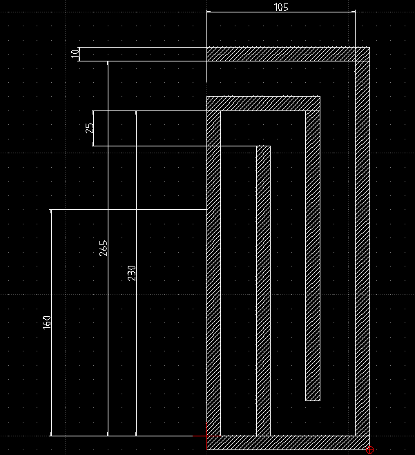

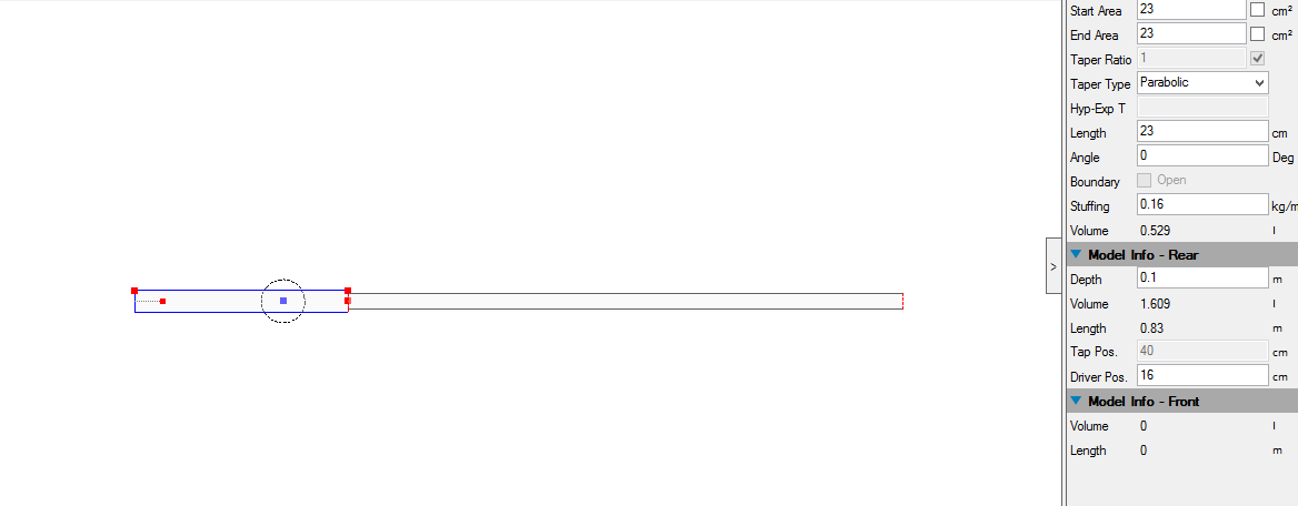

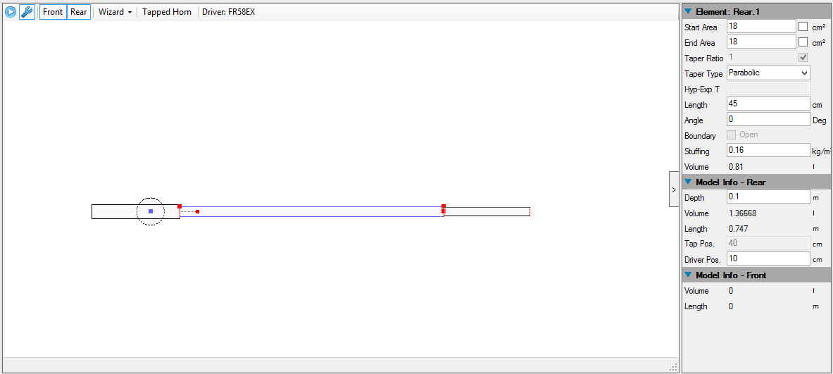

Actually i tried to develope a tml speaker myself, and it looks like this (driver is the FR58EX). What do you think about that?
The CAD-picture is from the side (top-down).

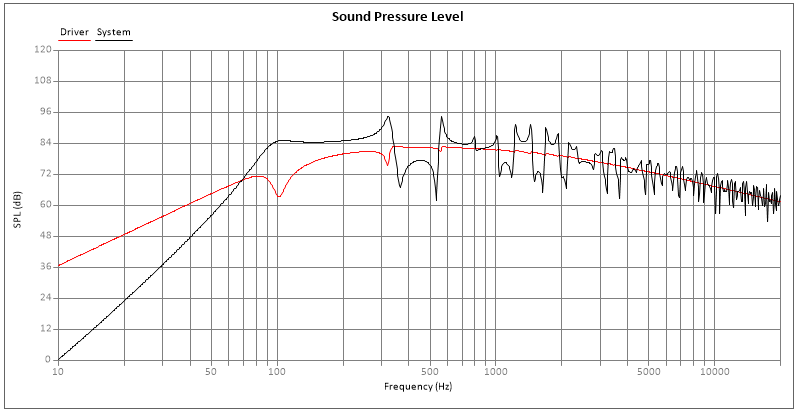

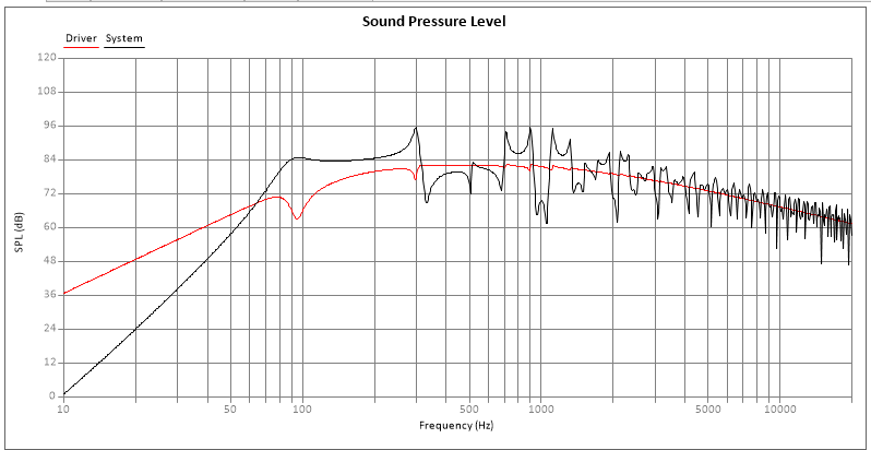

Looks OK. F10 just above 80 Hz (ie they don't go very low). Be nice to see a sim with the real results of damping included.
dave

Okay, i forgot that the driver is 3.64cm thick so the first tml part must be a bit wider (now it is 3.2cm + 1cm Wood = 0.5cm space).
Hmm, a lot of trouble for a 2" full range, but I think it will work. Keep one side open to experiment with stuffing. You may still want to augment them with a subwoofer, but they should be fine as is for computer speakers etc.

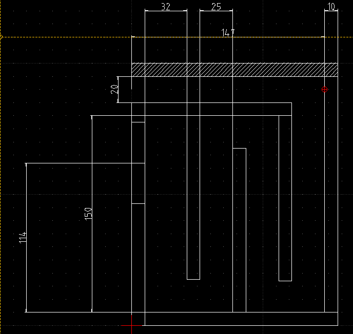

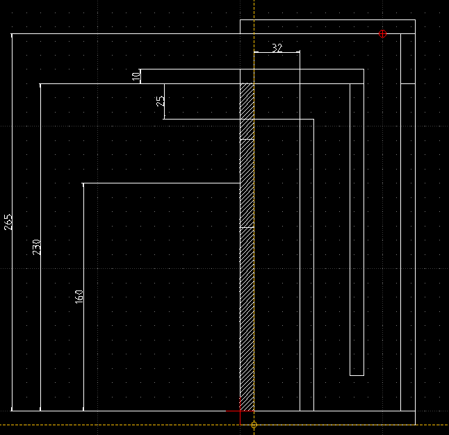

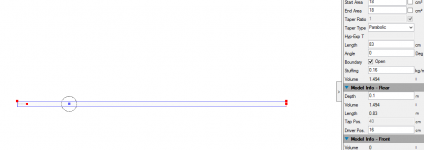

So it's me again,
i actually re-thought my last plan and made a new one.

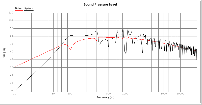

The box is now deeper (which i like more) and smaller (.25 liter). 85Hz@-5db.
Which one you think is better?
