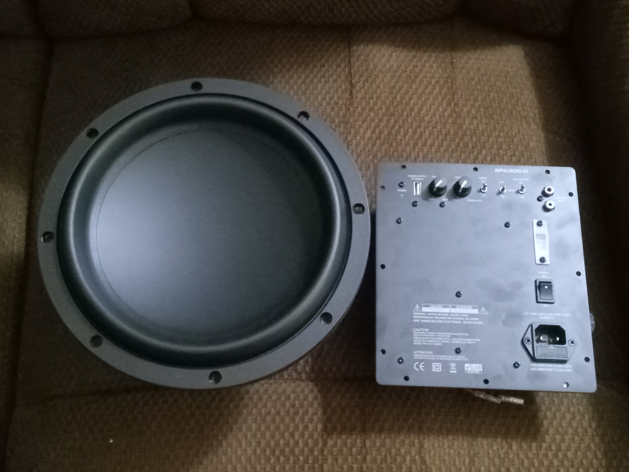

A sub on the cheap, it's hard to do right i think. The GRS 10SW-4 Subwoofer (for sale on soundimport for 40€) is maybe a good candidate for that, in a 100L sealed (use min 18mm mdf for this if it needs to be cheap). F6 is about 31Hz like that and max volume at 30Hz is 98dB before you run out of xmax. Cheaper than that is not possible i think, i build that sub for someone on the cheap and total project was 150€ (user had an older QSC amp and dbx analog crossover already for it). It gives bass, not the best or cleanest of course, but it gives bass till relative low and relative ok in sound.
So I just had a look at both that GRS driver and the pioneer speakers you got and I must say: even though the GRS is a very low budget (high value!) Sub, it will absolutely blow you away compared to those Pioneers! The magnets on the woofers of the Prologue 4 are not quite as big as a hockey puck. But whatever, if you like the sound then all is well. 👍

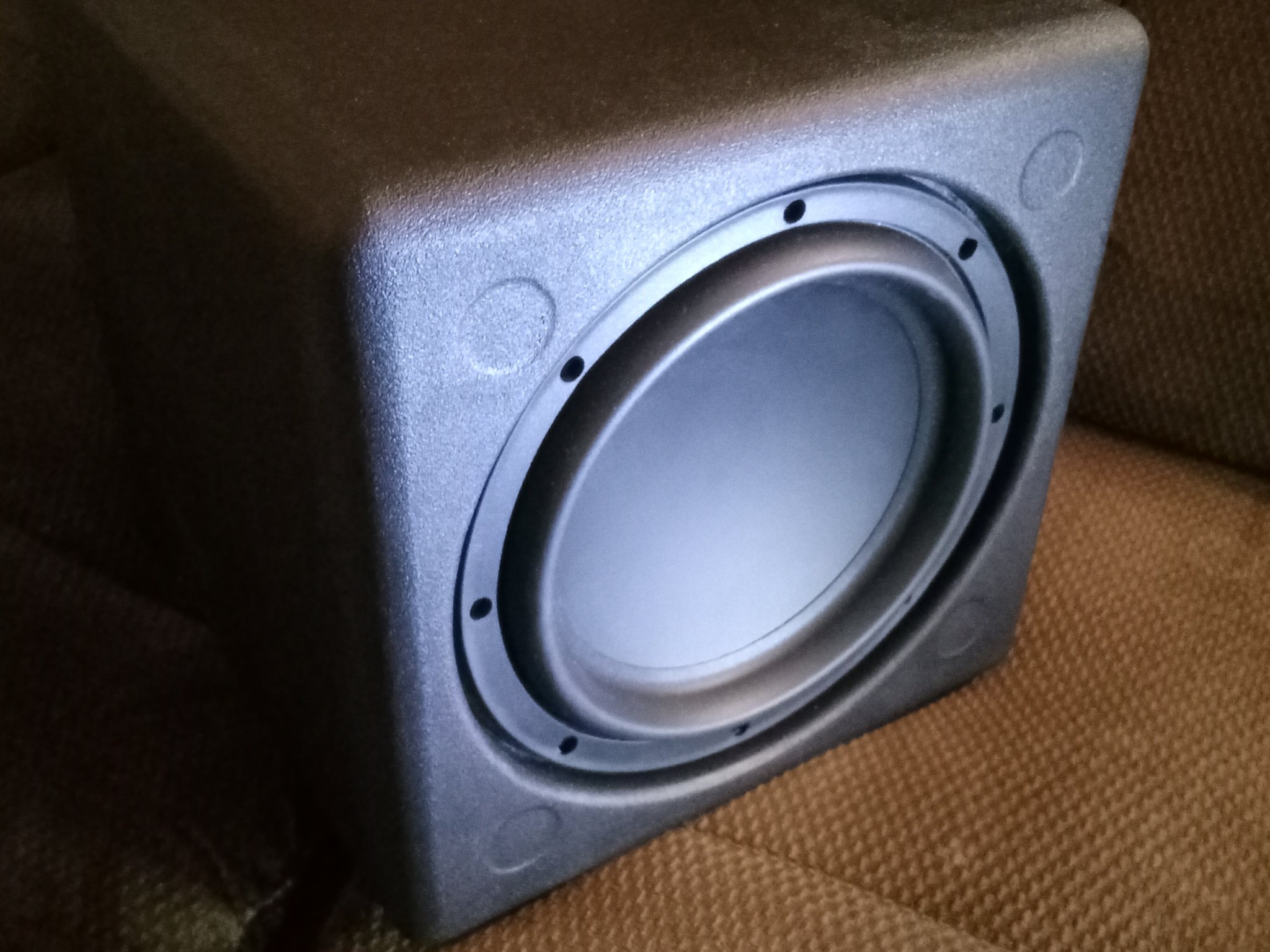

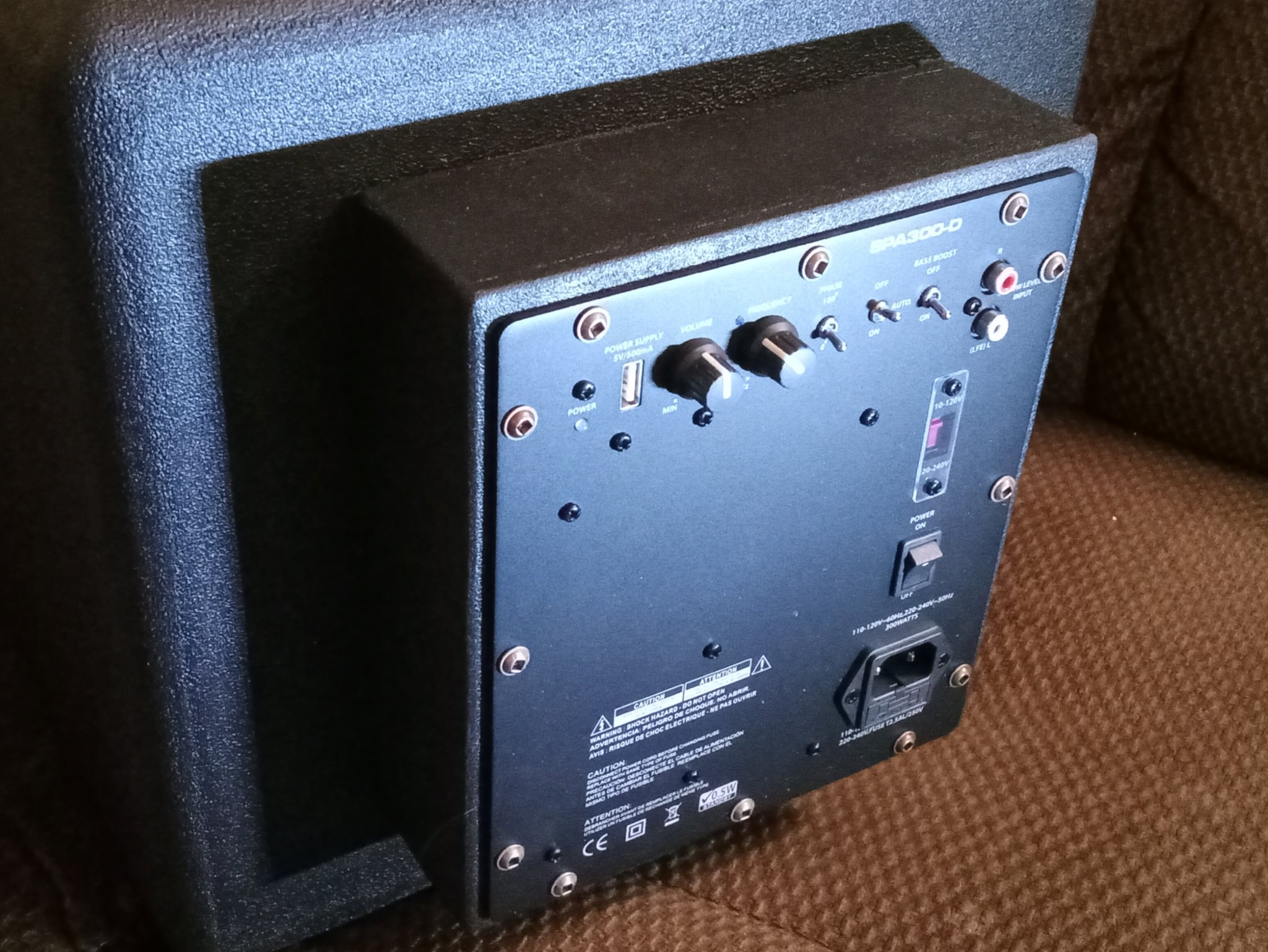

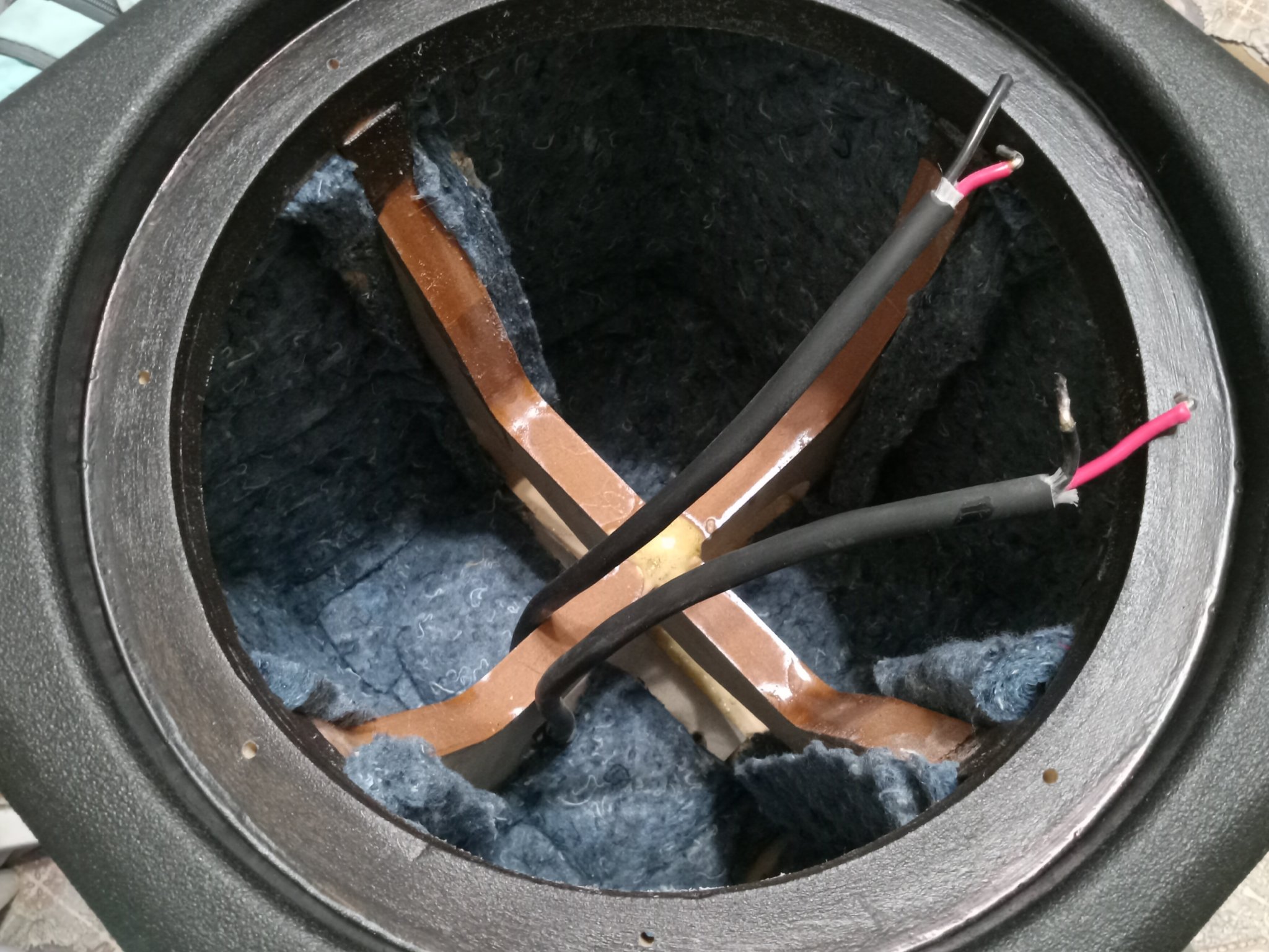

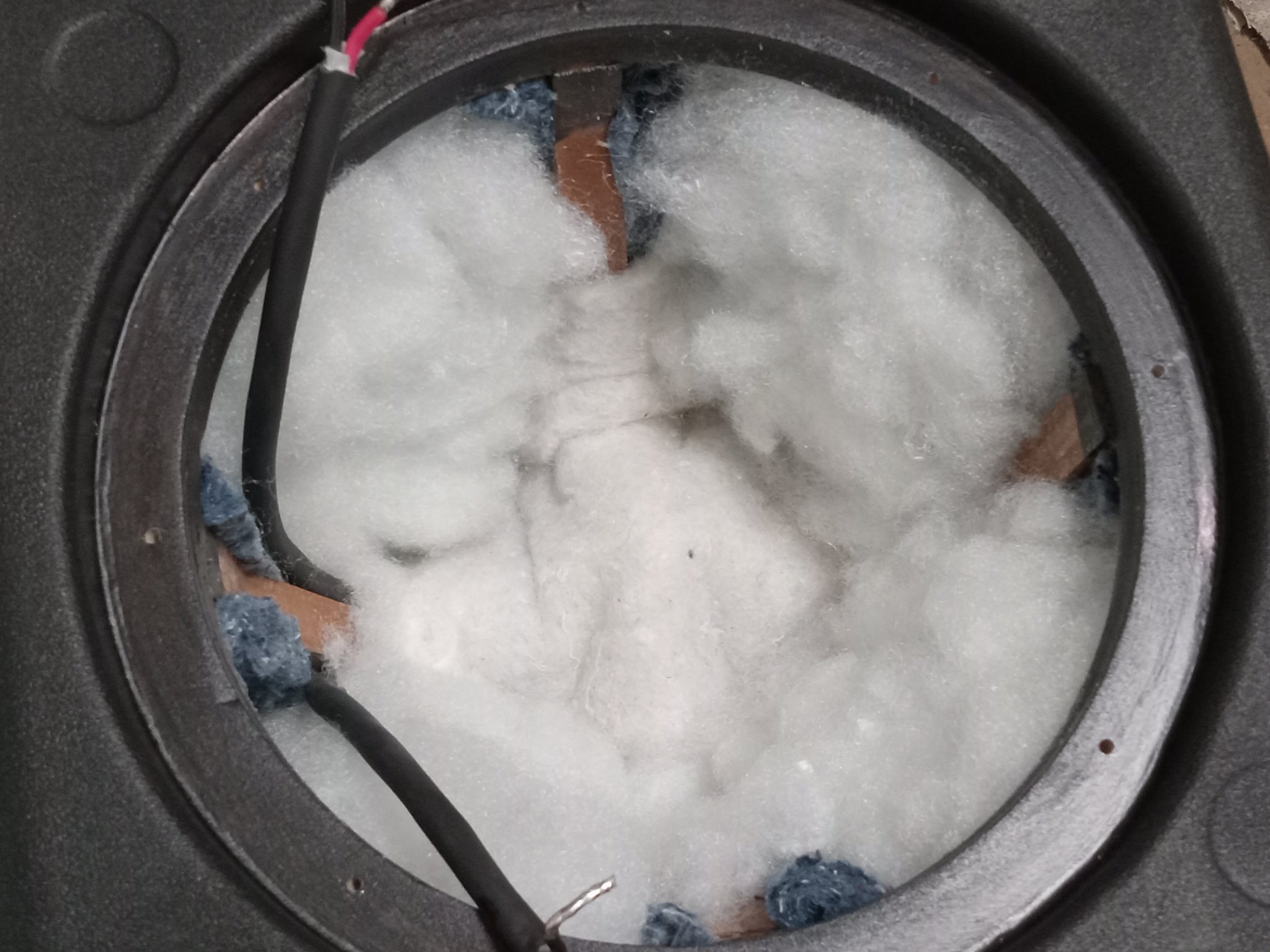

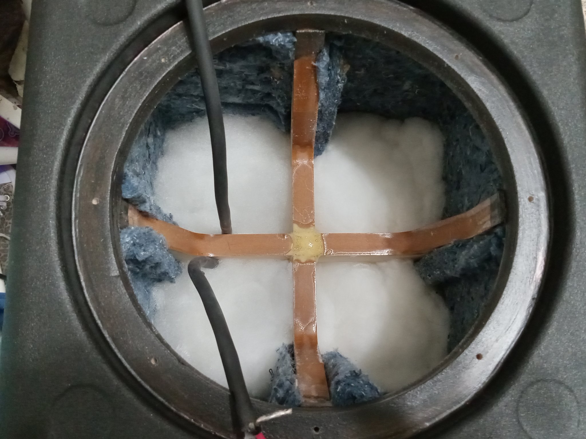

0.75ft^3 sealed and moderately filled, with Dayton MX10-22 and 300W Class D amp with boost on.
This is a very affordable 10" sub plan that will impress you. I never named this one, but there isn't much to the design here.

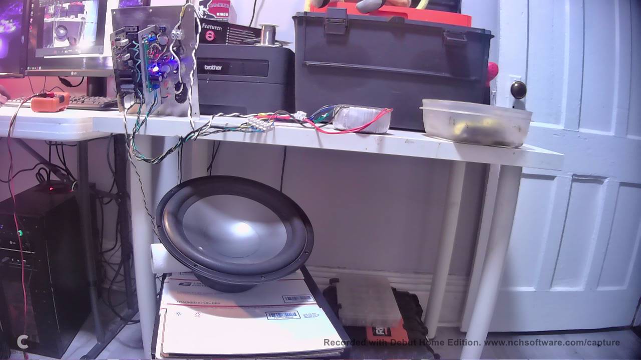

I almost screwed up , I ran that Polk sub at 14hz (Youtube 14hz test), Started smelling a slight odor !! I think I overheated the voice coil , but ... I was getting

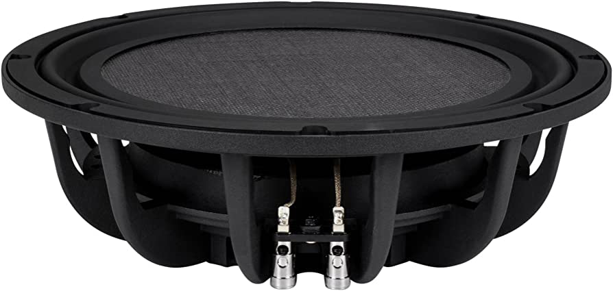

20+ mm Xmax at @200W with that amp.
The Woofer still reads 7R and I could see the coil ( not darkened) . I might just buy a real SUB (dayton audio LS12-44). Cool flat piston woofer (below 2).
T/S specs of the Dayton seems to match my 60L polk box. I'll just sell the POLK 12" driver for 20-30$ , It sounds alright in it's box now - I can shake the whole building. I don't know IT'S T/S params , it's very stiff and has a F3 of 26hz.
I just like the "space age" flat piston of the LS12-44 !!

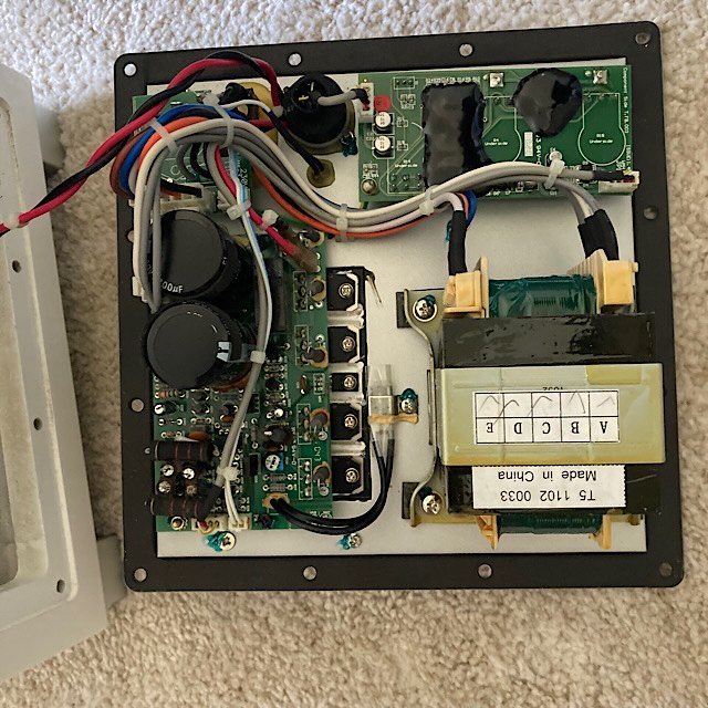

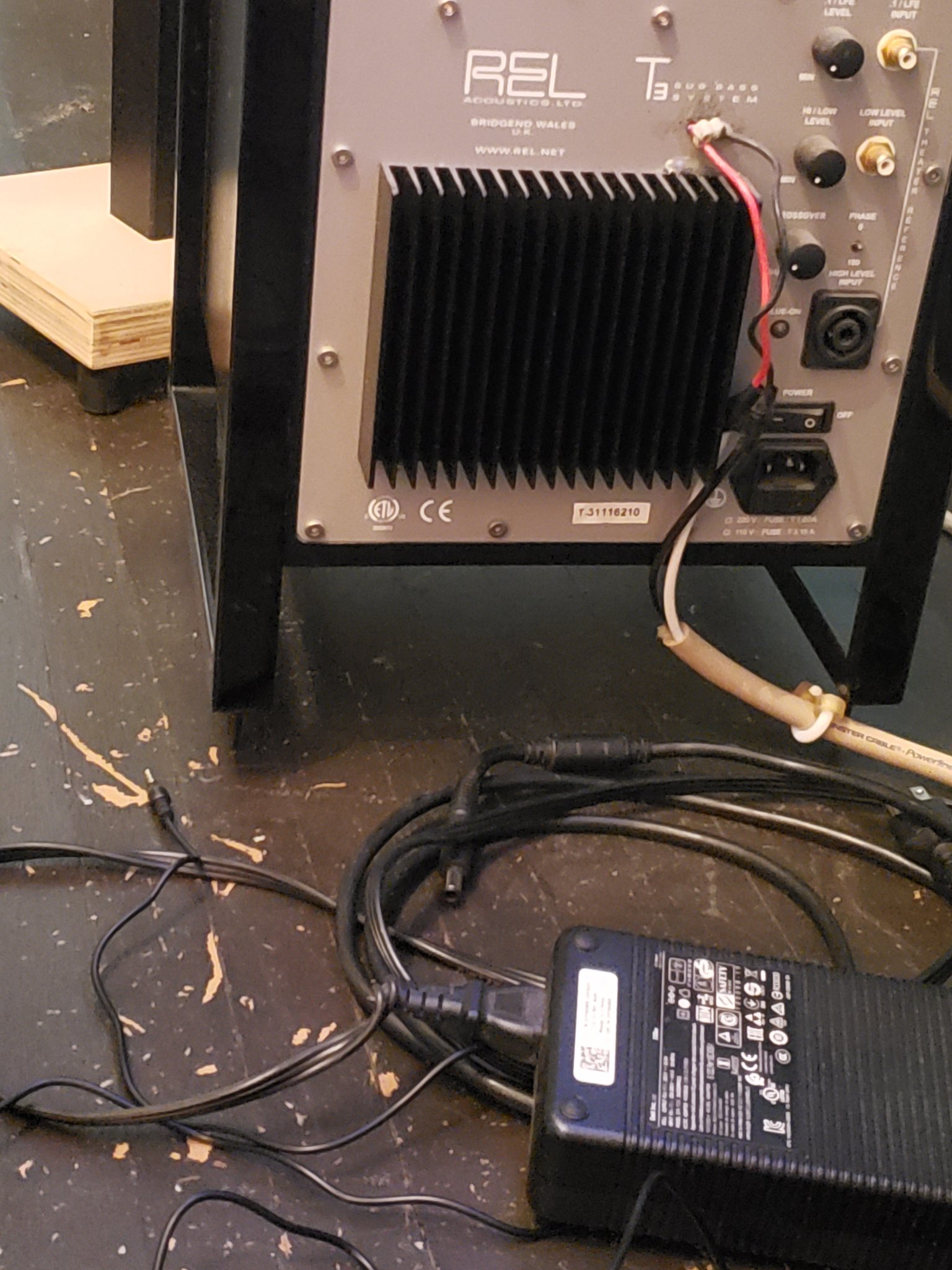

BTW the amp in my T3 bit the big one, ie sold the farm and quit working.
I can see why. Nice materials , but hot zener regulators for the input board. having that hot E-I trafo on the plate is also stupid. I mount my
(cool) Toroids on the floor of the sub box and have a nice cool regulated LM7812/7912 low voltage supply running from a separate
secondary. REL definitely outsourced the design with "penny pinching" in mind.
So many plate amps I have seen "cooked" .... I overdesign to the max , over- rating caps and semi's and keeping everything cool as possible.
Amps in sub boxes are in a hostile environment.
