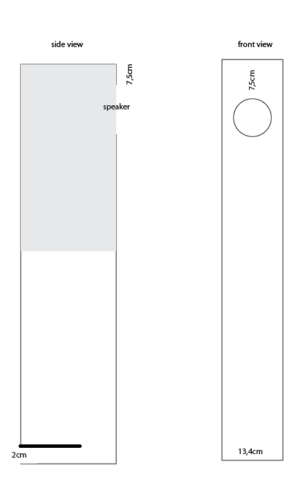

Yeah i know they are rated for 15 w, my amp is rated 13w. I use it with a noname solid state riaa pre. But seeing the cone come out this far with the volume at 50% I didnt dare to turn it up higher.
The design is a mixture of ideas. I used a friends TL as example, but folded it to keep it small. I tried some guessculating and came up with the length of around 100cm/110cm. Which is to heigh so i folded it. De lower part is filled with sand to give it more weight.
Still the blake record sounded awesome but the dark dark dark record sounded kind of dull
James Blake - Limit To Your Love - YouTube
Dark Dark Dark - Daydreaming (Official Video) - YouTube
How hard can I drive the speaker? I did have my amp (iTube) volume knob 50% and didn't dare to turn it up higher...
the whole construction is filled with pillow stuffing. but how much should there be? do I stuff it lightly or completely full and tight?
another question I have is how big the hole on the backside should be?

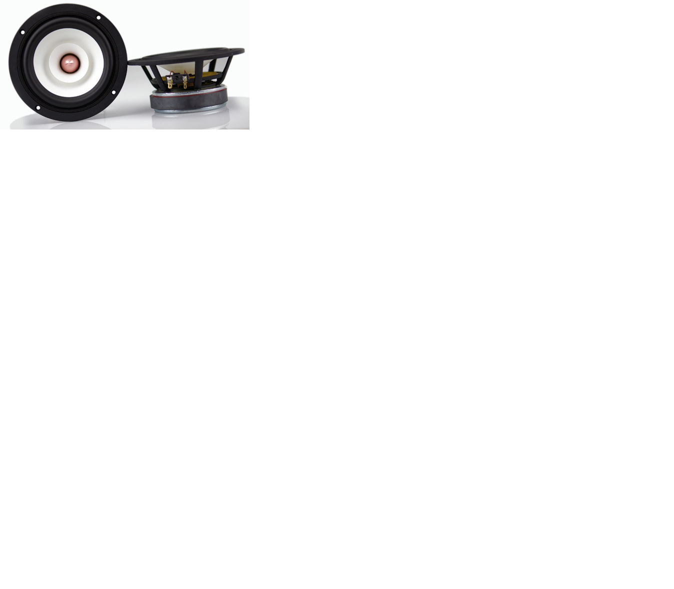

Almost certainly a Guide Sound (the people who make the Audio Nirvana drivers) unit. Slightly different to the AN drivers, but based on the stated figures similar inasmuch as there are few quality reflex alignments available, and those that are, are large by current standards. If you want flat, about 19.5ft^3 tuned to 25Hz will get you ~'close enough.' Of course, a flat alignment is very rarely useable in-room, so you'd probably need to drop Fb to about 20Hz for something more practical. Sealed, TL or leaky sealed (what's often called aperiodic) would be preferable.

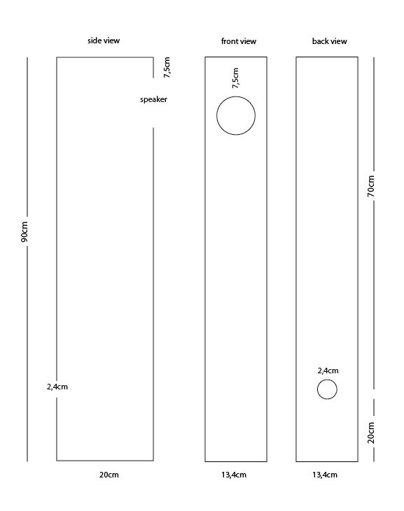

Ok well the driver specs are found in the first post but i'll attach them again since were at page 17.

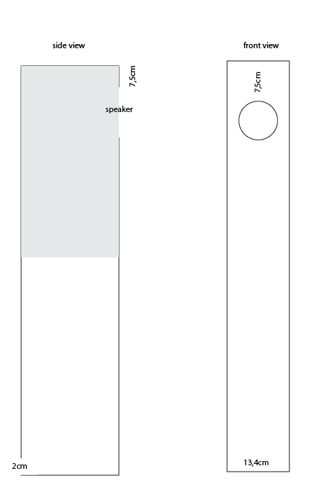

the cab specs are attached, the wood I used is 12mm powerplex. the total size of the inside "tunnel" would be 120cm x 11cm x 8,8cm filled with pillow stuffing.
As I said before I'm a compleet newbie and trying to use all the combined information I find on the web.
I'd love to try a frugal horn but it's just a bit bigger and I need to take into account the WAF. I can put new speakers in the living room but they can't be bigger than the previous speakers...
the previous speakers being: 90cm x 12cm x 20cm

ok, I've removed the middle piece, filled it half with pillow stuffing and made the opening smaller at the back.
the bass has improved but the middle really sufferd...

Ok, just wanted to make sure which version you’re using.

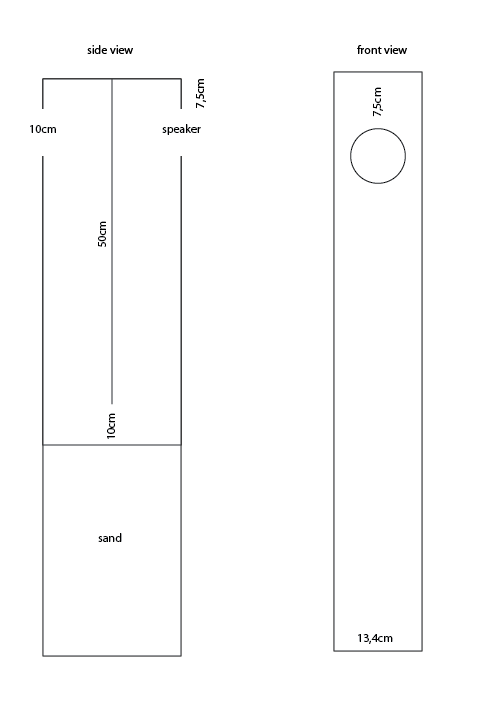

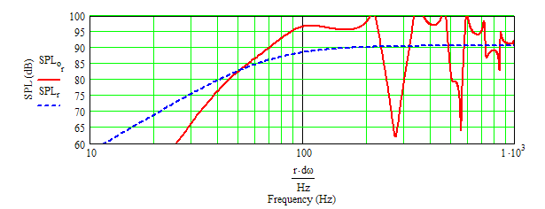

Hmm, your design has a ultra ‘fast’ expansion/contraction through the bend [its area is ~13.6% larger] that I’m not set up to sim, so can’t do as accurate a sim and never having experimented with different ‘choke’ points, no clue then how it might affect TL pipe action, if at all at this relatively low percentage.
I assume that the 10 cm vent is a circular hole and that it and the driver cutout is down 7.5 cm to their centerlines from the inside of the cab.

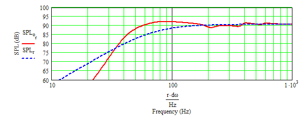

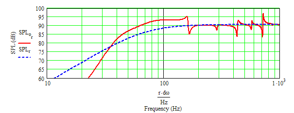

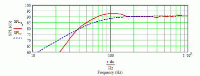

Two sets of default reflex cab alignments can be made with the published specs, 13.709 L/51.78 Hz [using BL, Mms] and 19.591 L/51.95 Hz [using T/S], so using T/S for your cab…………….
The 1st sim is with no stuffing and we see that it has a much too high an aspect ratio for its net volume [Vb], ~70 Hz pipe tuning, so adding any damping will just further reduce [mid] bass output and enough stuffing to damp the dip requires more than the software can sim!
Little wonder then that most recordings will sound dull if heavily damped enough to minimize its 3rd harmonic dip up around 280 Hz, so better off overall to remove most of it and seal up the vent.
To deal with the dip and tuning requires moving the driver down to ~41.86 cm and the vent down ~24 cm and reducing to a 2.4 cm diameter hole to lower tuning to ~52 Hz [2nd sim].
Now, a minimal amount of stuffing along its length [0.25 lbs/ft^3 of polyfil] smooths it right out with a nice amount of mid-bass baffle step compensation [BSC] and/or a bit of mid-bass ‘slam’ if near a wall or corner, though still not much bass as the driver’s Fs is too high and the cab is too small [3rd sim].

Using your previous speaker dims and keeping the driver at 7.5 cm, a 2.4 cm diameter vent down ~70.1 cm yields an acceptable response with somewhat more bass at the expense of some mid-bass, but still a better overall alignment in general and especially if it can be near a wall or corner.

Wow! GM Thanx! So I guess loosing the sand and making the box bigger would be better. What software are you using?

Ok just to be thorough I've drawn the new cab plan, I'll be using your suggestion of [0.25 lbs/ft^3 of polyfil] can't wait to try this![]()

I see I forgot to mention that all my dims are inside [i.d.] and assumed it would be made from 1.2 cm thick material, but the minor differences between i.d. and o.d. are insignificant.
Just to be sure we’re on the same ‘page’, the dims are to the hole centerlines.
