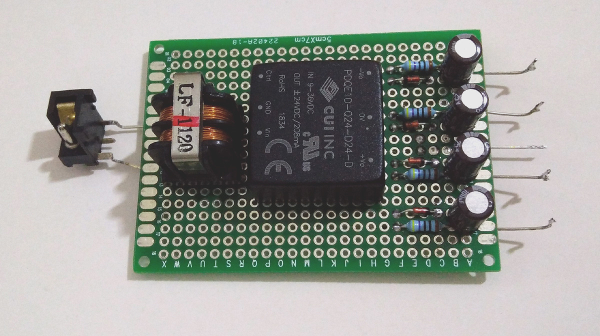

Then we put the Chipo on but starting with SMPS (IBM 15V laptop adapter to +/-24V DC/DC to RCZ +/-15V dual branch outputs). It showed some potential but the PSU must have been holding it back. Had dynamics still a ghostly thin haze was lurking at the back and a hint of contrived instrumental tone was there. Bass good but not so well driving. No hum no buzz. Looked very clean via FFT on the bench before taking it to the rack anyway. Gain 62dB in combination with Jensen JT-44K-DX step up transformers.
