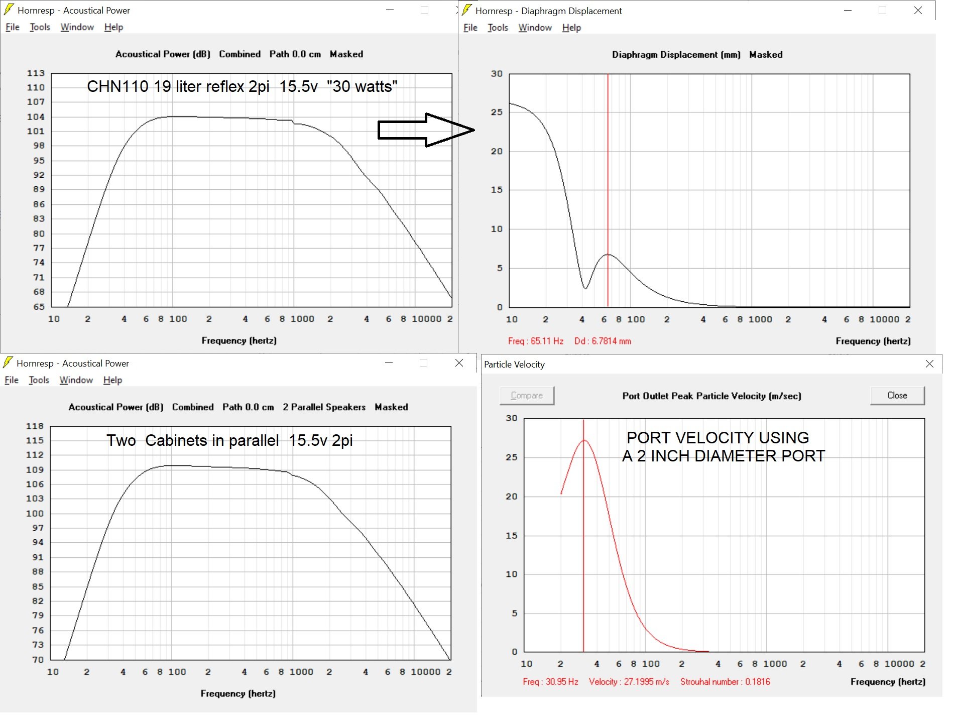

CHN110 for hip-hop /rap bass drop duty?
two in a 38 liter reflex look potent - a decent - well tuned passive radiator might be the way to go. Would they noticeably "gargle" ?
- if so, I'd do it as a "FAST" with a paper cone above the 110 "subs".
@sdsddsd1 - tell me about your resistive vent - did you tune it via impedance testing? - How is it made? There's some plumbing drain grates which would look nice - I guess a piece of "hardware cloth " wedged in would compress fiberglass, etc. Does bonded Dacron work well for resistive vent duty?

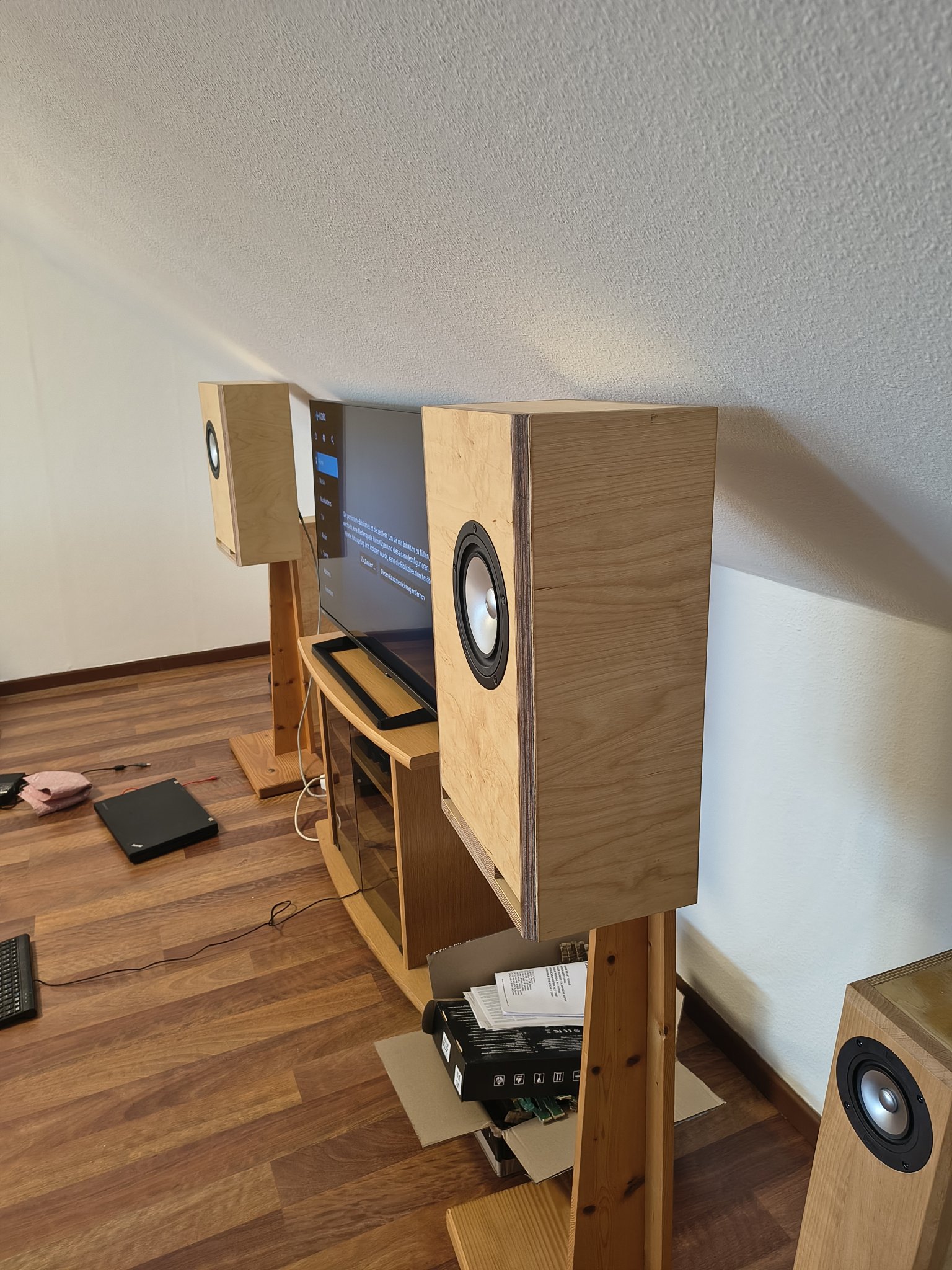

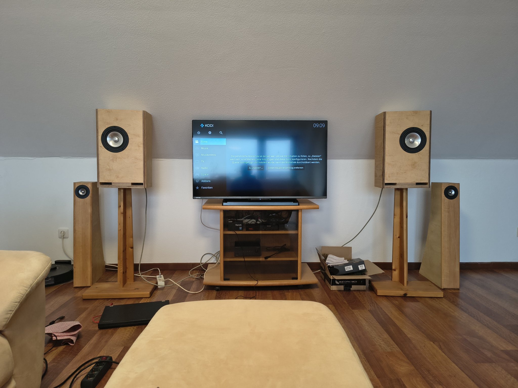

Its a reflex with long aspect ratio pushing it more towards aperiodic from dave. Limiting extension in trade of more refined bass. No design by me. A normal reflex does reach lower. But given the nature of the 110 this is a bassable box. There are 3 different sizes available
