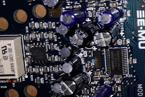

So you replaced all the op-amps, inputs and outputs? Did you recap the 1820m first?

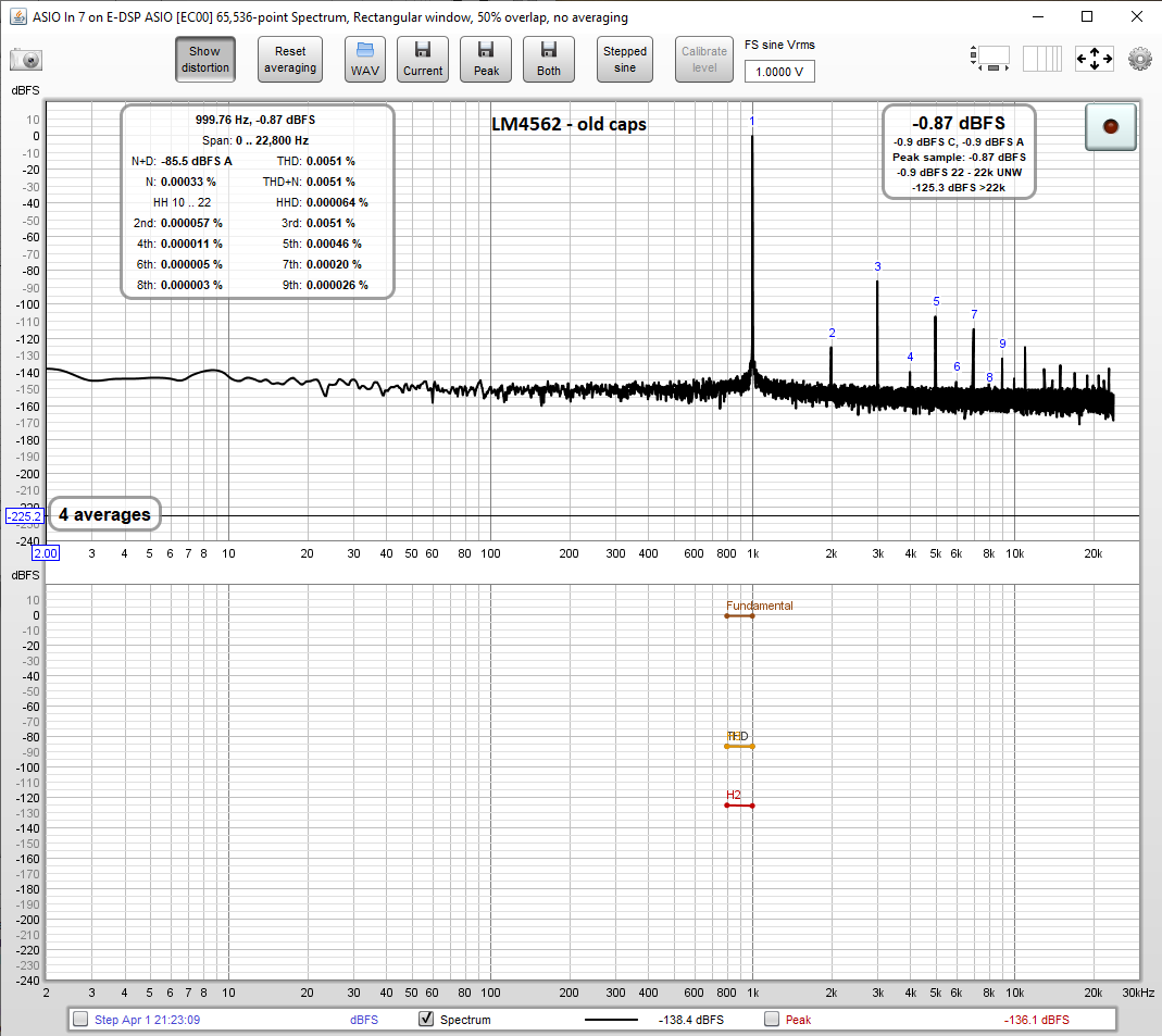

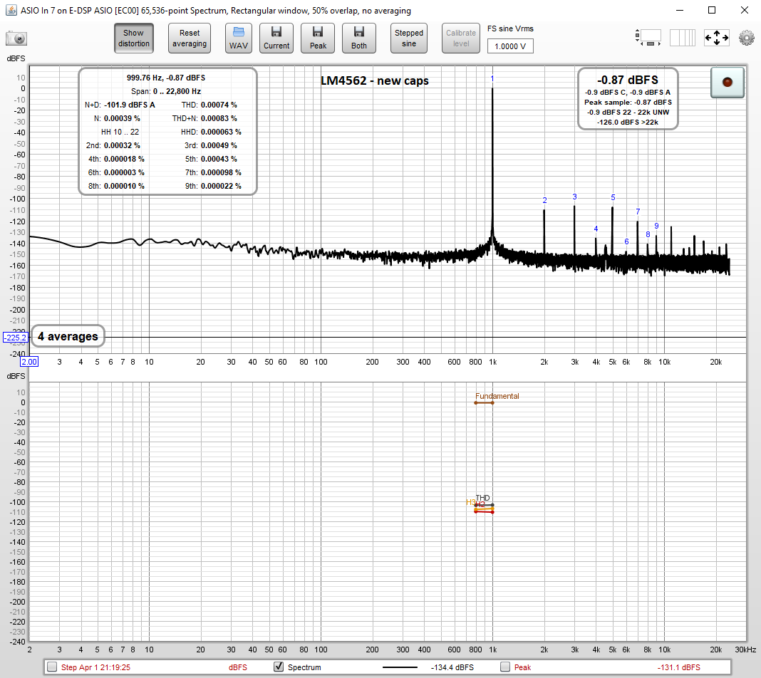

I just recapped 2 channels of my older 1820m with LM4562 in it and tested the result before moving on to do the rest. Very interesting results, and thank you once again for pointing out what you found with respect to caps in yours; these charts quantify what old electrolytics can do. They represent loopback both before and after a complete recap in both ADC and DAC (and PS section). The charts are actually for two different channels (1 - recapped, 3 - old caps). Channel 1 has always shown a bit higher harmonics than all the others and its before state was slightly worse than the "before" posted below.
Glad it helped. I am guessing that the removed FILT caps measured pretty badly after removal.
Which channel is ASIO 7 physically? And 8? (I ask since I am wondering why the full scale/peak signal is different. One near -3 dBFS and one near 0 dBFS.)
After I replaced all the 47uF 16V blocking caps all my channels measured at almost identical levels. (They were all over the place before replacement.)

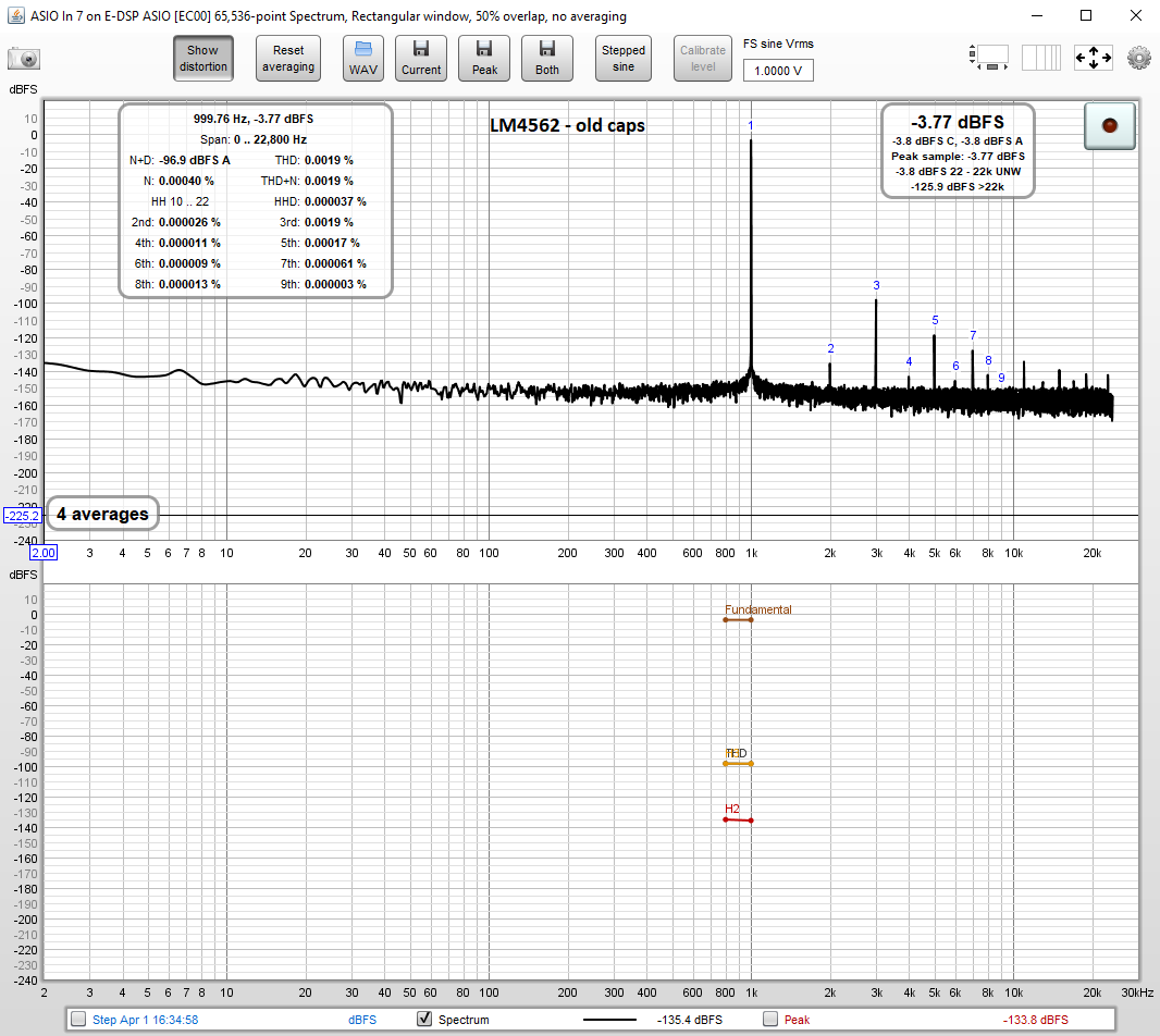

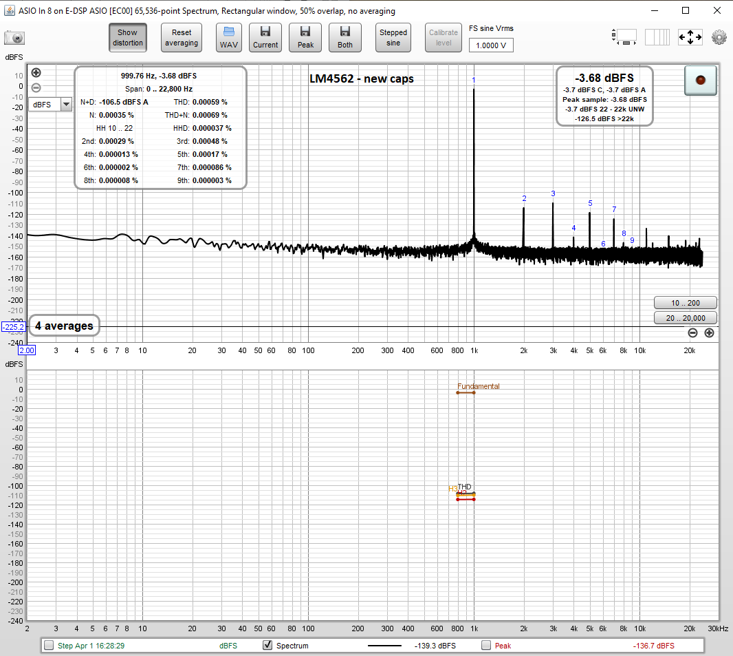

The ASIO is just how I have it routed in the mixer to do the test of DOC I/O 1 and DOC I/O 2.
The first two charts are for -3dBfs and the software labeled it -3.77 and -3.68. The second two charts are for -.1dBfs and got labeled -.87...
I recapped with Panasonic using FC as first choice when possible and M when not available in FC. The DACs turned out to be all 105 degree M. The ADC is mostly 105 degree M. I did FS for power (10K hrs).
The subjective sound is incredible. I still have some channels of 2068 with old caps, so can A/B and the difference is shocking in a very good way. It would cost some serious cash to get 8 channels of this quality.
Also FWIW, the 1820m with OPA1656 in it hasn't been recapped yet but they chart to still be reasonably healthy. The subjective SQ of DAC in that one is even better. I'd like to put 1656 in this old one but one of the pads began to break lose from the board while attempting to remove a 4562, so not going to risk it... It sounds great with 4562, but the 1656 is a a bit better IMO. Both are getting a small external centrifugal fan to force ambient air thru them. And I'll be using the 1212m card for daily mixing sessions since it can get plenty of cooling and all I need is a stereo out for that...
The 1820 and 1616 have ceramic (likely X7R) surface rail caps but I have not removed any to measure the value. I don't know about feedback caps as I have not traced out the circuit that E-MU used with the original NJM2068. (Since 2068 is a dual and 2x34 is 68 I wonder if the NJM2068 is intended to be a souped up dual 5534?)

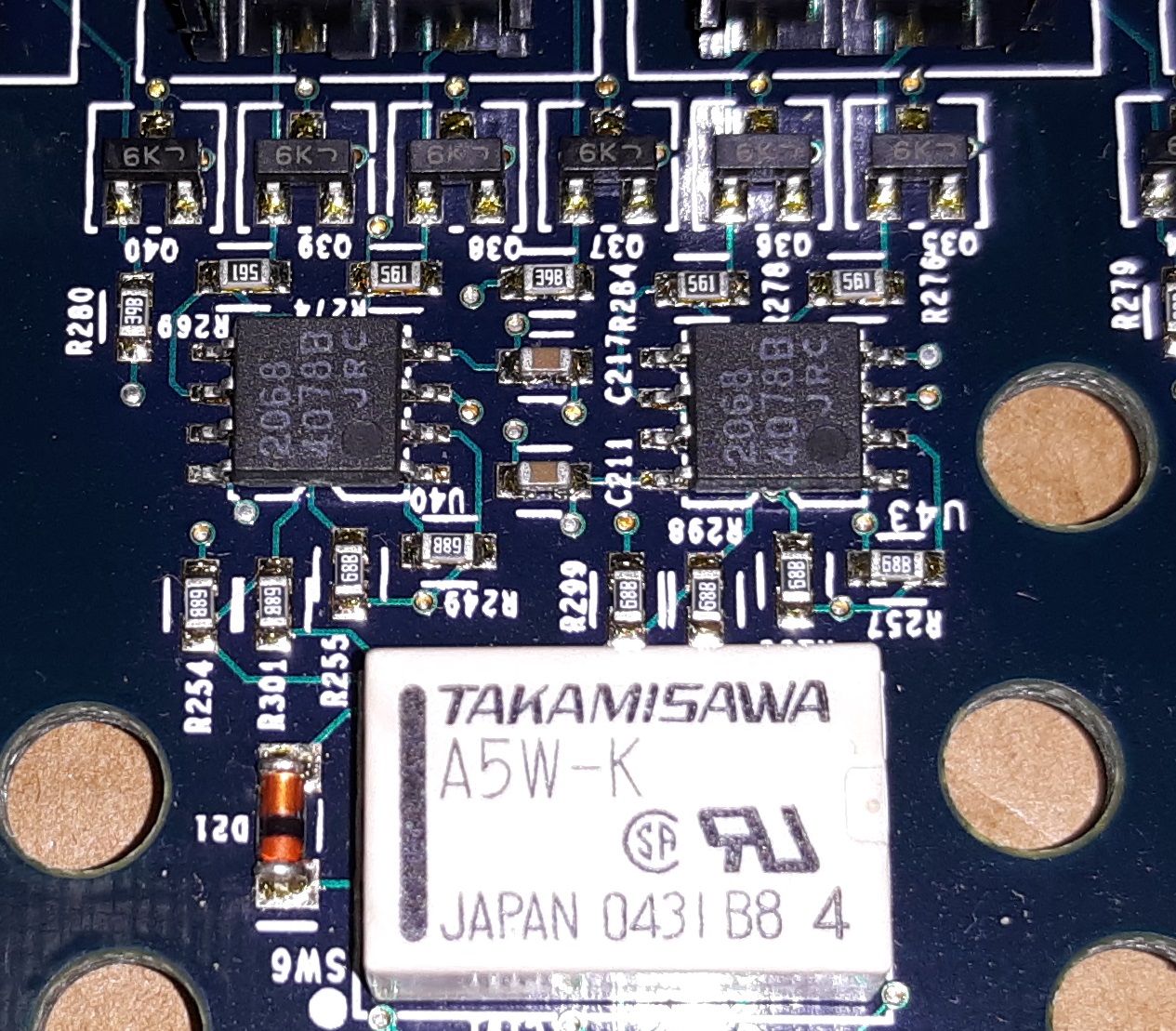

I don't know if anyone has traced out the E-MU circuits. Attached is the CS4398 DAC filter (first, lots of SMD caps) and second is the balanced output driver (no extra SMD caps).
The EIA-96 SMD resistor code 39B stands for 2.49 kΩ / 1%
The EIA-96 SMD resistor code 68B stands for 4.99 kΩ / 1%
The 3 digit SMD resistor code 561 stands for 560 Ω.
I haven't seen anything on the net... But FWIW, products like the 1820m and 1616m are usually based on the chip maker's reference design. For the CS4398 you can find it in their product eval board datasheet:
https://statics.cirrus.com/pubs/rdDatasheet/CDB4398.pdf
I've often found ref designs useful for "educated guess tracing" a section. 😉

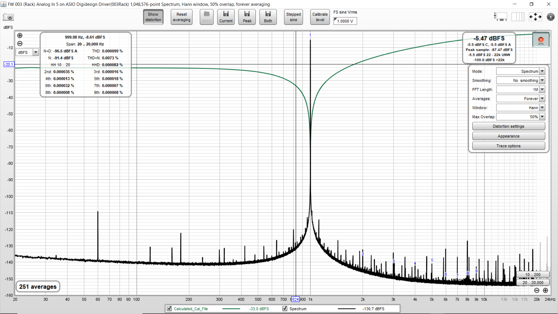

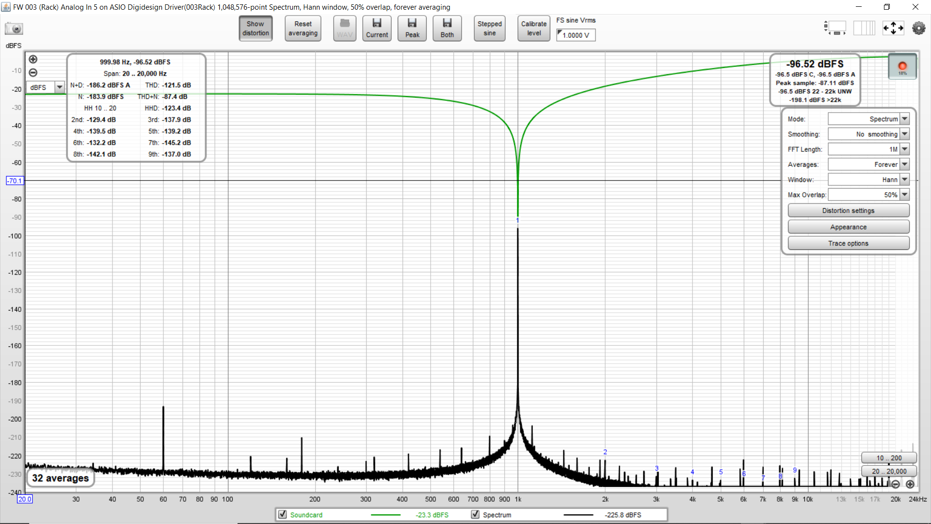

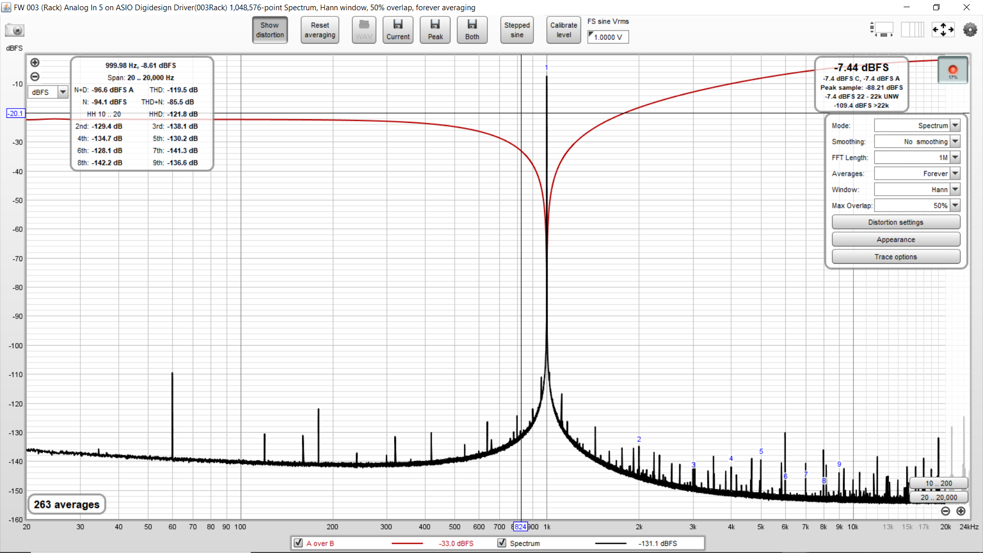

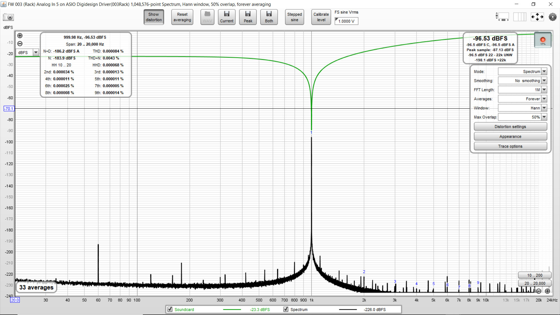

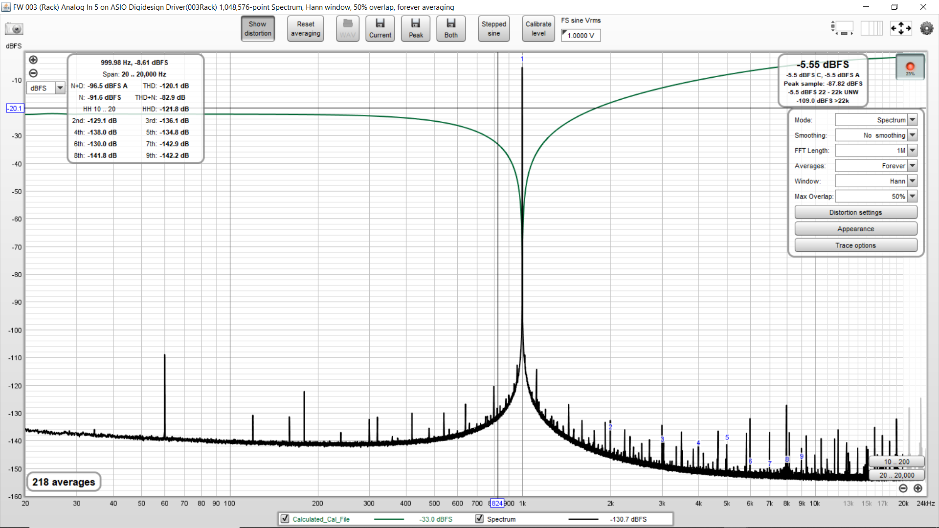

Just a couple words of caution regarding trying to evaluate op-amp swaps with a simple loop-back on the interface being modified:
In the attached example the first two images are a CS4392 DAC with OPA2134 op-amp for the filter. The second two images are the other channel of the same DAC chip and that other channel has the stock NE5532 op-amp for the filter.
This is inside a modified Digidesign 003 rack with improvements for clock jitter and noise on both the analog and digital power supplies.
The measurements are being made with a nearly 90 dB 1kHz notch filter. (Made as stable as I can make it so far.) From this experiment I am finding that it is very hard to measure the difference between op-amps on modern ("good") DACs/interfaces because the distortion is so low that most interfaces will have trouble measuring the results. Not only is the ADC a limiting factor but noise is also a problem. I am using 1M FFT points and 32 averages. For very good op-amps the DAC, ADC and power supplies seem to be greater limiting factors than the op-amp I am trying to evaluate. For example, using a notch filter the stock humble NE5532 looks far better than when initially evaluated without a notch filter.
So if you are just doing a loop-back test without notch filters or other fancy test equipment you might not be able to measure the impact of the op-amp swap.
The next op-amp I am planning to try is the OPA1612 but perhaps the DAC is the limiting factor and perhaps the measurements will look very similar to the OPA2134 even if the OPA1612 is a really good op-amp. At this point noise and ultra low noise supplies might be the last area I should put more effort into for this interface.
Note that the software is taking 1kHz as "0" insertion loss (it is actually near -90 dB insertion loss) so the levels end up (mathematically) being reported as very low.

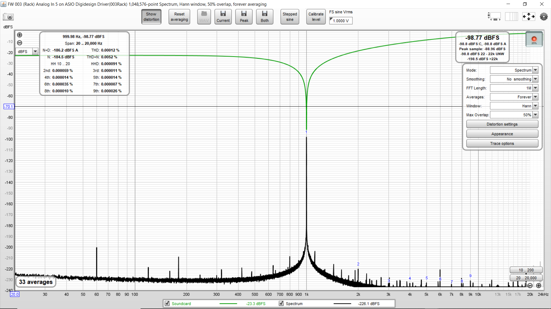

I repeated my measurements by creating a better calibration file and also using the manual fundamental feature in REW. More details can be found here: Howto - Distortion Measurements with REW
The new results of the CS4392 with stock NE5532 output filter is attached as image 1. CS4392 with stock OPA2134 output filter is attached as image 2 and in percent as image 3.
Now the results are pretty much identical which is not what I was expecting. I guess I am measuring the CS4392 chip more than the op-amps. (The measurements are of two halves of the same DAC chip, one half with NE5532 and the other half with OPA2134.) Before building the notch filters I was mostly measuring my ADC (I think). At least with the notch filter I can get beyond the ADC distortion limitations. Perhaps adding an LNA will help. The red line in the images is the response of the notch filter.
