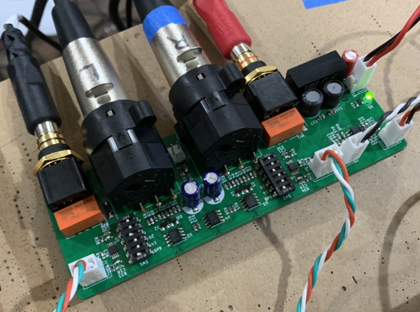

I made three preamps (actually Vunce built them for me
): one with OPA1656, one with OPA1642, and one with LM4562. IMO, the 1656 and 1642 were very similar and great sounding - natural and very enjoyable. The LM4562 was “drier” but still very good. Given a choice, I would pick either 1656 or 1642, depending which one is in stock. But given the parts shortages, the 4562 is not a bad substitute. I did use OPA1637 balanced line drivers on all of them.

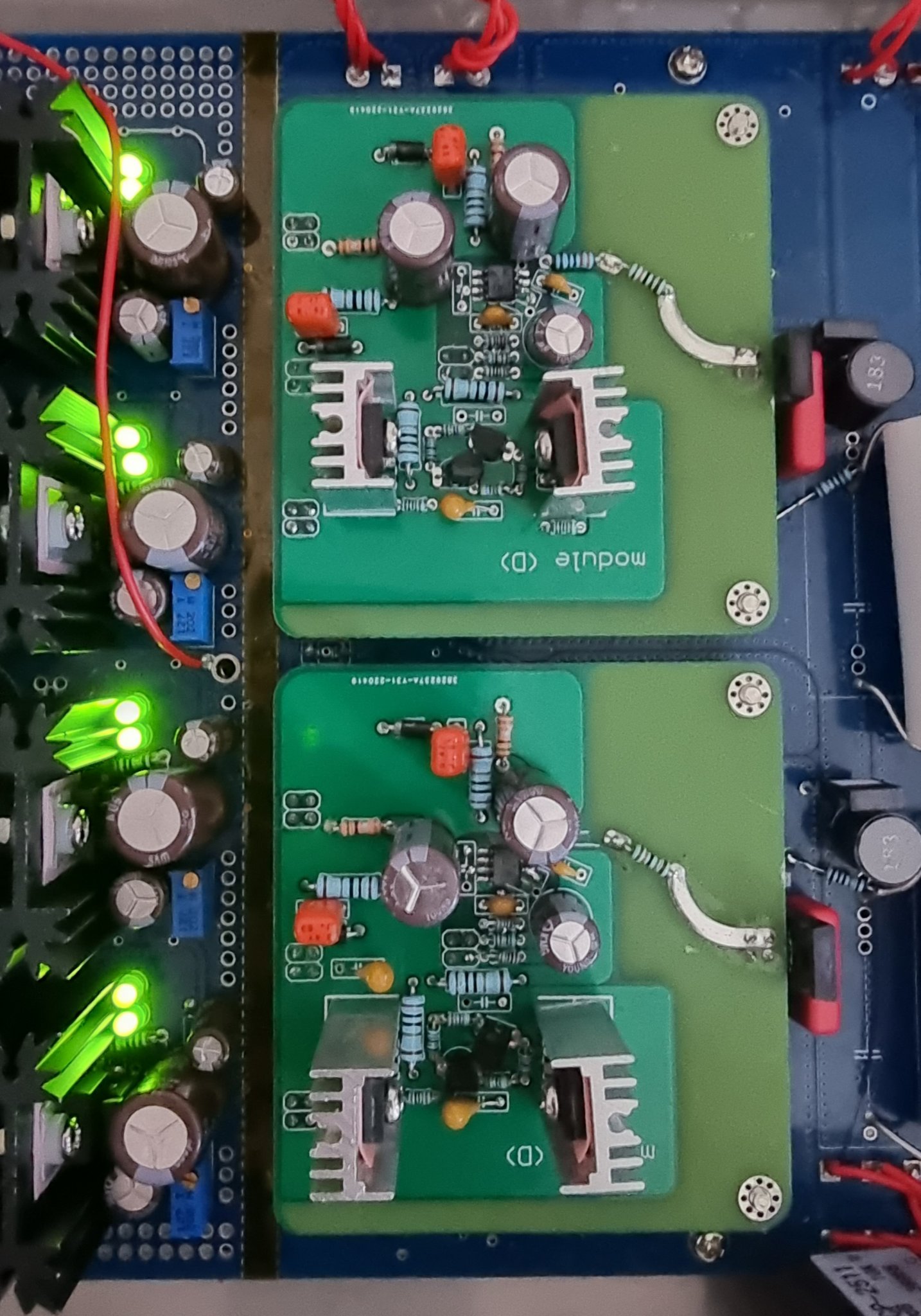

Check out this buffered opamp module i use for my dual mono preamp. Ive tried 5534, 1655, 1641. With the latter two its simply nirvana. The module has pretty much an ideal opamp layout (taken from the AD guideline) and it beat all of the dozen other circuits ive tried for this preamp including buffers and discretes. 16xx series ftw 😁👍
Nice. Similar to the three I tried (but mine were the dual opamp variants). I agree the 165x and 164x sound fantastic.Check out this buffered opamp module i use for my dual mono preamp. Ive tried 5534, 1655, 1641. With the latter two its simply nirvana. The module has pretty much an ideal opamp layout (taken from the AD guideline) and it beat all of the dozen other circuits ive tried for this preamp including buffers and discretes. 16xx series ftw 😁👍
Its nothing special really.do you want to share schematics?
Opa> 4 transistor classic diamond buffer and mark levinson style global feedback. 47pf from pin 5 to 2 for opamp stabilizing.
The traces are extrememly short- almost p2p in most junctions and i think thats why this sounds as good as it does.
