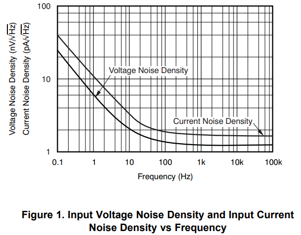

Yes, that is what it means. "How much more?" is not a trivial question to answer. It depends on how you define noise (unweighted, A-, C- or Z-weighted), and the source and feedback shunt resistances.
Let's compare the noise density at 100 Hz for each of these amps.
--------------Noise in nV/rtHz
OPA1611 --- 1.5
OPA1642 --- 5.8
OPA1656 --- 11.8
OPA2156 --- 12.0
Now for 10 kHz (the front page data sheet number)
OPA1611 --- 1.1
OPA1642 --- 5.1
OPA1656 --- 2.9
OPA2156 --- 4.0
For the OPA1611, you also have to consider current noise, because it's not a FET input like the others. If your Rin is 1Kohm, input noise rises to 4.5 nV/rtHz. It's now similar to the others at 10 kHz, but still wins at 100 Hz.

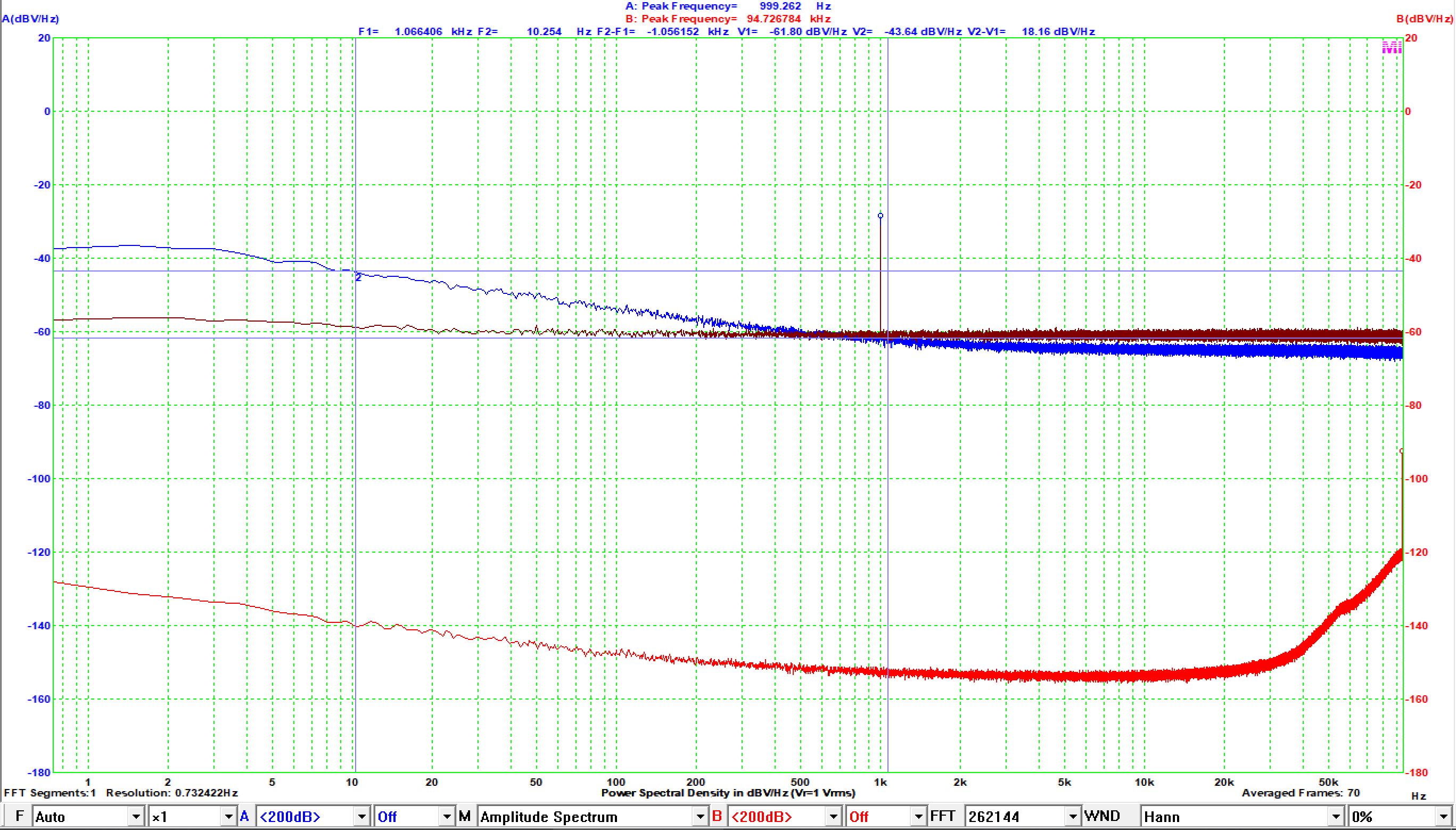

Yes. OPA1656 is a bit noisy at low frequencies.
Below is a comparison between OPA1656 and OPA1642. Two identical gain 11 amplifiers were tested. Every amp. consists of 2 x 10 op-amps in parallel and the two 10s are balance connected. The input is essentially shorted with 10mohm resistor in order to have a -140db control signal. Idea taken from Dicks site. The output of the 1656/1642 amplifiers is additionally amplified 90db. The measuring setup is calibrated in dbV and Virtins shows the noise spectrum - so no additional spectrum corrections are needed.
In this particular implementation 200nV/sqHz for OPA1656 and 40nV/rtHz for OPA1642
![1642vs1656.JPG 1642vs1656.JPG](https://www.diyaudio.com/community/data/attachments/838/838486-9556a74a2a6654be2127f0bd4176d83e.jpg)

Yes. I forgot to add the info. Red is the shorted input of the ADC.
Brown spectrum - OPA1642, Blue - OPA1656.
And 200nV/sqHz and 40nV/sqHz stated above are at 10Hz.
