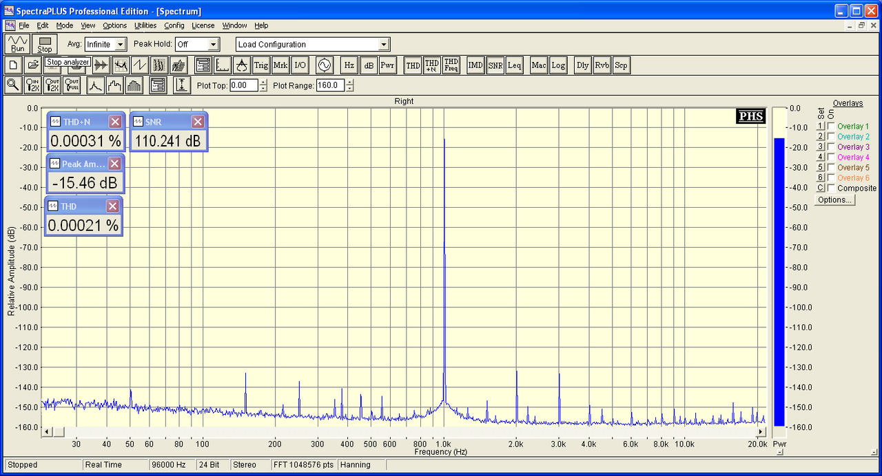

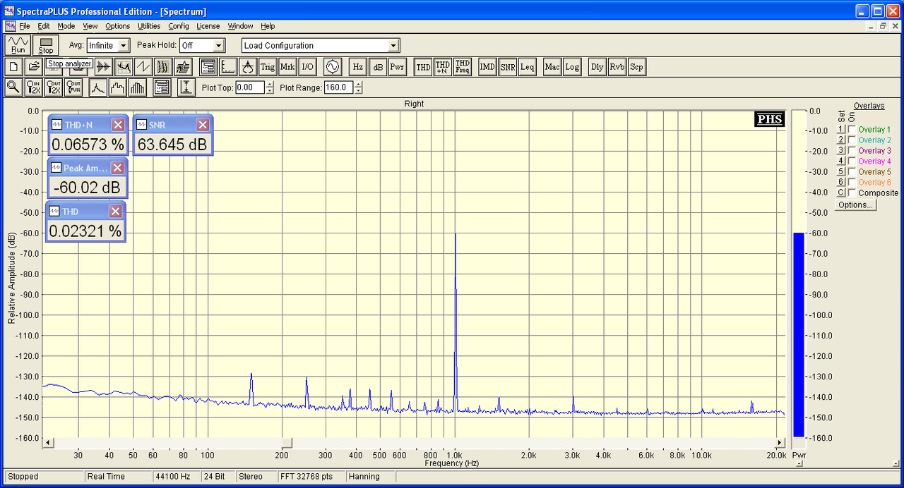

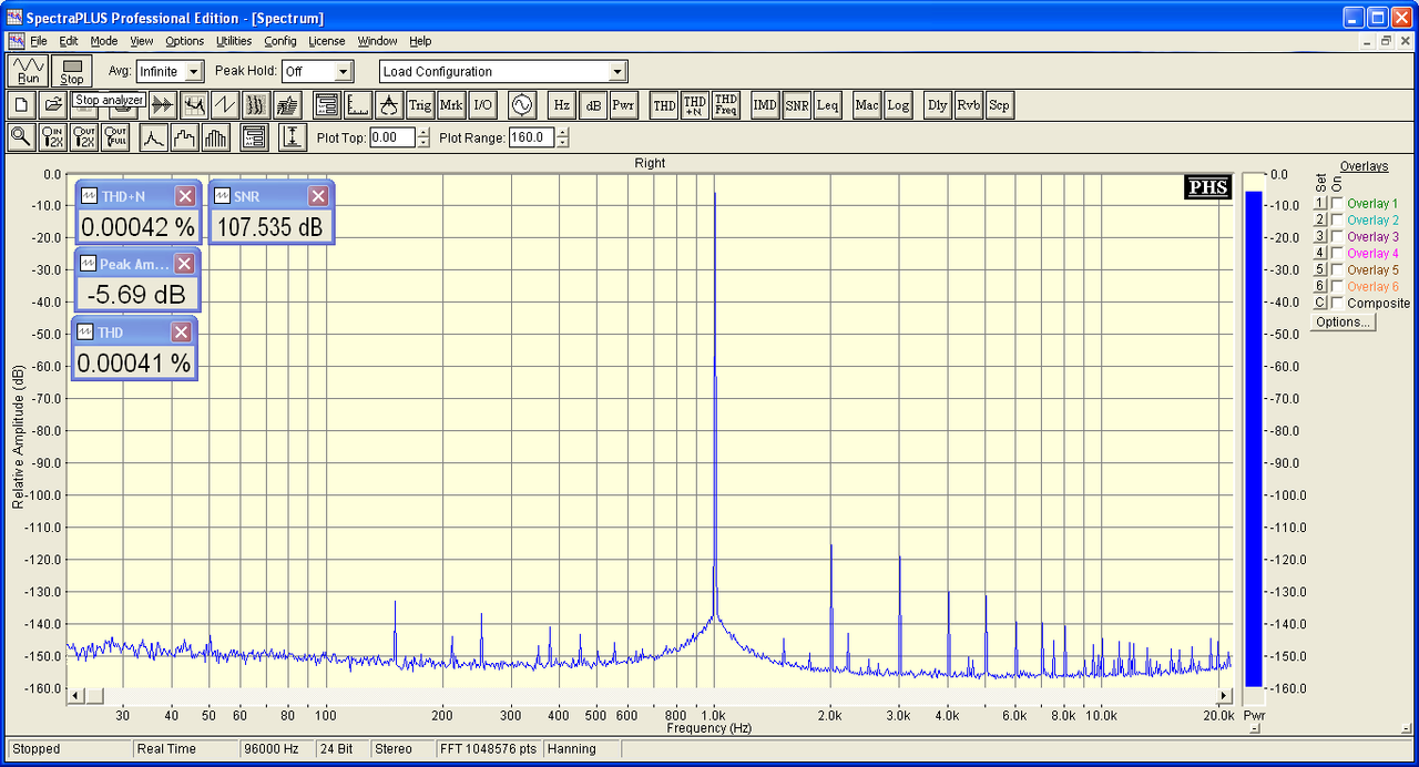

“I personally believe that THD should be as low as possible and dominated by the 2nd harmonic. Harmonics above the 4th should be below the noise floor. Noise should be a low number on a spec sheet and inaudible. Slew rate spec should be >10x what the signal requires. If you like a system that scores poorly on these metrics, then I am not designing for you.”
Getting harmonics above the 4th below the noise floor is no mean feat given measurement systems that are available today. The spot noise floor on a QA401 with the inputs shorted is -155 dBV, and with a typical low noise DUT connected you’re at -135 dBV. (these measurements were done with 2.94 Hz bin width and 50 averages).

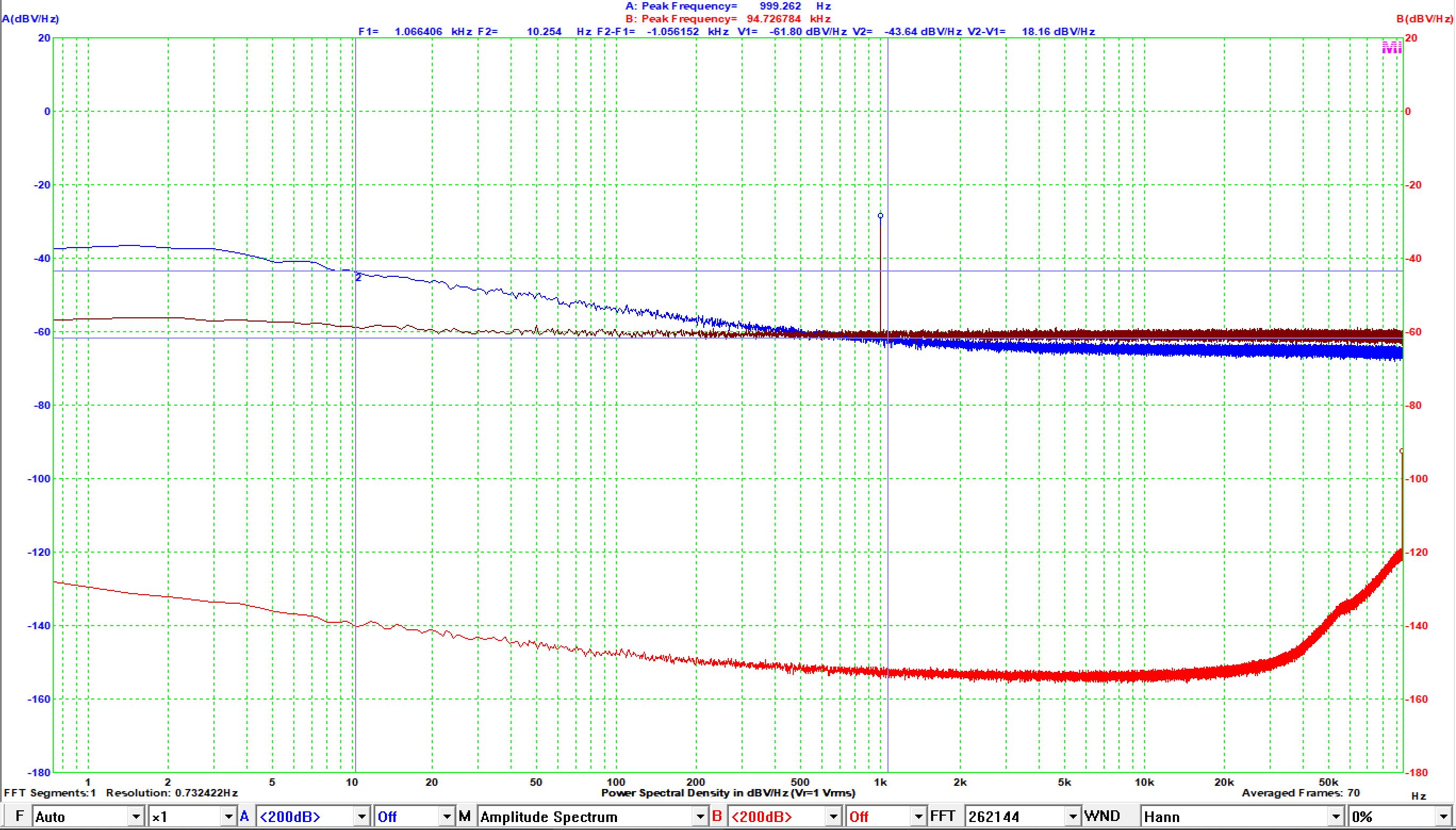

Yes. OPA1656 is a bit noisy at low frequencies.
Below is a comparison between OPA1656 and OPA1642. Two identical gain 11 amplifiers were tested. Every amp. consists of 2 x 10 op-amps in parallel and the two 10s are balance connected. The input is essentially shorted with 10mohm resistor in order to have a -140db control signal. Idea taken from Dicks site. The output of the 1656/1642 amplifiers is additionally amplified 90db. The measuring setup is calibrated in dbV and Virtins shows the noise spectrum - so no additional spectrum corrections are needed.
In this particular implementation 200nV/sqHz for OPA1656 and 40nV/rtHz for OPA1642

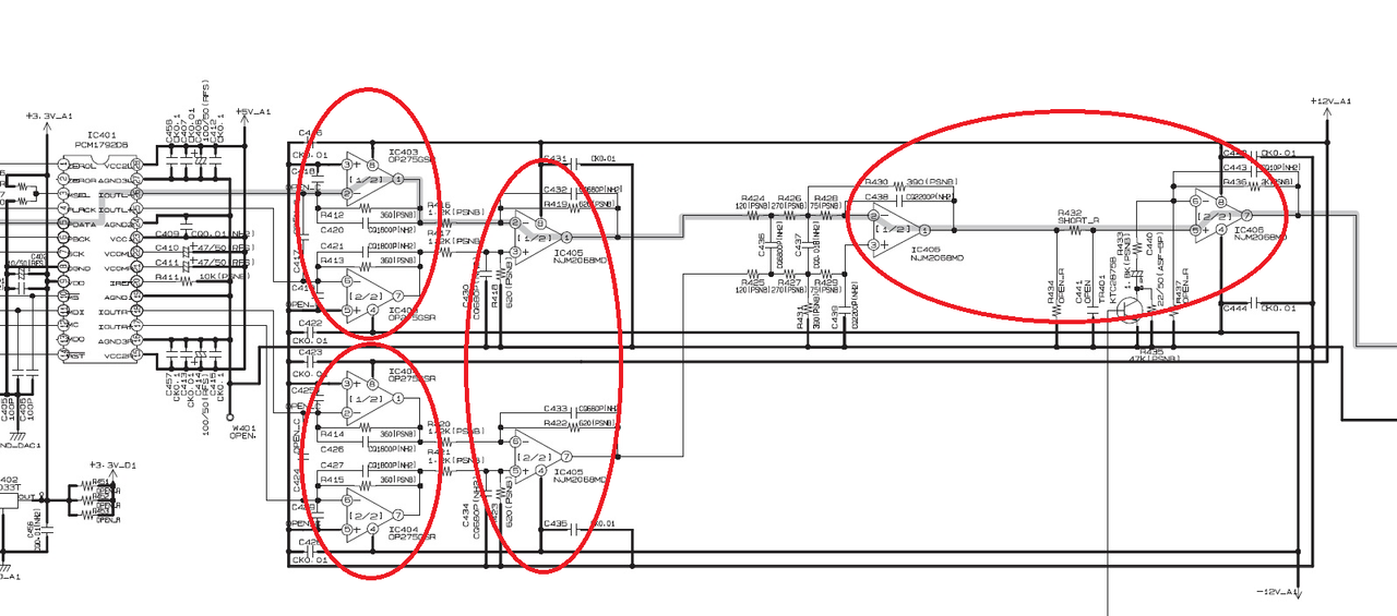

Interesting thread. I was probably the first to retrofit an EMU 1820m recording interface with LM4562 years ago and the SQ improvement was quite substantial. I still use that unit today.
I recently bought another 1820m since they are now obsolete, though the ADC/DAC chips are still quite good even by todays standards, and the units can be had for next to nothing. The one I just picked up is stock and is still packed with NJM2068M. So I was able to get a fresh reminder of just how much improved the one with 4562 in it actually sounds, lol.
That said, the biggest issue with the 4562 is quiescent current, which is typically about twice that (if not more) compared to most alternatives. Not too much a problem except for retrofit scenarios having 20-30 opamps...both the power supply and thermal budgets can get blown out in a hurry.
In my first retrofit of the 1820m I failed to recognize these facts, but fortunately it had enough margin for both counts to allow it to run hours a day all these years. But it does get quite warm to the touch.
All to say, the stock one I just picked up is getting filled with opa1656. Since I'm a musician first as opposed to audiophile, I have zero concern with 1656's higher noise floor at low frequencies, as its noise floor in the "money region" is actually lower than most if not all competitors. And the quiescent current per device is half that of the 4562 I used in the first one.
I'll post in a few weeks my subjective take on the results along with RMAA objective results... Wish me luck! And thanks for everyone sharing thoughts on 1656. It makes it much easier to commit to doing a 30 opamp retrofit with zero audition beforehand. I did that last one with zero audition ad it worked out splendidly hopefully this does too!

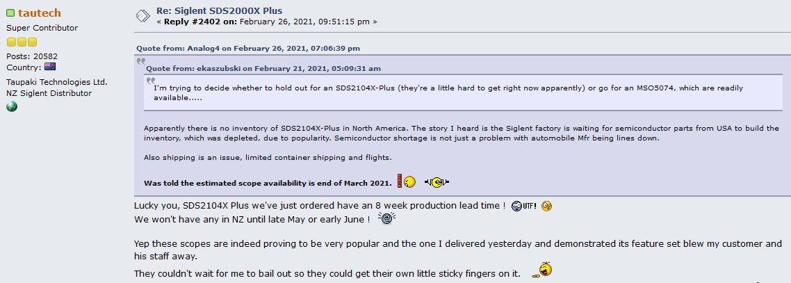

As production shifts across the Fabs, the scarcity of op amps may shift. Finding reliable availability may shift across op amp families. Keep in mind, there is currently an industry wide semiconductor shortage and customer volumes shift in unexpected ways.
Worldwide chip shortage expected to last into next year, and that’s good news for semiconductor stocks - MarketWatch
Global chip shortage to last till 2022, causing bump in semiconductor stock value
Porsche CEO warns of '''very serious''' global chip shortage
Siglent SDS2000X Plus - Page 97
