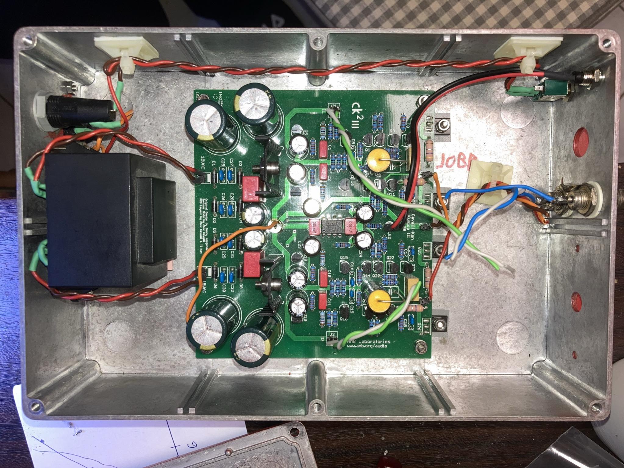

don't have a schematic, but looks there are plenty of caps installed onboard close to TO220 regulatorsBut we are talking about the CK2III headphone amp here with +/-15V rails.

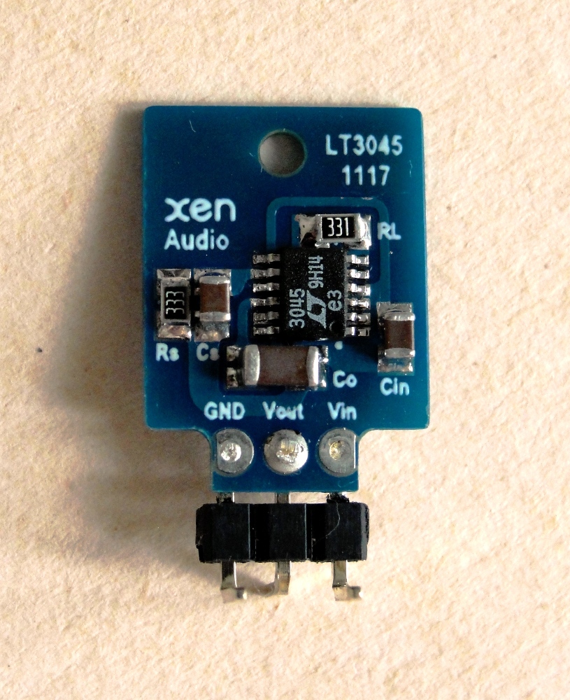

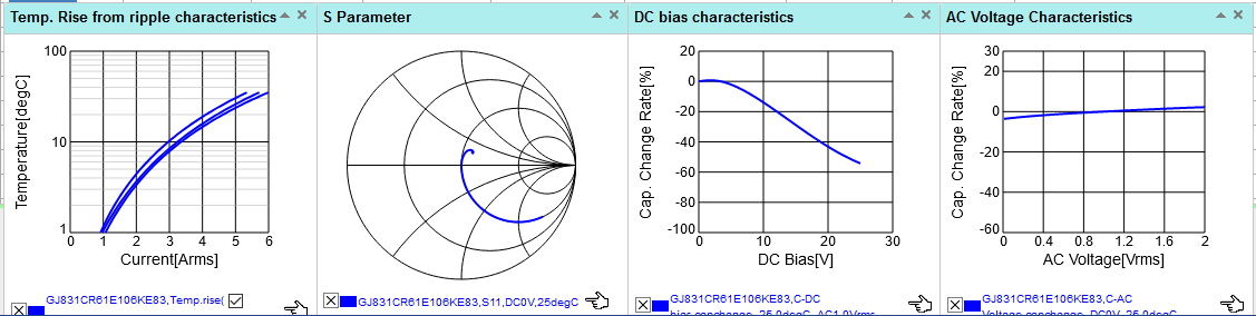

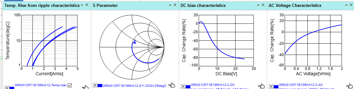

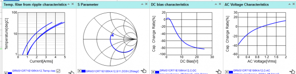

I have my own LT3045_78xx_TO220 boards, and I have both GRM & GJ8 caps.
So I know how they perform.
All credit to you to offer this product.
And it is all transparent as to what the buyer gets.
So they can make their own decision.
