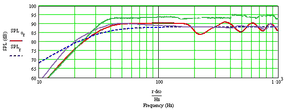

Here is a crude overlay of Fat Thor (red), Short Thor (purple) & Small Thor (green). (don't know why Small Thor is offset upwards 3 dB.
But these support Scott's contention that ShortThor is best. Then i'd say Small Thor -- it gives up a small amount of bass to Fat Thor but has way less ripple.

Short Thor port is fine Dave. You can increase the width somewhat to roll things off if bass gets too heavy, which is where I remember some of the confusion crept in a few months back -entierly my fault. Small Thor's response is too high because of an error I made when entering the data, but the curve shape and F3 don't change, so it's still useful. Many thanks for all you've put into this with drawings, overlaid graphs etc. Above and beyond that is, considering you've no interest in building a pair.
If I was all-out to build a Thor version (no, I'm not going to either, but don't let that stop you), and I had a cathedral, I'd build Fat Thor. If I had a big house, Short Thor. A 'normal' sized house, Small Thor.
