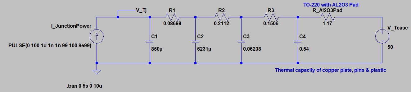

Some more words about power handling of MosFets and resulting junction temperature. The max. allowed power dissipation in the data sheet is valid only if we keep the casing of the MosFet at 25C, which we simply never can achieve in reality.
Furtheron in my experience the thermal resistances between case and heat sink are often higher than anticipated.
For a TO-220 I measured the following resistances from case to heat sink depending on the way you mount it.
TO-220 directly mount on heat sink with thermal grease: 0.26 K/W
TO-220 mount with glimmer pad and thermal grease: 0.96 K/W
TO-220 mount with AL2O3 pad and thermal grease: 1.17 K/W
TO-220 mount with silicone pad: 3.5 K/W
TO-220 mount with thermal grease and undefined ceramic pad from professional electronics shop in Guangzhou : 4.7K/W
The example with IRFB4227 was with a DC output load of -20A DC and a fs=280kHz.
Similar like I showed the turn on losses one has to examine the turn off losses and
of course we should not forget the conductive losses. In total the ITFB4227 has to handle a power dissipation of approx 100W in the shown example.

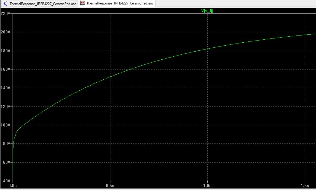

Attached the dynamic thermal modelling from junction to heat sink.
I anticipated that the heat sink would be at 50C and large enough that its change of temperature within 2s is neglectible when 100W are applied.
Translation from thermal circuit into equivalent electrical circuit:
Thermal capacity, J/K ==> Electrical capacitance F
Thermal resistance, K/W ==> Electrical resistance V/A = Ohms
Thermal power, W ==> Corresponds to current, A. (Ref. K/W corresponds with V/A)
Temperature, K ==> Corresponds to voltage, V. (Ref. K/W corresponds with V/A)
Values in the equivalent circuit are derived from data sheet + measurement of thermal resistance from case to heat sink and calculation of thermal capacitance of TO-220 geometrie and materials.
In less than 1s the junction reaches 175C, which is fitting perfectly to all other observations.
