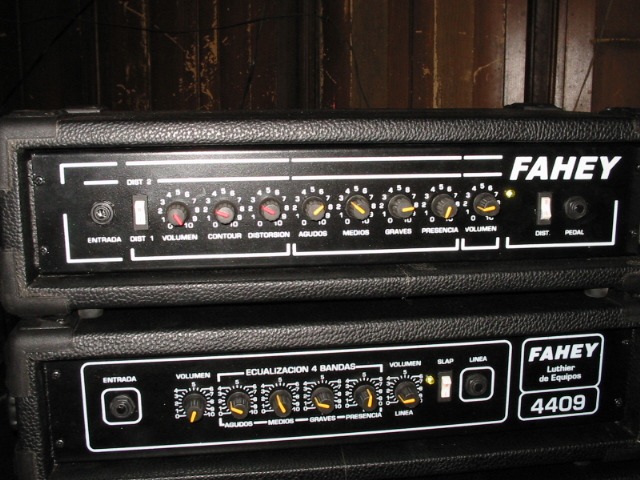

My Bass cabinets also include Tweeters, and are much loved by slappers and Fusion style Bass players.
My Bass heads even include a "Slap" switch, which creates and brings out all kinds of harmonics.
Here, the bottom one:
